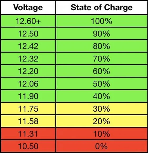

They put a AGM in my hyrbid 2 weeks ago and I checked with Forscan it’s at 80, should I change to 100
100 not a valid figure in Ford's SOC scale - which is not the normal table.
That 80 is when it goes to float charge, out of 85% fully charged.
That's about 94% full charge mathed out.
Not an incorrect goal.
If sensors are reading values wrong, which the SOC is mathed out from - then they are on the low side, the undercharged side.
If that's the case - 84% wouldn't be bad figure.
After a long drive, open the battery area and confirm no battery smell.

I’m not gonna touch anything then - everything has been working since the AGM went in
