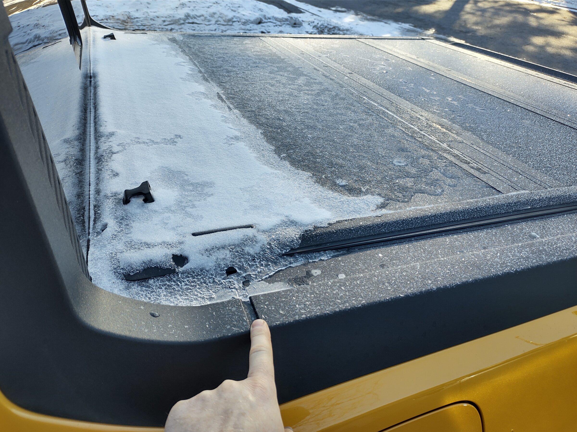

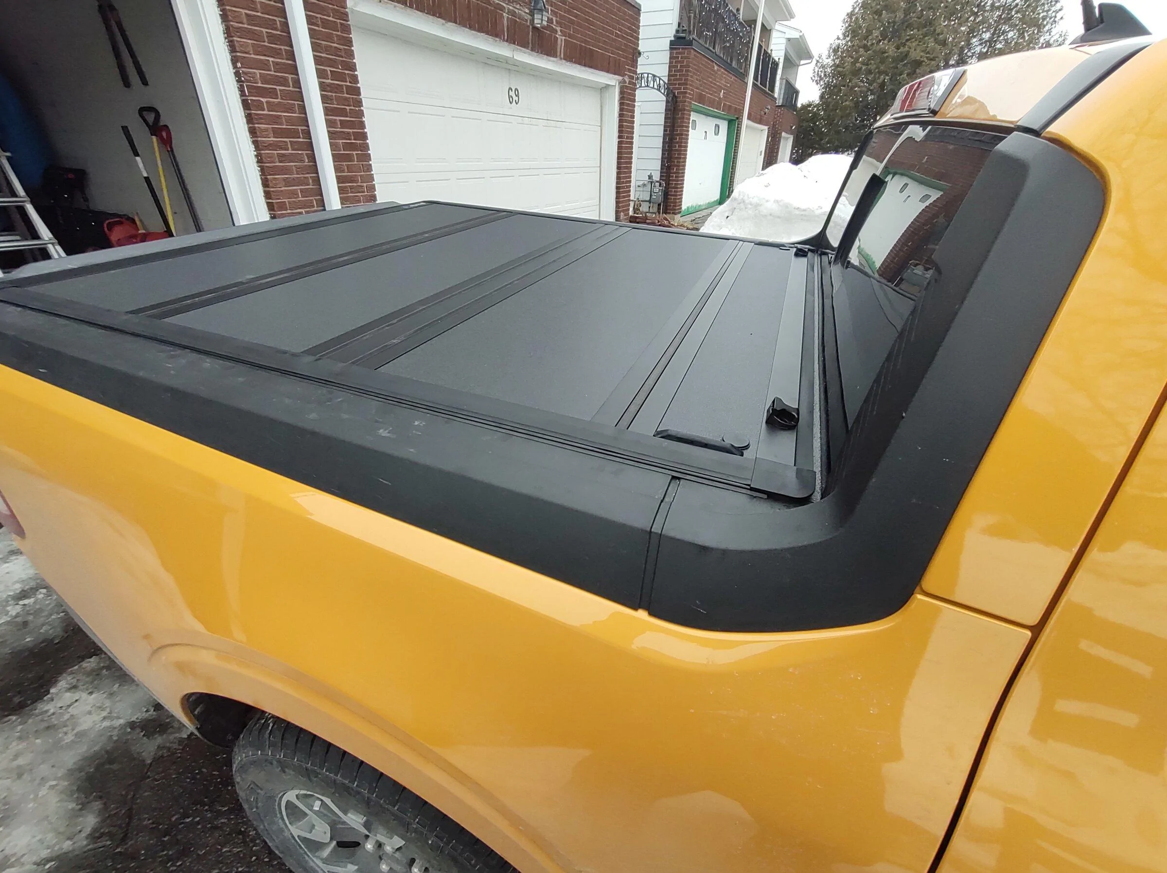

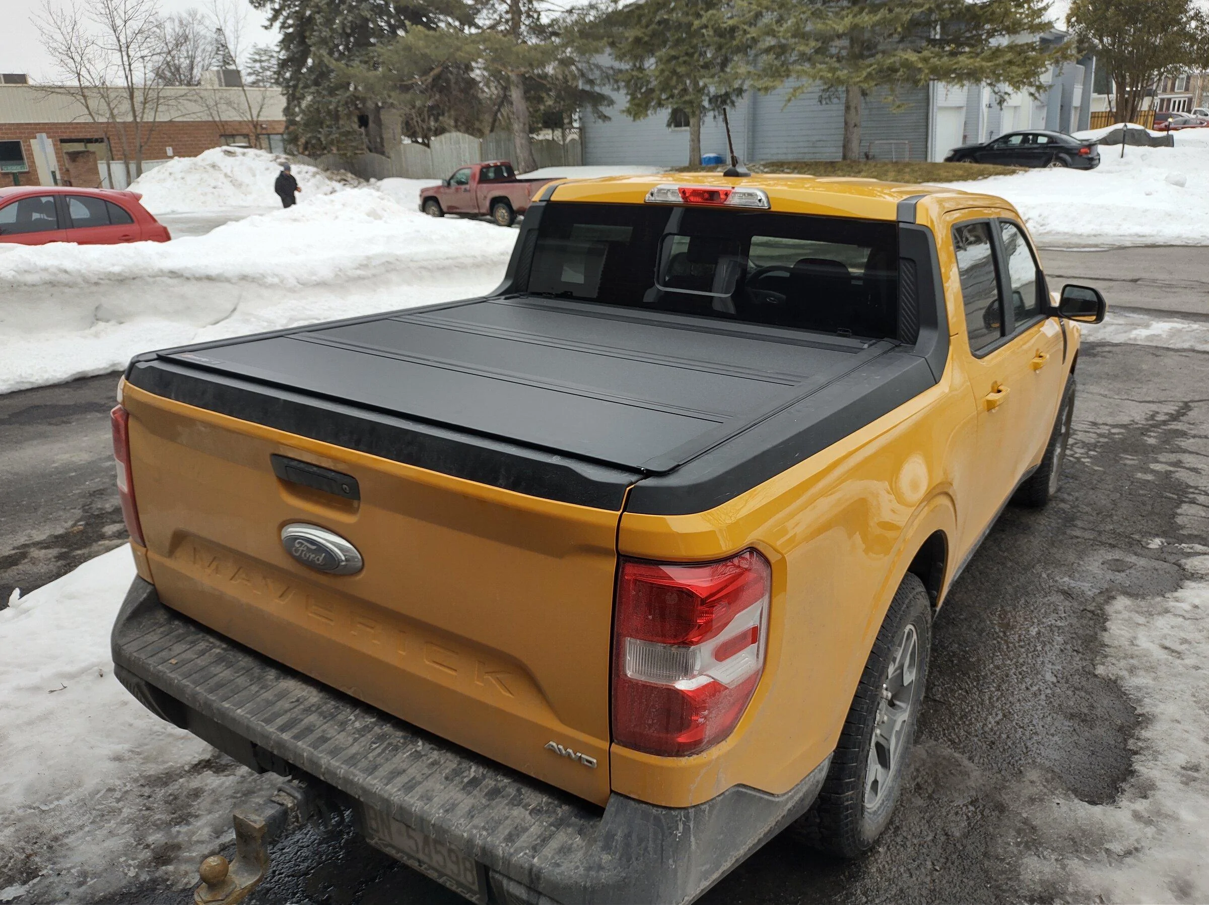

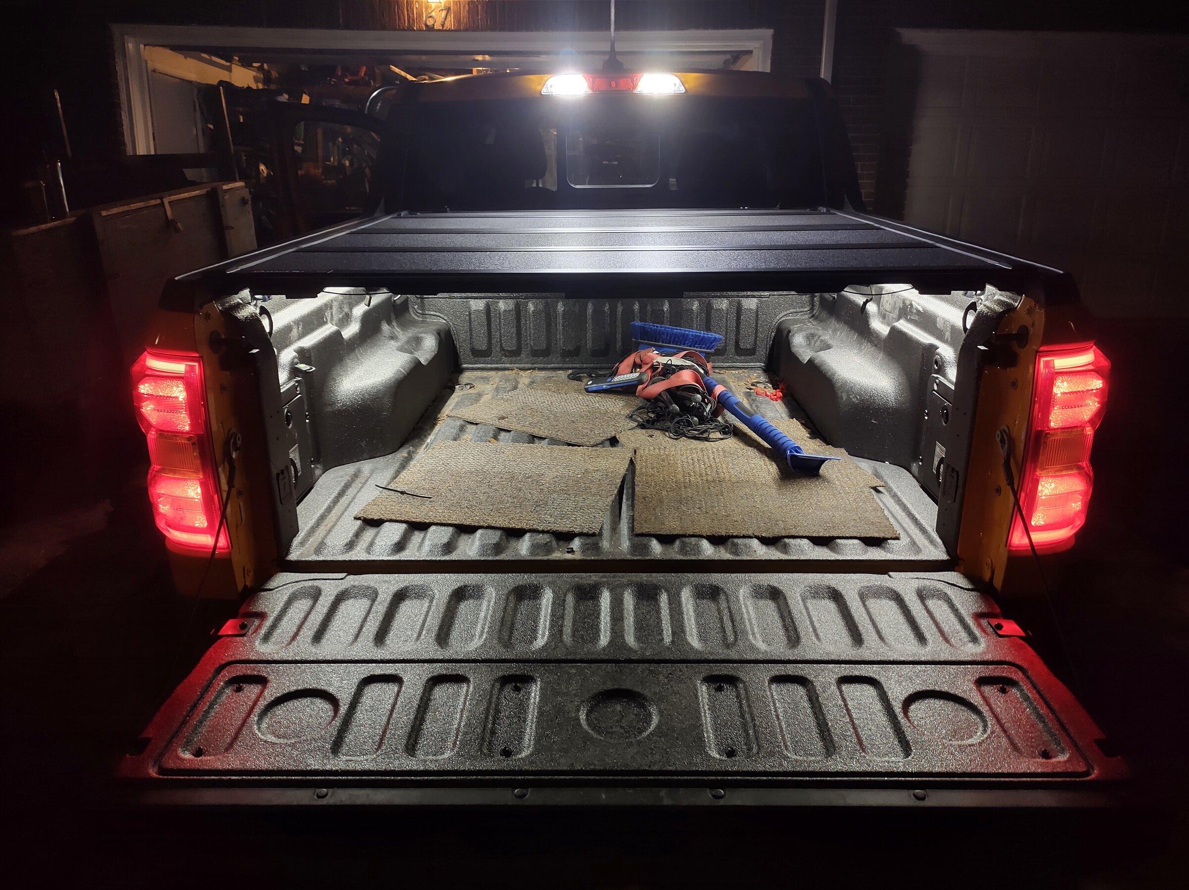

I have it. I like it. Easy to install. For a total seal you will need to put gasket material in the corners (see photo).
Get some clear silicone and put in between bulkhead and gasket seal (especially if bed has been line-xed).
To make sure you get a good tailgate seal, at night get a flashlight turn on, put in bed and see of you see light coming through. If you do loosen tightening knobs that hold the cover to the bed rails and shift forward till you see no light.
You will need some led lighting in the bed (very dark.

Can you show how much of the 3rd brake light is covered when the cover is completely folded up against the cab? I'm curious if it will still provided bed lighting, especially if they are swapped out with LEDs. Thanks.
Edit: Nevermind. I saw you posted what I was looking for in another thread. I see it sits just below the light. Does the light still illuminate the bed somewhat?
