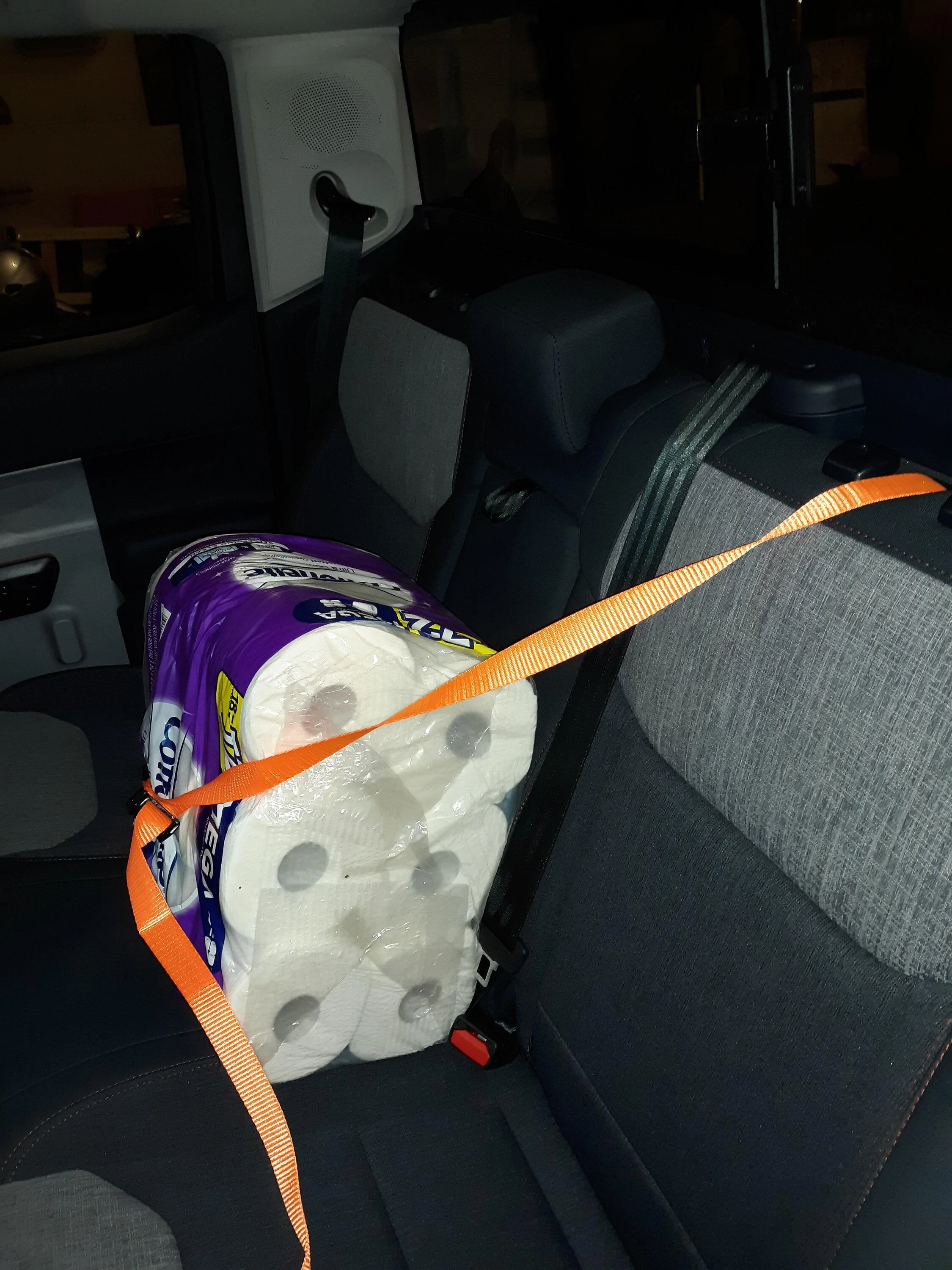

I'm used to having a Tundra pick up and the associated floor room in the back seat. Came up with an idea to keep cargo that you don't want moving around in the back seat.
Disclaimer: intended for non living cargo a d use at your own risk.

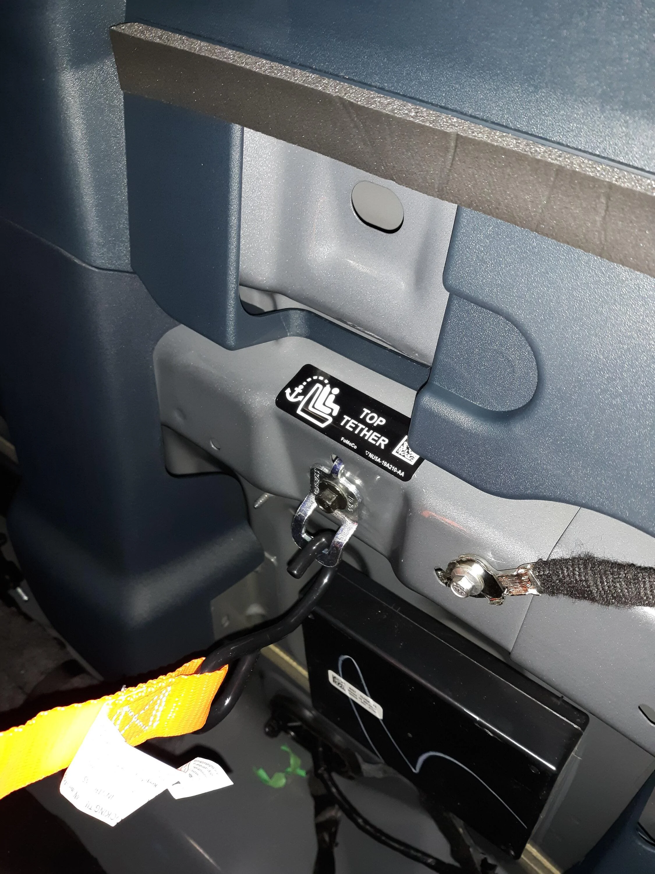

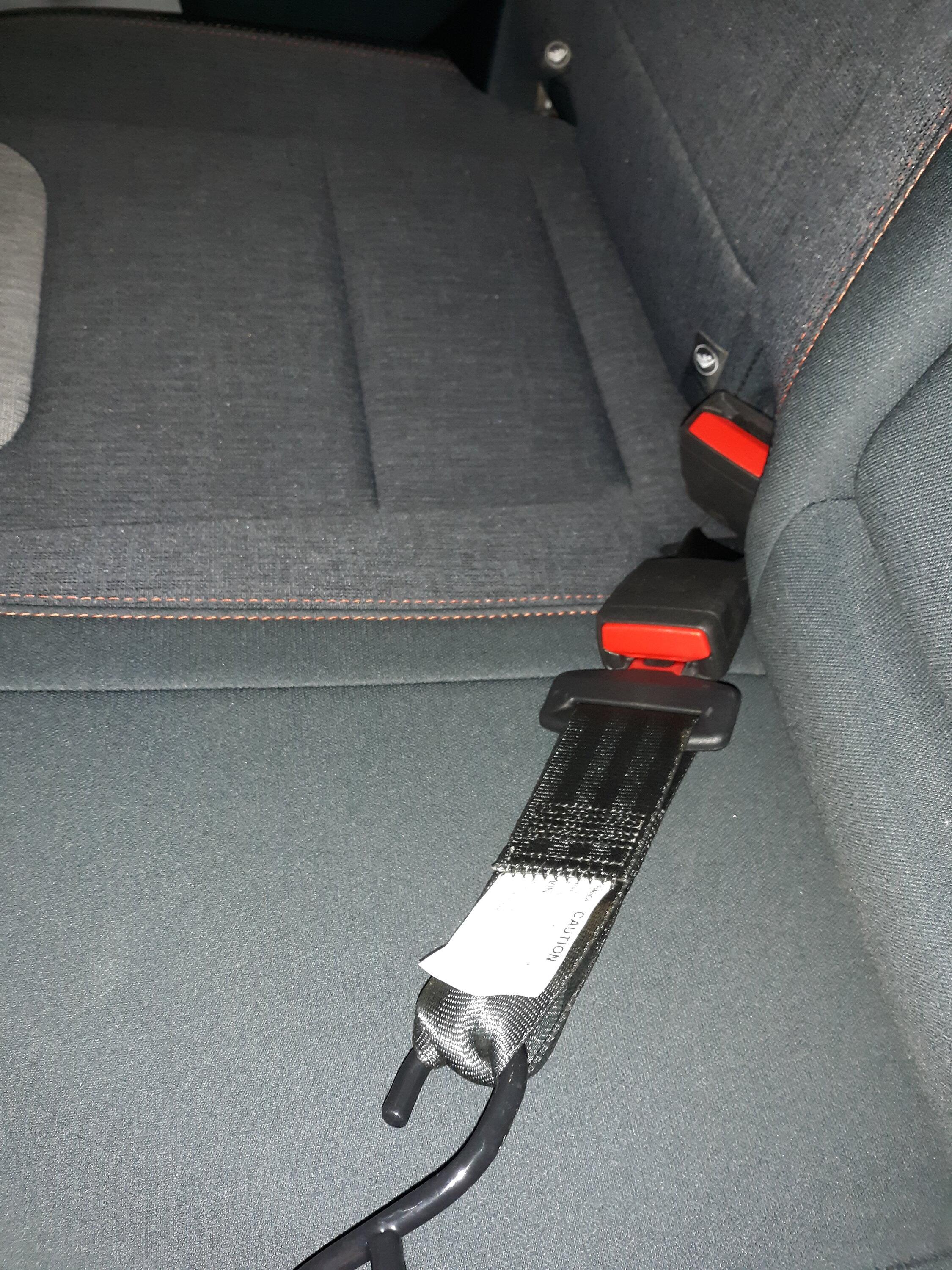

Bought seat belt extenders and cut off the female end. Provides the loop for a tie down to through. The other end goes into the child seat loop behind the seat.
A pull type strap should hold everything I need it to. Seat belt extender part number is in one of the photos. Afraid a ratchet type may put more force in places it shouldnt.
