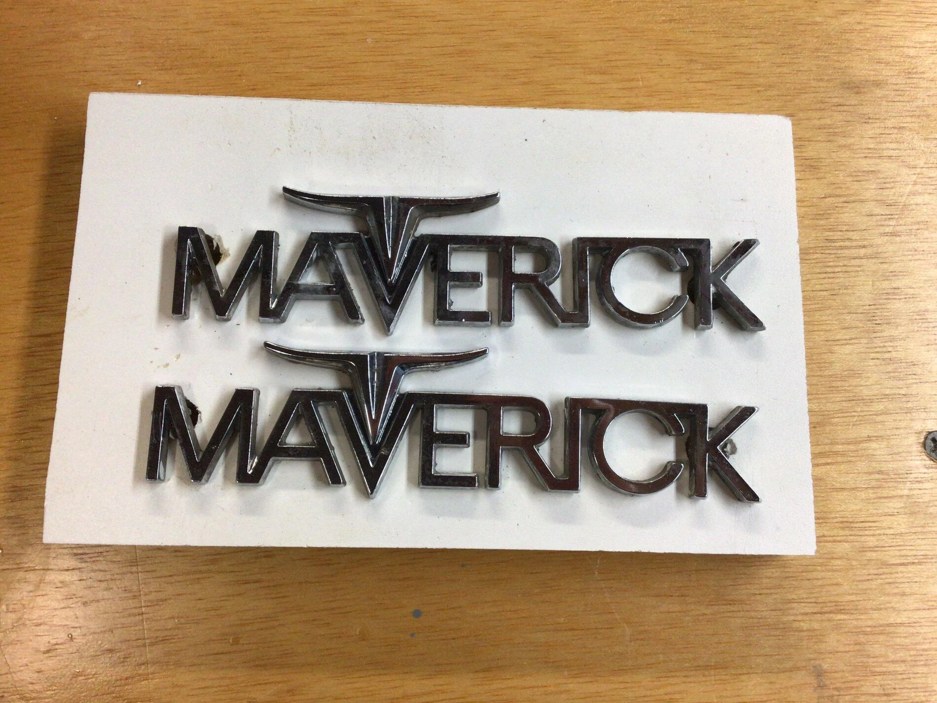

Attaching Maverick badging - glue / tape?

3M double-sided tape holds on small spoilers and other body panels on many vehicles. It’ll do fine for badging… just make sure it is 3M, don’t skimp on knockoff brands, and don’t trust what comes pre-installed on non OEM badges, especially if you order from eBay or Amazon.

How well will the 3m tape hold up to the New England weather?
It is the 3m body and molding tape. It is the same tape used by Ford and other manufacturers.
It is available in different sizes. Here is a random size on the Jungle website.
3M Super-Strength Molding Tape, 03614, 1/2 in x 15 ft, 1 Roll https://a.co/d/hQzaTjy
