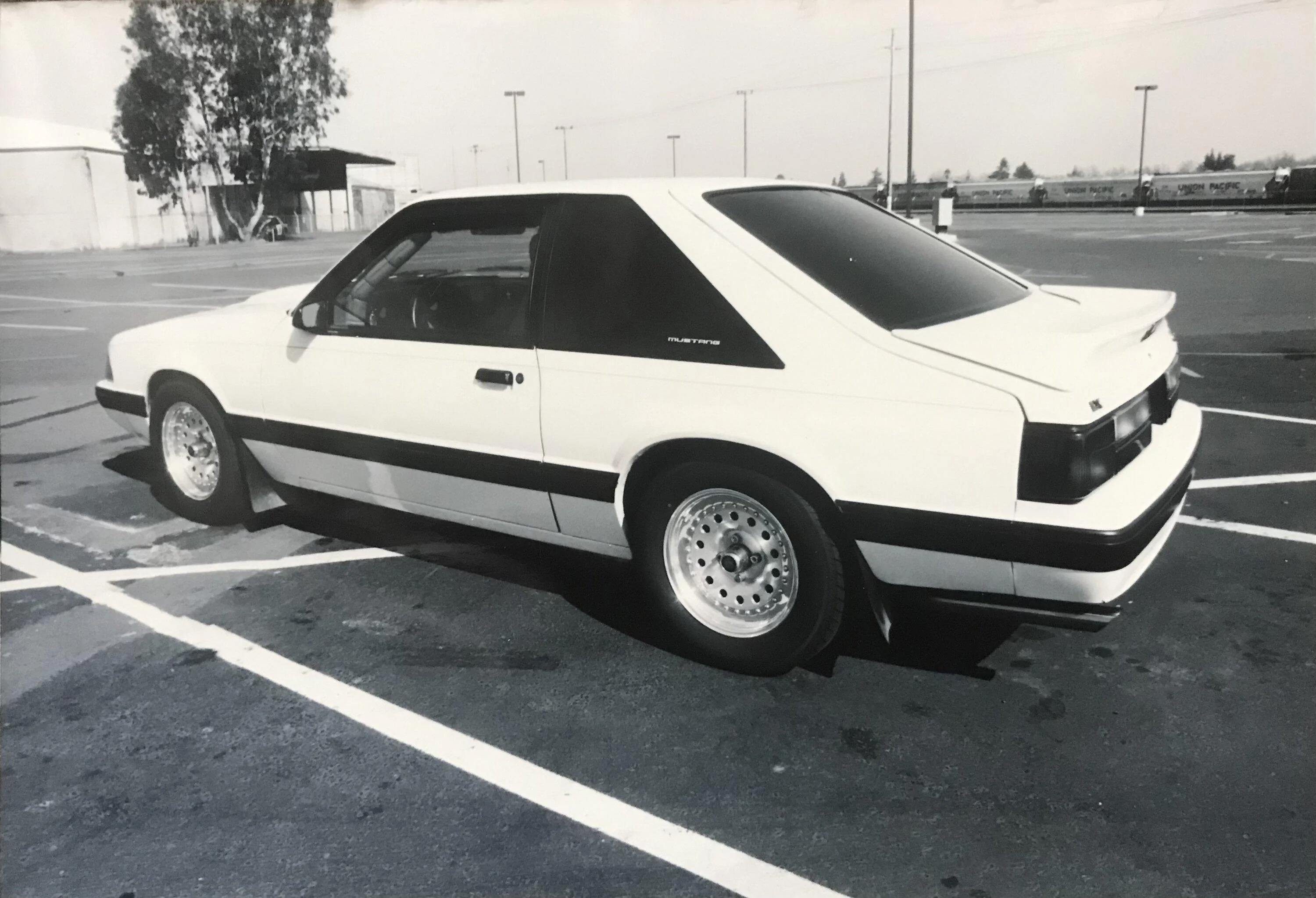

Doesn’t answer your question, but when I had my ‘89 Mustang 5.0L LX, I replaced the 20++ lb factory 10-hole 15” rims with these super lightweight Centerline Pro Stock wheels which weighed either 11 or 13 lbs (can’t recall exactly, but it was one of those two)!
Ford Maverick Are Factory Ford Lightweight Wheels Available? A90C6766-4140-4DC8-8F3E-06FBDB0EFD9A
Ford Maverick Are Factory Ford Lightweight Wheels Available? ADE01FA2-3411-4457-BD44-FC5B56E50A7D

Centerline seemed to make a quality product back in those days, but they don't crash test their wheels. I have seen too many aftermarket wheels at the junkyard torn to shreds. Wheels are a safety item, and should be subjected to crash testing
