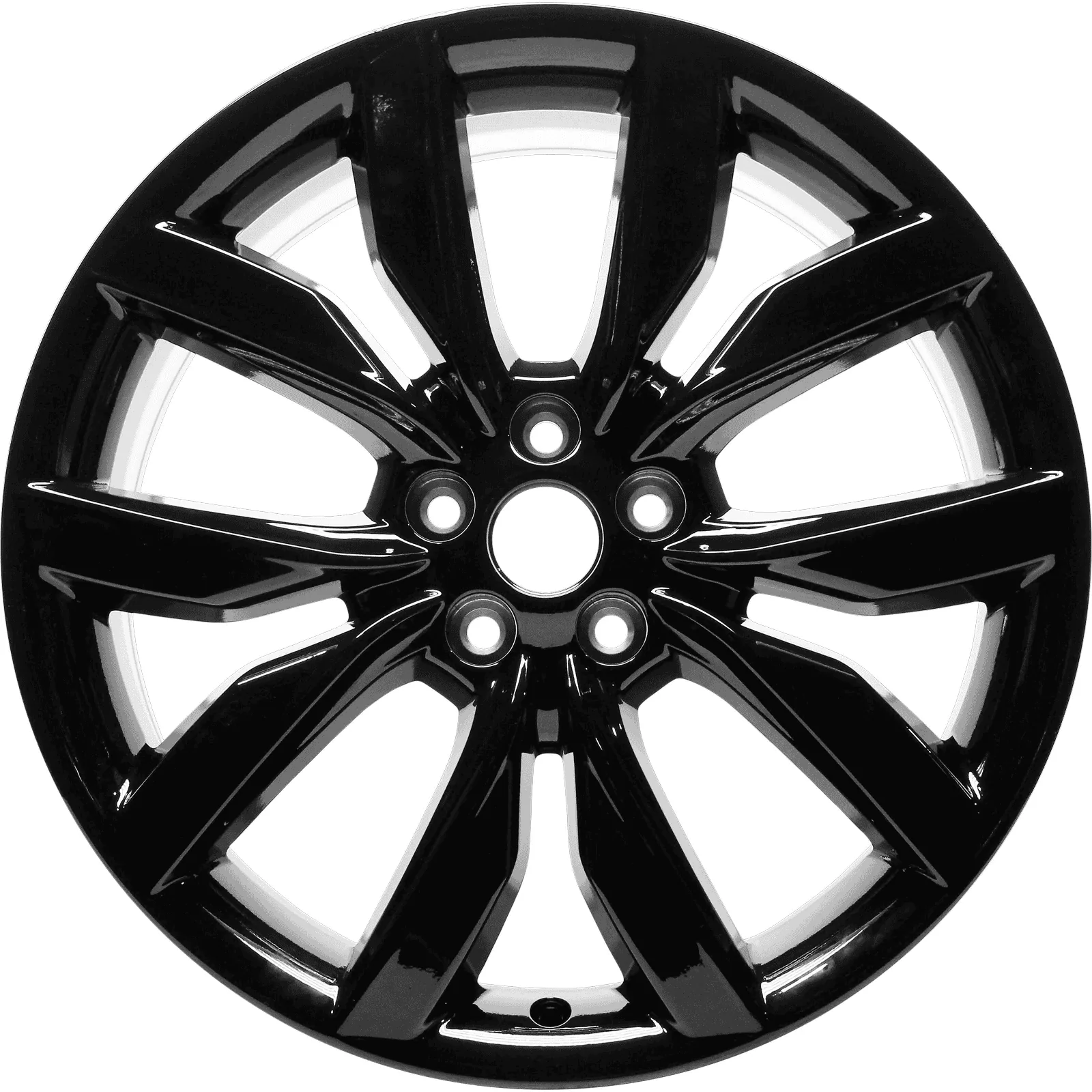

Very nice wheel!!
Specs match .
The offset is a little high.

I thought our trucks were made for 17" and 18" rims to work comfortably? 19" plus the tire will require some wheel well modification.
As long as he changes the aspect ratio, the overall OD will remain the same. A 225/55R19 is nearly identical OD-wise as the OEM 225/65R17.

Those are sweet wheels. On my daughters escape eco night package.

Nice looking wheel, price seems kind of high for OEM wheels. For that kind of money you could get a nice set of aftermarket wheels
Yep, I wouldn't be paying that. I found a used set of OEM take-offs with tires.
