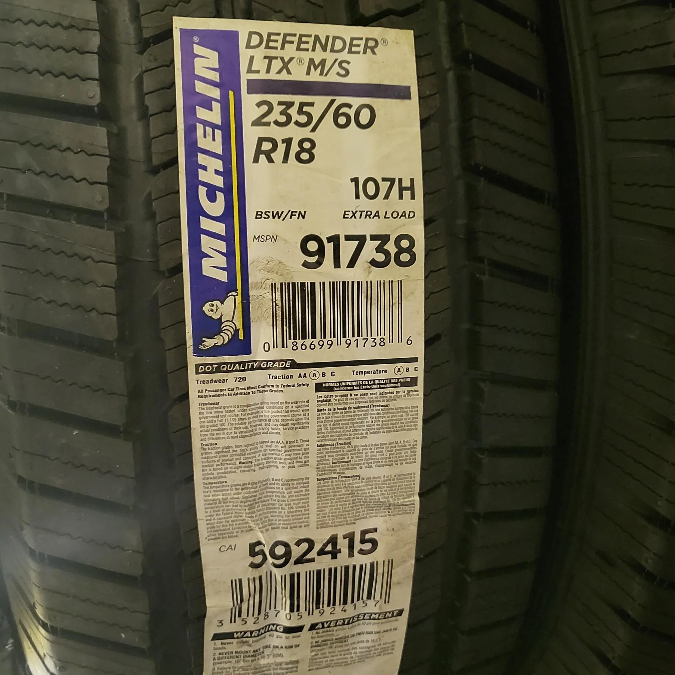

When my Hybrid shows up, I will go with this set up.

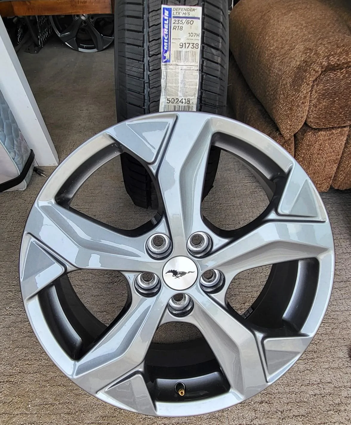

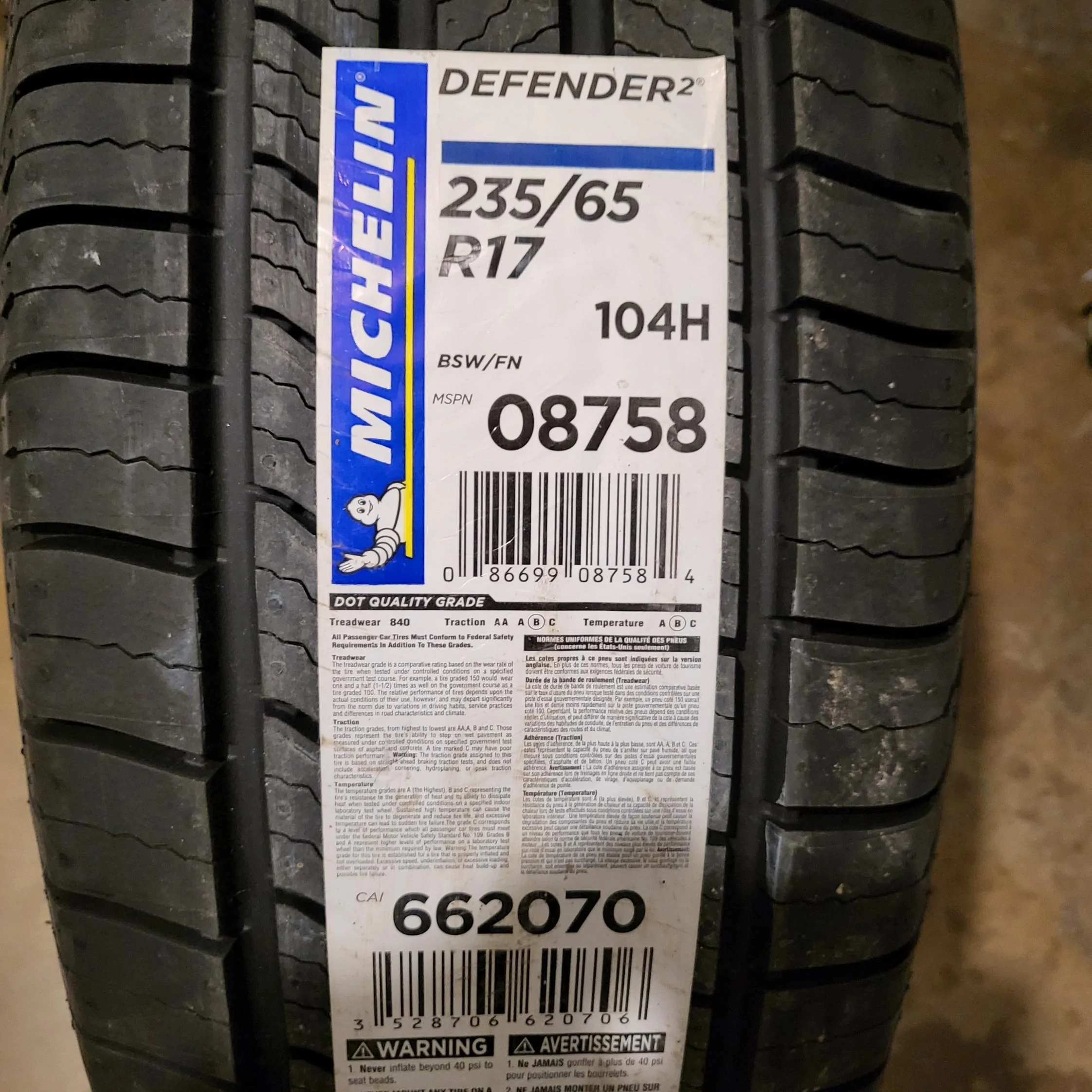

FYI --- That tire on discount tire site shows to be discontinued and weighs 7lbs more than the 225/60/R18 primacy on hybrid lariat OEM.
I understand that. The Defender 2 has replaced that tire. I got this tire set from a friend for less than half of retail cost. It is a little heavier as it is classified as extra load tire with thicker sidewalls. I also have a set of Defender 2 (235/65/17) in the photo below, which will replace the stock Continental. I have compared them both side by side. I will take the hit on MPG because this tire is far superior to the stock tires (continental or Michelin Primacy). I have had this tire on several different vehicles and know how outstanding it is. It is a shame that Michelin discontinued the Defender LTX M/S.
