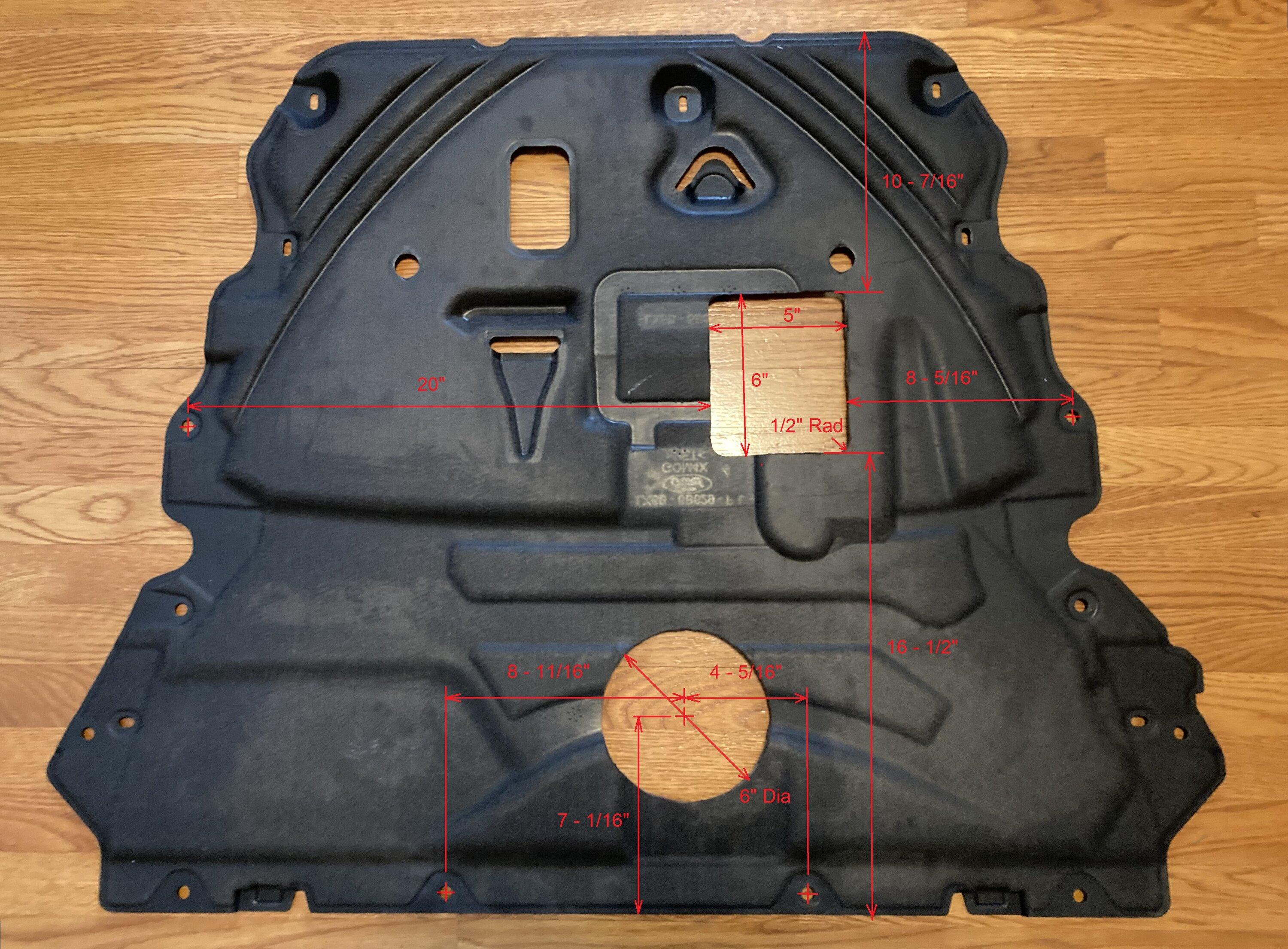

this is something that I copied from an old thread too! Where to cut holes to access the oil filter, drain plug, and such.

Yeah, I saw that, and I'm handy enough to do it, but lazy enough to not want to, 😆.
This is fairly straightforward molding, I'm still kinda surprised no one's jumped on producing them - even Ford. Can't think of many Mav owners who WOULDN'T want one, so long as it was reasonably priced.
