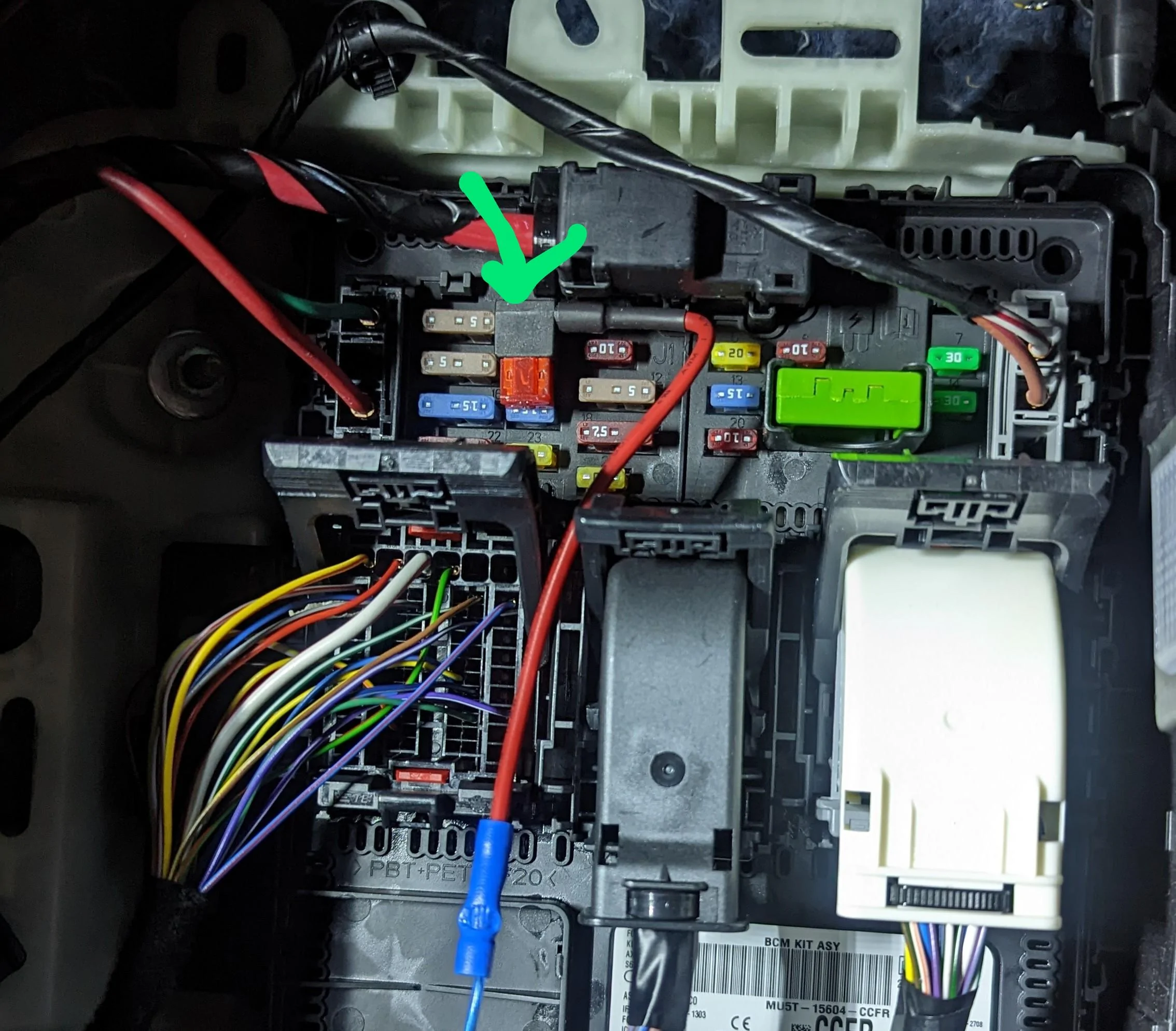

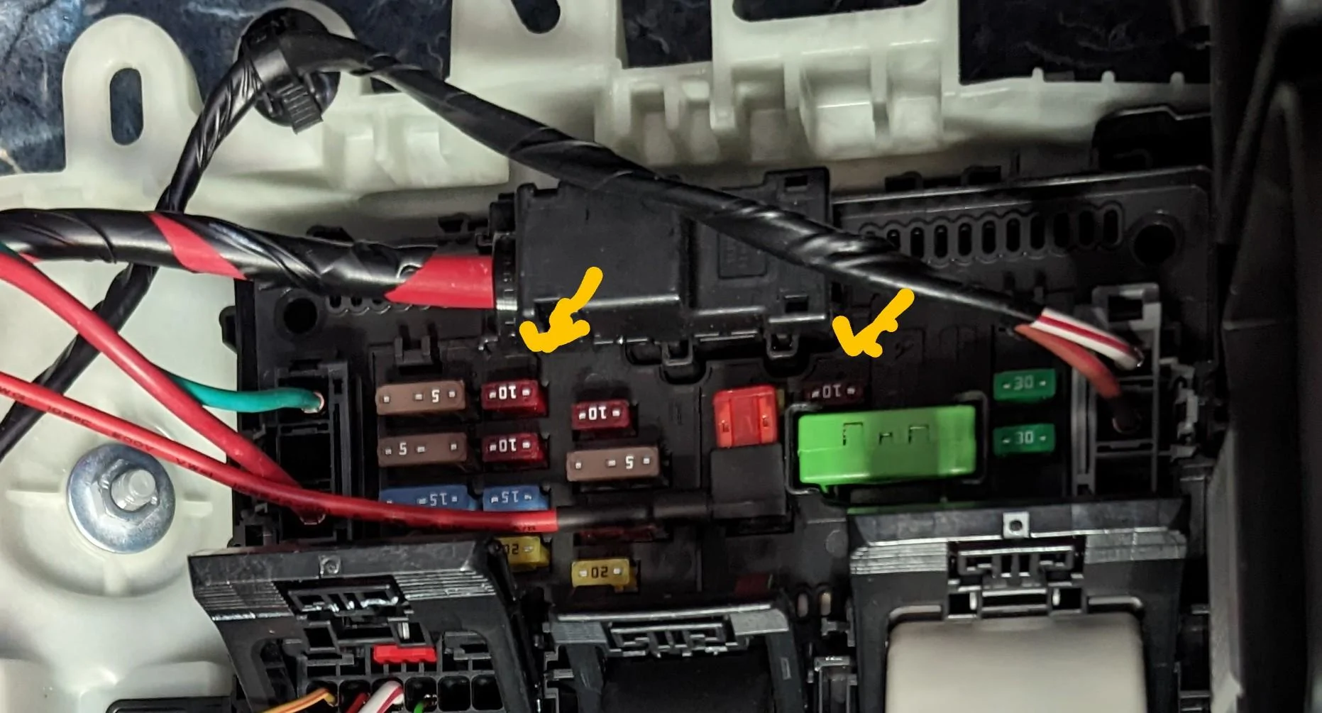

There's two large relays in the way for me to use #6 but, yes, #3 works great. My add on fuse has a 90 degree angle.
Before and after pics. I tried to rotate the images to match the orientation of the fuse panel drawing in the manual. (Which is not facing up. The top of the diagram in the manual is on the left of the panel as you face it.)
I'll monitor it overnight and tomorrow to see if the truck goes into deep sleep.

I'm still learning from your (and everyone else's) journey in upgrading the sound system. How has the deep sleep been since the last update?
It went into deep sleep once, around 4AM Friday (yesterday). The rest of the time nothing, versus literally every time I shut off the truck. I'd say it's fixed but the battery might still be a bit weak. We will see...
