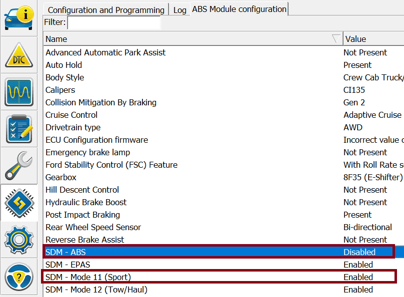

I am not near you,. but I added it to mine. It was pretty easy. You have to change 2 values:
  • SDM - ABS change from enabled to disabled
  • SDM - Sport change from disabled to enabled
When I first added it, I missed changing the ABS one so the modes were there but I got messages they were not available. Once I changed the ABS value, they worked.

Here's the two settings (under the ABS Module):
Ford Maverick Adding sport mode to Tremor with ForScan? 1693613506015
After changing the two settings in red above, be sure to click the Write button at the bottom and close the service procedure, then turn the Mav off and back on again.
