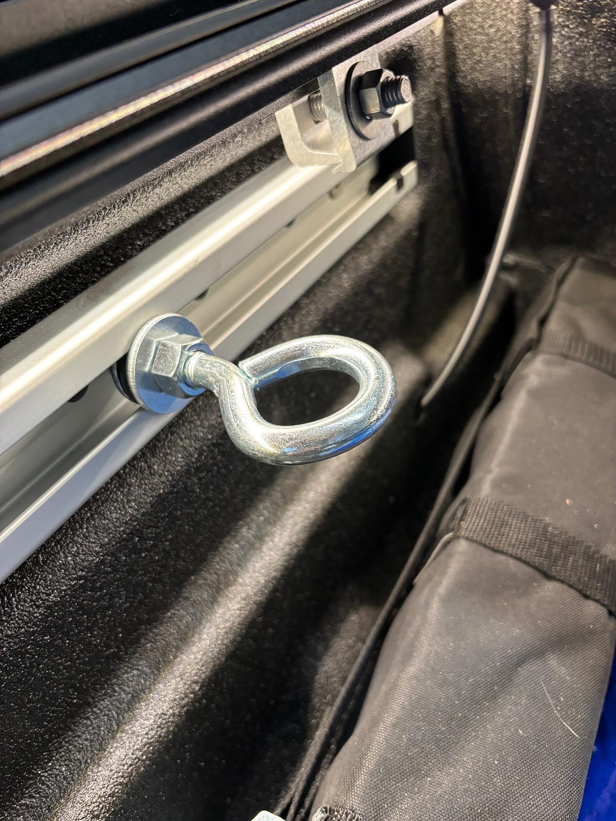

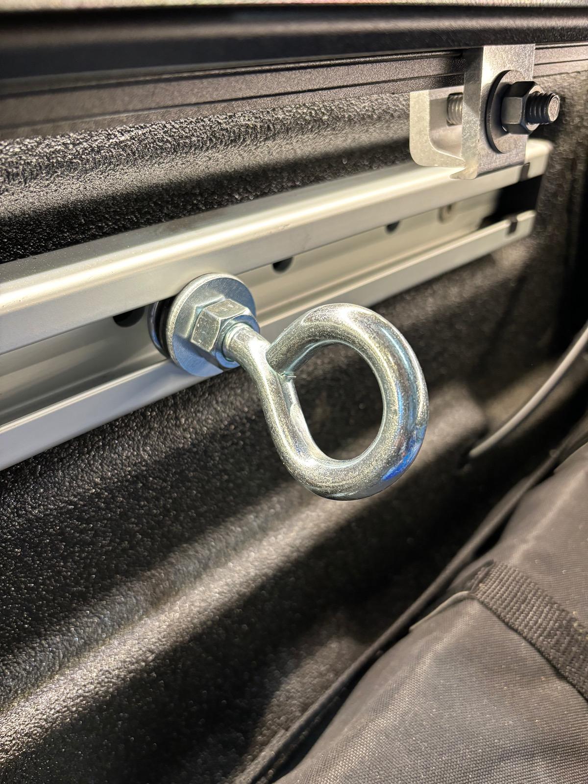

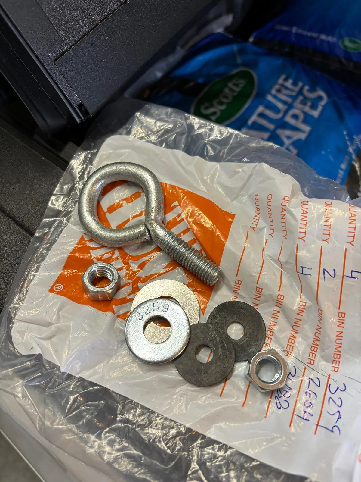

I needed an another options over the two cleats Ford provided. I decided to add a couple eyebolts using some basic hardware from Depot.
I added them to the bar by sliding them in however you can also fit the washer in on an angle before tightening it.
What do you think? I’m considering add a hook or two for bags.

Works for you …then ok. I rather a larger flat plate with hole in lieu of washer at the inside track. More surface area = stronger. And to really dress it up - stainless steel materials.

I like that idea a lot. I’m going to look out for a plate or something similar.

I would consider a centering washer in the middle of the sandwich. Even if it is just a nylon washer that you cut down. It will keep the eye bolt centered, which will reduce wobble, which will reduce loosening. Also a lock washer on either side would be beneficial. Probably one of the multi-toothed flatter types for thread space reasons.

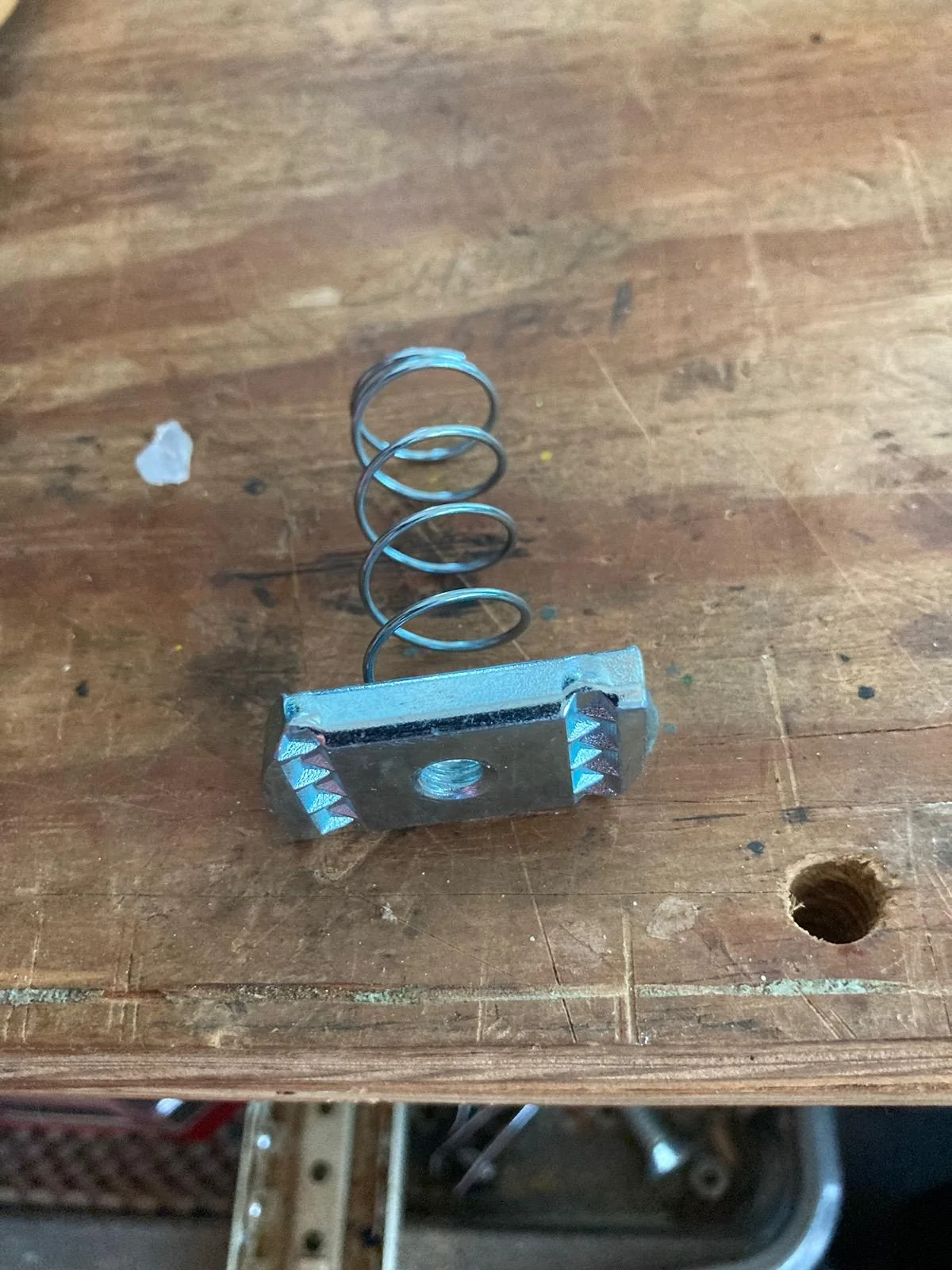

I added these inside the the track. Available in electrical section at major hardware stores, usually around the conduit area. Available in 1/4,5/16 or 3/8.

Nice, I’m going look for these this week

Usually in pack of 5. I shortened the spring a few coils as the rail is less deep then the “Kindorf” track these are made for. There are also brackets for attaching pipe.
