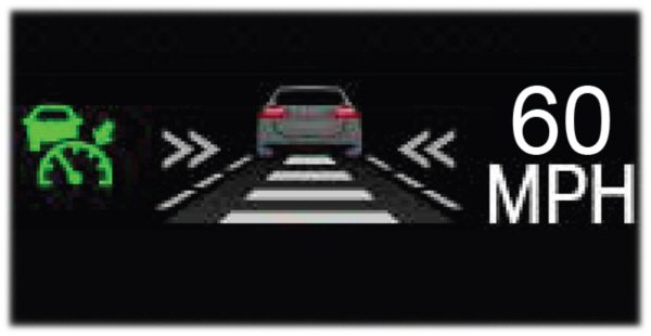

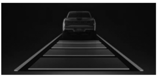

The indicator, current gap setting and set speed appear in the instrument cluster display.
Ford Maverick adaptive cruse adjustments 2026 ford maverick imagen2
A vehicle image illuminates if there is a vehicle detected in front of you.
