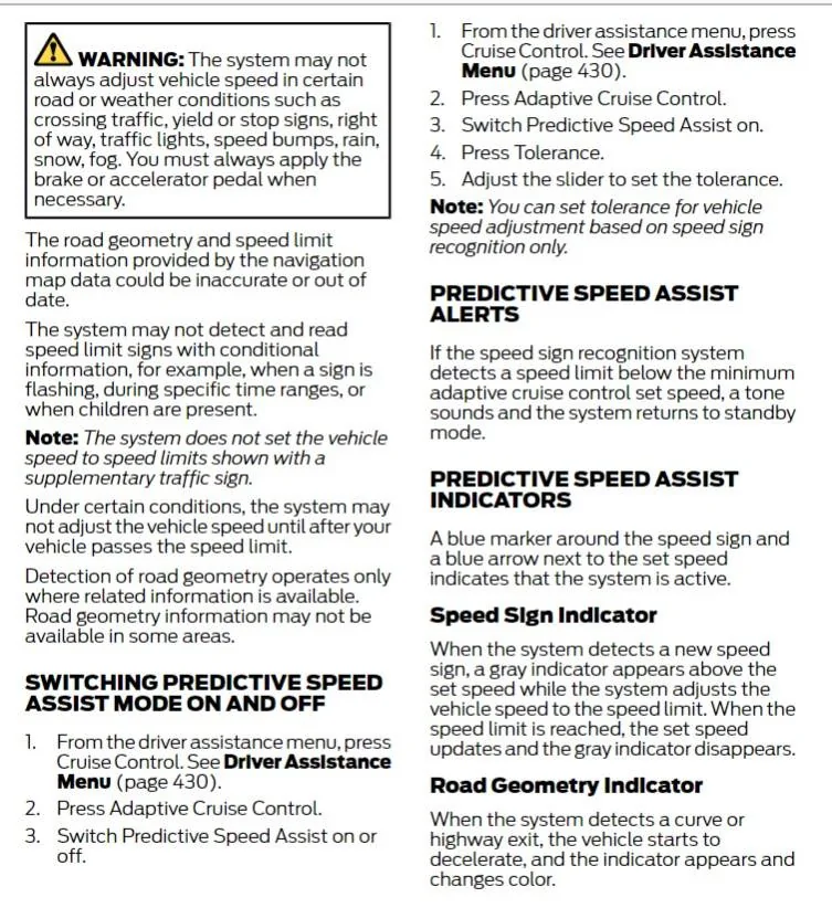

Why not just turn off the Predictive Speed Assist feature when towing, and manually set the ACC to 60 yourself? You can still have ACC without the Predictive (TSR) recognition.

Ford Maverick Adaptive Cruise Control Max Speed? Screenshot 2025-04-15 000120
HRG
That's something to think about. I may do that if I ever take it on any longer trips. I just like how It slows down in the speed zones. Can't have it all :)
