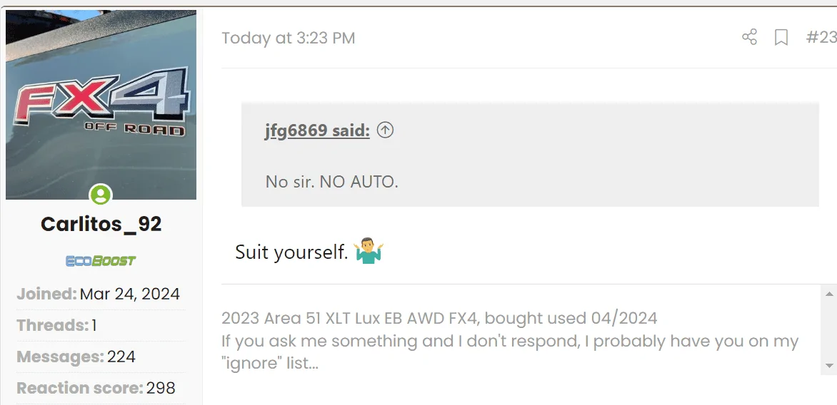

Suit yourself. 🤷‍♂️
huh? You assumed in your post that Mikemoon and I are experiencing this because we use "auto". Neither one of us had auto on when this happened. Just calling you out on that. What's "suit yourself" about?
Carlitos_92
Mar 24, 2024
2,405
5,003
I didn't reply to you, I replied to Miguel. So I hadn't really assumed anything about you at all.
Anyway, a simple "I have the same issue but am not using any auto settings" would've been adequate. Simply giving other forum members relevant information isn't "calling someone out," but if you feel like you had to "call out" someone just trying to help, good luck to you. Cheers.

Looks like it
Ford Maverick AC Fan Speed Changing Automatically? 1717030027892-zr
