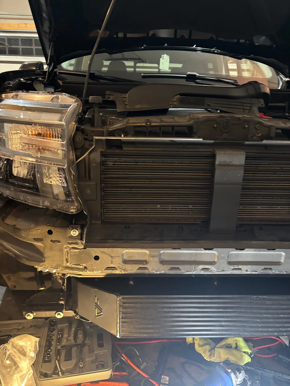

photo from inter cooler install:
Ford Maverick 2023 Shadow Black AWD Lariat Build: Cobb Tune, CVF Intercooler / Downpipe, Gibson Exhaust, aFe intake, Steeda sway bars, 300 HP IMG_7148

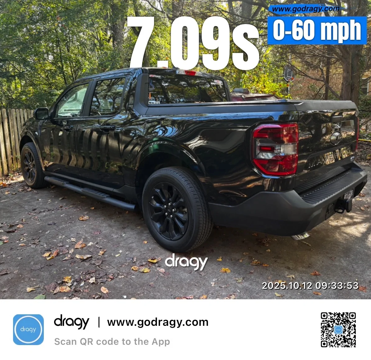

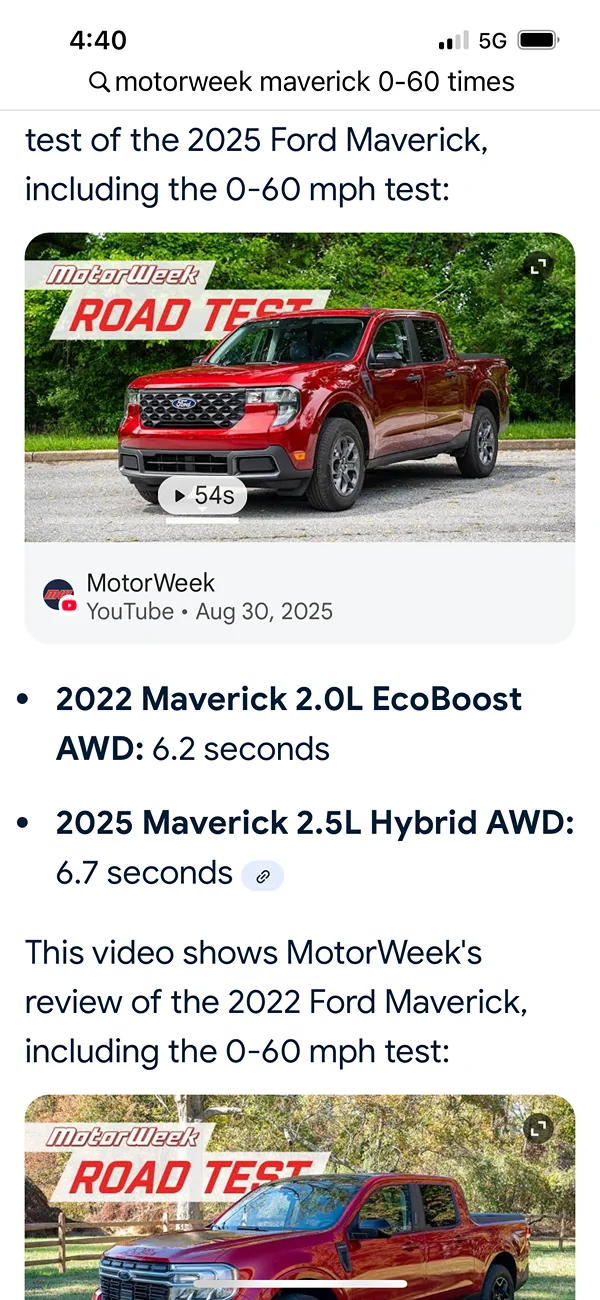

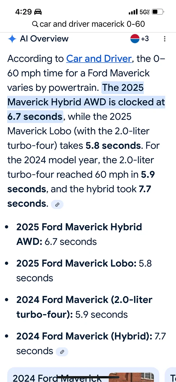

0-60 in 7.09 Seconds sounds off Motorweek ran a 6.2 0-60 Bone Stock?
ShadowChas
Chuck
Nov 13, 2021
652
792
2022 Ford Maverick XLT FX4
Yes as the above member posted, but even the 2025 hybrid awd was faster
Ford Maverick 2023 Shadow Black AWD Lariat Build: Cobb Tune, CVF Intercooler / Downpipe, Gibson Exhaust, aFe intake, Steeda sway bars, 300 HP IMG_6742
Even car and driver was quicker the 1st year 2.0 awd was 5.9
Ford Maverick 2023 Shadow Black AWD Lariat Build: Cobb Tune, CVF Intercooler / Downpipe, Gibson Exhaust, aFe intake, Steeda sway bars, 300 HP IMG_6746
using my brother in law’s device; probably not enough runs or needs custom tune - mainly thought the picture was cool. But, yeah that time should be better. I’ll try to post a video as I have got it up to 130mph pretty easily. Thinking about getting my my own draggy, so I can re-test. Cobb tuner has a 0-60 but a little fickle about recording.

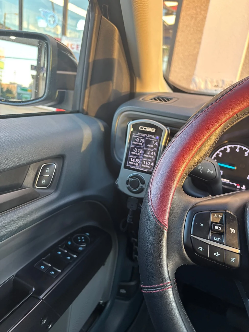

faux wood grain console and cobb tuner

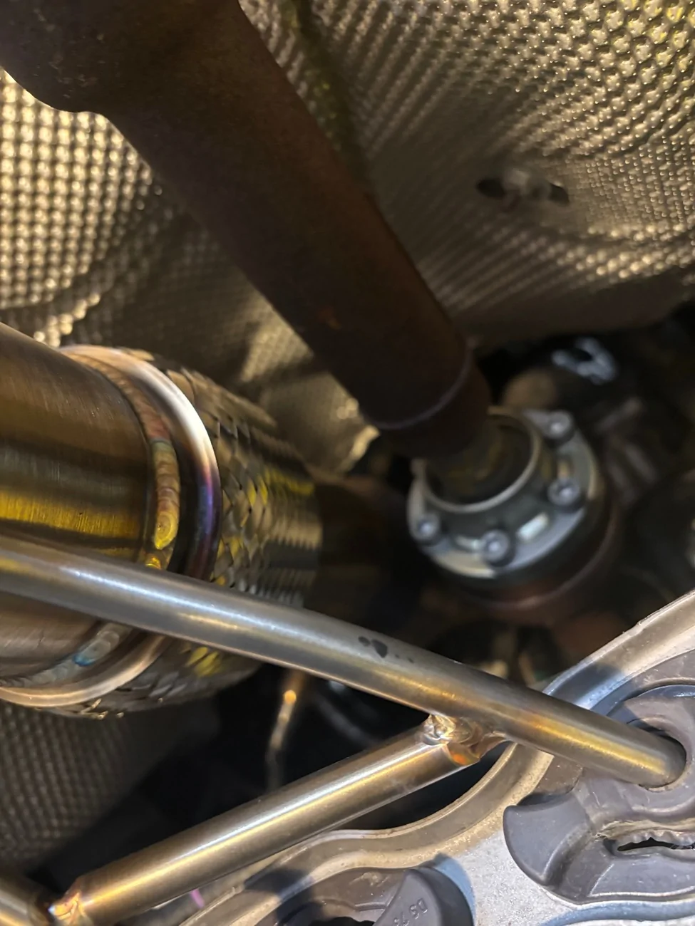

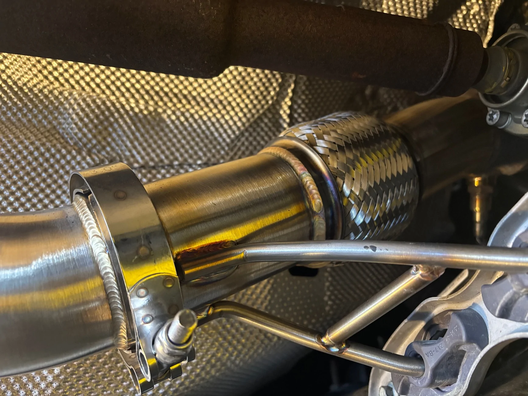

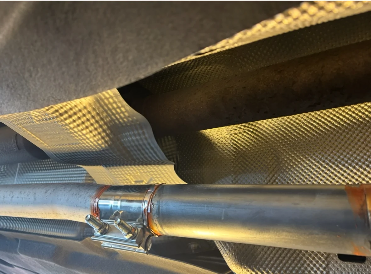

CVF Downpipe - brother in law - had to delete the secondary cat converter and run a straight pipe. They’re (CVF) 2in conversion would not work without doing so. Trying to figure out what exhaust to replace current set up with —- since I am running stock 2in from after down pipe to muffler. Brother in law is a pro street guy and he helped put it in; and by helped, I mean I held the flash lights and he did 95 percent of the install… Add: The provided O2 spacer/ defouler from CVF on bank 1 runs right into the heat shield (it will not fit). The CVF intercooler was way easier but again no instructions from CVF. The difference there is — way more stuff about the install both on here and through panda - you tube. Although the panda motor works video appears to cut right through a sensor on the bumper…
Ford Maverick 2023 Shadow Black AWD Lariat Build: Cobb Tune, CVF Intercooler / Downpipe, Gibson Exhaust, aFe intake, Steeda sway bars, 300 HP IMG_7611
Ford Maverick 2023 Shadow Black AWD Lariat Build: Cobb Tune, CVF Intercooler / Downpipe, Gibson Exhaust, aFe intake, Steeda sway bars, 300 HP IMG_7612
Ford Maverick 2023 Shadow Black AWD Lariat Build: Cobb Tune, CVF Intercooler / Downpipe, Gibson Exhaust, aFe intake, Steeda sway bars, 300 HP IMG_7615
Automan21
Mel
Nov 30, 2023
1,066
930
CT
‘23 XLT Eco AWD 4K Tow
CVF Downpipe - a bit of a hack job on the exhaust; but based on CVF 1) no instructions 2) zero contact email or call back from customer service (tried a combined 8 times to reach them). I had to delete the secondary cat converter and run a straight pipe. They’re (CVF) 2in conversion would not work without doing so. Trying to figure out what exhaust to replace current set up since I am running stock 2in from after down pipe to muffler. I won’t buy from CVF again. I would have done a charge back on my card but my brother in law is a pro street guy and he helped put it in and work out the check engine light (bank 1 o2 sensor). This could also likely be tuned out. Add: The provided O2 spacer/ defouler from CVF on bank 1 runs right into the heat shield (it will not fit). Lucky enough my brother in law had a right angled one sitting in his garage on the shelf. The CVF intercooler was way easier but again no instructions from CVF. The difference there is — way more stuff about the install both on here and through panda - you tube. Although the panda motor works video appears to cut right through a sensor on the bumper…
How was the install on the cat? Did you get to the bolts from above or below? Have a catless waiting to install. I plan on purposely getting rid of that second cat.
My 2 cents for the weekend warrior- at least for me- (alone) it would be nightmarish but I had big help. We got 2 bolts from above which were actually somewhat straightforward. One from below gave a my brother in law quite a hard time. Oddly enough it seems like the reports are that 2 are easy from below. One is hard from the top. We seemed to have the opposite experience as I mention above. To get that last bolt off — he had about every extension (could not reach from the top); penetrating oil; and bending wrench with electrical tape you could think of. Then there’s this crazy heat shield on the cat converter which does NOT seem to appear in the service manual or any of the other posts (unsure if it’s a 2023 lariat thing or what). Point is: took both of us with crow bars to pry out the old down pipe even after the bolts came off. Sliding the new downpipe on was a bit easier. The only sticking point was the bank 1 - o2 sensor being up right against the heat shield. I am guessing if you’re doing cat-less — that won’t be a problem. Let us know how it goes.
