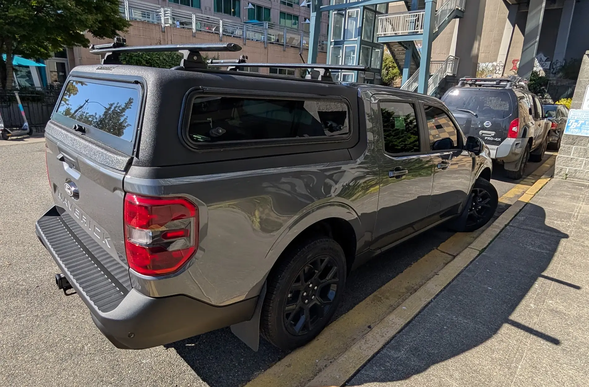

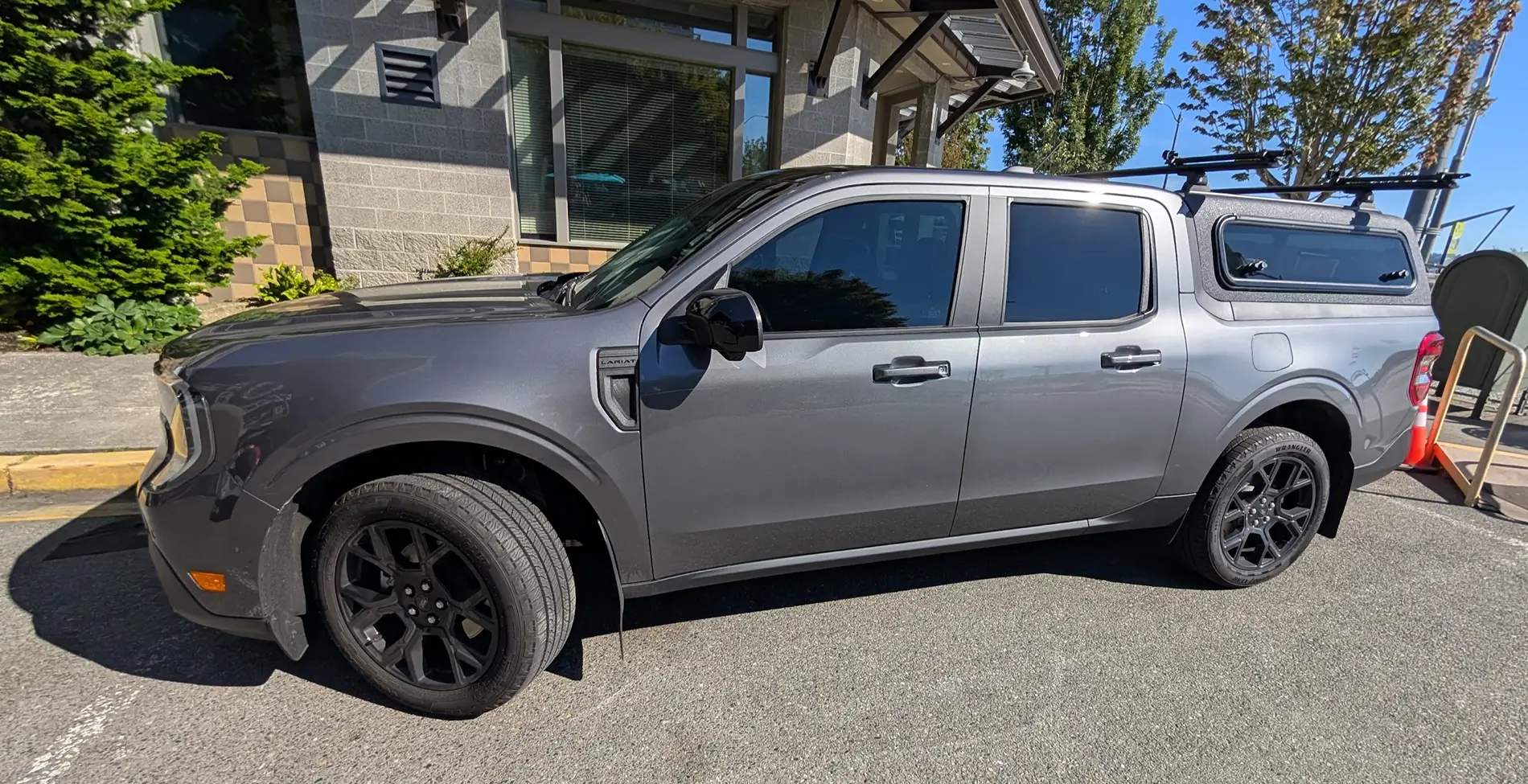

I had a hard tonneau cover with my previous Maverick, but with passengers and longer trips, space gets tight. If I do need to haul something taller, I'm banking on the 360 cameras on my new Maverick to help me maneuver a utility trailer.
Why the ARE V Series Shell?
  • Straight roof line: I have an old home with a short garage. A mid rise with roof rack would not be able to fit. With the V shell, I’ve got enough room to get my truck on a QuickJack and do things like swap in my winter tires and change the oil.
  • Side bed access: I wanted to minimize the times I’d have to crawl into the bed and grab something in the front of the bed. This is the only short shell that has the windoors (windows that tilt open). I really wanted sliding windoors (windows that tilt and slide open) but that’s not an option.
Why not the ARE V?
  • Quality: I knew what I was getting into based on other reviews. Luckily my issues aren’t nearly as bad, but still disappointing to see overtorqued screws, nicks in the rubber.
  • Pricing: It’s ridiculous how much these things cost and why I scoffed at getting one originally. Go used if you can find one.
  • Autolock: This has a T-handle and rod on the back to secure. Unfortunately, autolocking mechanisms are designed for cables that you see in Leers.

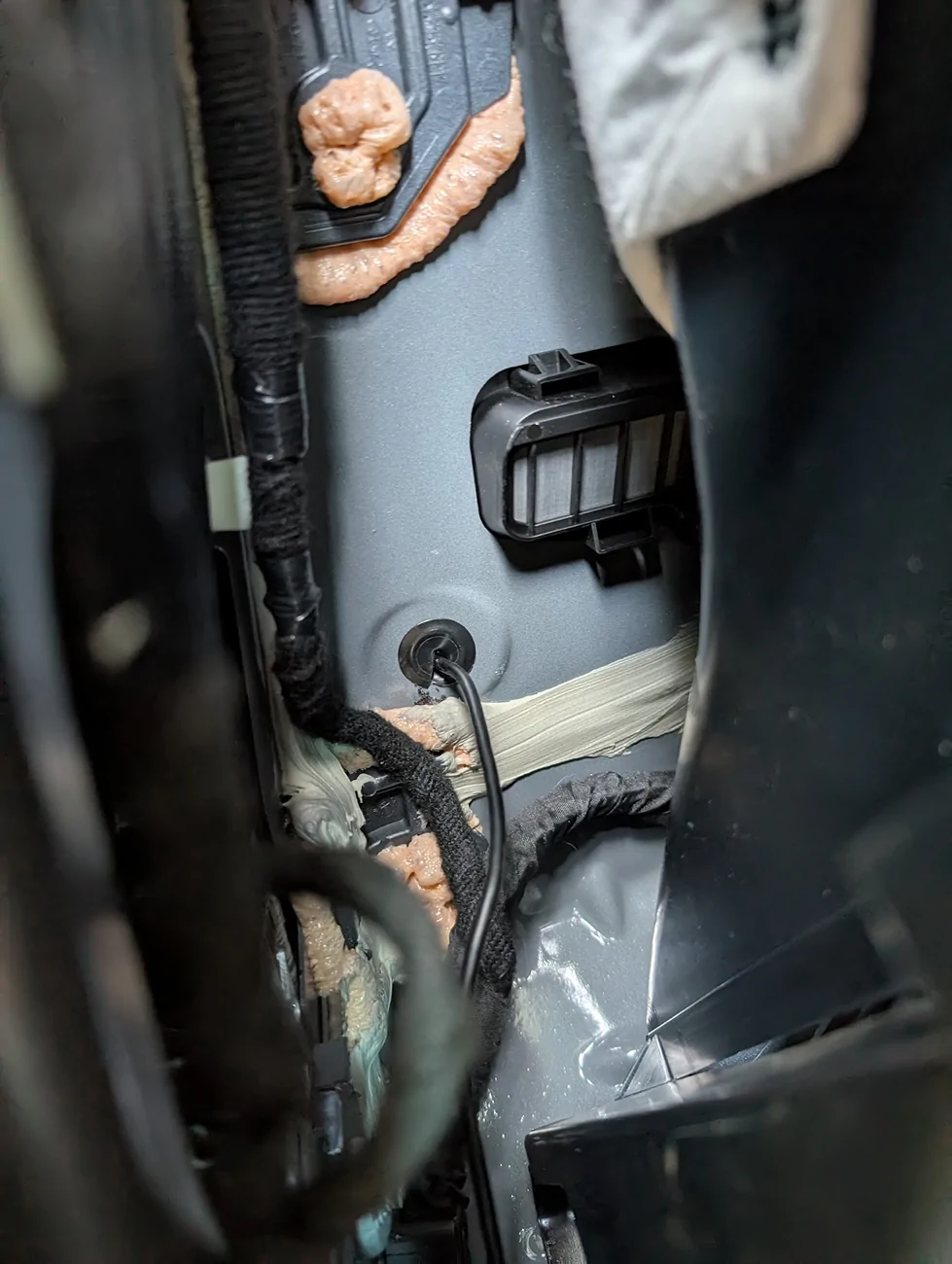

I started with the rear camera to figure out how much cable I needed to mount the camera inside the rear tilt window. I wanted the cable to pass behind the storage cubby back into the cab. I followed this video to remove the plastic to access a spot to pass the cable into the cab. I used a fishing wire to get the cable to the back.
Ford Maverick Install of digital rearview mirror (Wolfbox G900Pro) with a shell truck cap (ARE V Series) 1757216919298-8c
In the cabin, I ran the cable under the passenger side trim to avoid the airbags in the headliner and up the A pillar to the mirror. I opted for a harness from Etsy to tap into the mirror light and so far haven’t had any issues. I’m holding on to the hardwiring kit just in case.
All in all, expensive purchases but has worked out well for what I needed. I hope this helps those considering investing in a shell!

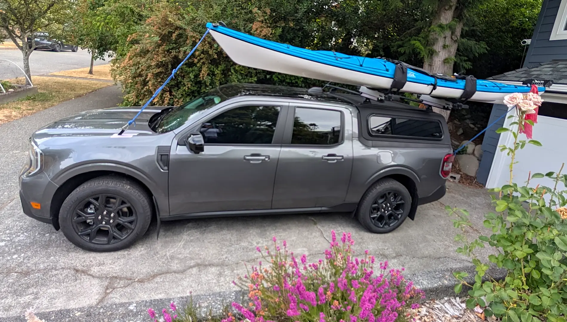

- could you put your kayak upside-down and a bit further forward, so the bow curves down along the roof slope? I wonder if the aero would be better

For the kayak, I've been mostly doing shorter local trips so aero doesn't make much of a difference and loading right side up is a little faster. I'm heading out on a longer trip today with two kayaks on top so we'll flip them upside down to be more aero. The main thing when doing that is to be careful about the mount points. Mine are pretty close to the start of the hulls which are reinforced.

Thanks for the answers. Is the cap painted with bed liner? I like how it almost matches the plastic trim around it. Color-matched roof-level caps have a tendency to make Mavericks look like SUVs, but leaving it black avoids that

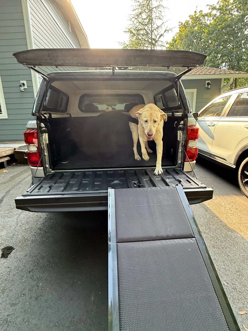

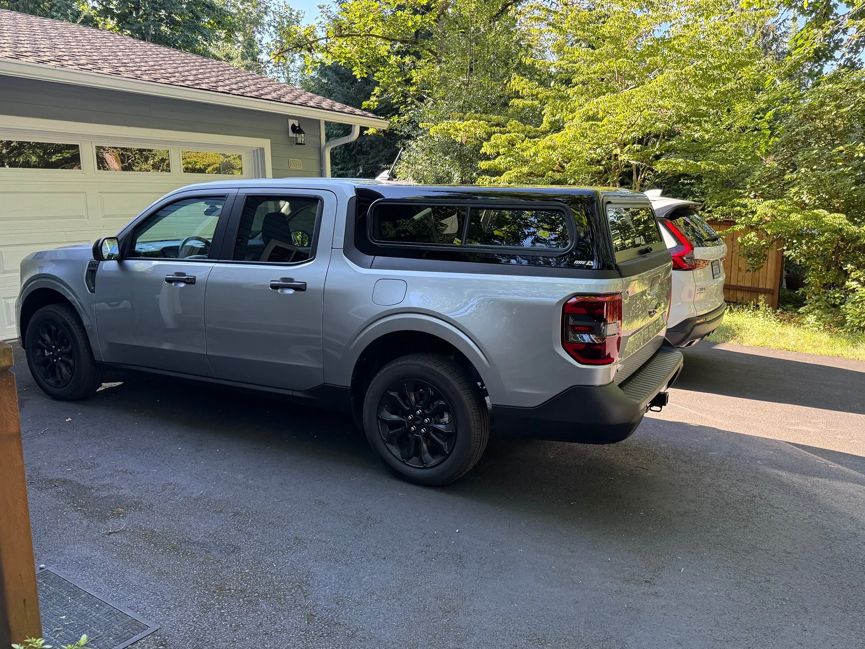

I also got an A.R.E. cap, but my windows open. I did not spring for the headliner, which was a mistake. The interior is pretty rough. I also went with Black on my Silver truck, but was unable to get flat black and had to settle for shiny. Did not want to look like Yet Another SUV. Cap does fit well and I am pretty happy with it.
I do agree it is expensive for what it is. I also had to wait for 4 months for delivery.
I use it to haul my 2 labs around so I needed windows that would open, otherwise I might have gone with Leer. My truck is a 24 XLT hybrid and has a drop in bedliner. The liner is pretty slippery, so I put in a rubber bed mat that has much better traction. I had to cut it down a bit since the drop in liner takes up some space.. Also added a ramp since my girls are getting on in years.
Believe it or not there is a Black lab next to the yellow one in the pic!
Yea it's ARE's version of a bedliner called OTR. I liked this look because of what you said and helps with resale value if I ever decide to move on from it. It does cost extra but ARE was running a promo at the time I was ordering.
ARE has some rule about only using colors for your vehicle. So my black options were the gloss black that our trucks come in or OTR. Leer lets you pick from more colors so I had read you can do a Jeep matte black which is an even better match to the trim.

Larger caps have an option that both swing and slide open, which is great for dogs and bed access. My spoiled dog rides in the back seat, but in a pinch and cooler weather, I can use the tilt down slider window I got at the front.

Grandpa Disney, would you please share information on your ramp? My 13 year old chocolate lab is starting to need help.

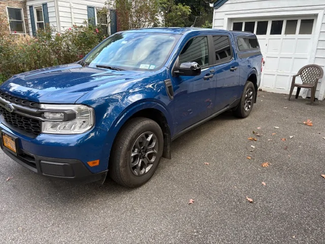

I have a '24 XLT Hybrid with the ARE V cap. I think its great. I have twice the lockable storage capacity compared to a Mav with a tonneau cover. It did cost a little over $3000. Not a cheap option. It is painted Atlas blue like my truck. I think it looks factory. If people think it is an SUV I couldn't care less. I'm surprised more pickup truck owners don't go for the caps instead of the tonneau covers.
