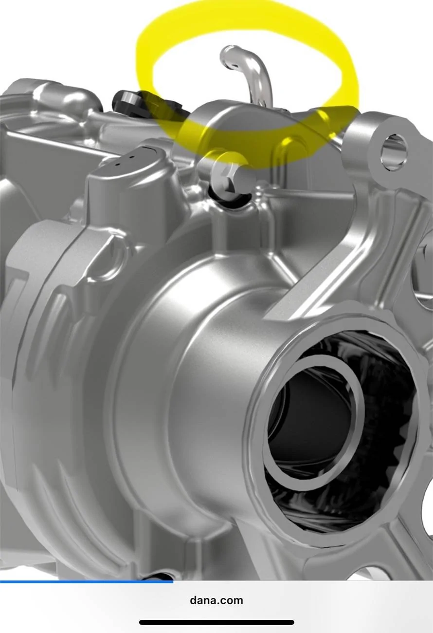

The Dana Spicer Advantek RDU is not sealed. It has a vent tube. As air gets hot, it expands. Without a breather tube, the differential would become pressurized, which would then blow all of the lubricant out through the seals for the axles and drive shaft.

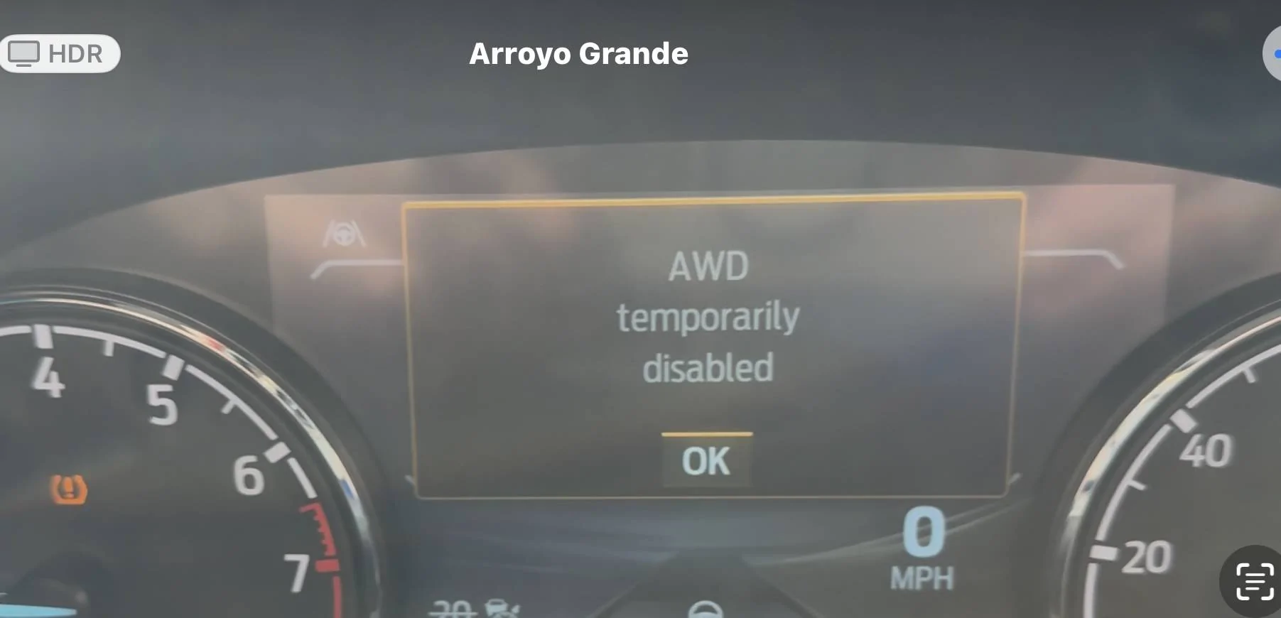

I have an FX4 that has sand mode. I had the traction control turned off.
I had no stability control braking interdiction before the “AWD not available notice”
braking interdiction is very noticeable when doing a big power slide, doing donuts, or even a u-turn with lots of throttle.
When the AWD shut off, I was doing very steep climbs in soft sand, straight up a hill. Again, no braking interdiction.
When the AWD shut off, I immediately lost power to the rear tires and the front started to spin wildly and my front tires started to sink, so I got off the power and came to a stop, it until it sorted out the rear wheel drive situation.
The message that I received was “AWD temporarily unavailable”, not “stability control unavailable”. The disc brake activated stability control was still working just fine. The problem was no power transferred through the PTU or RDU.

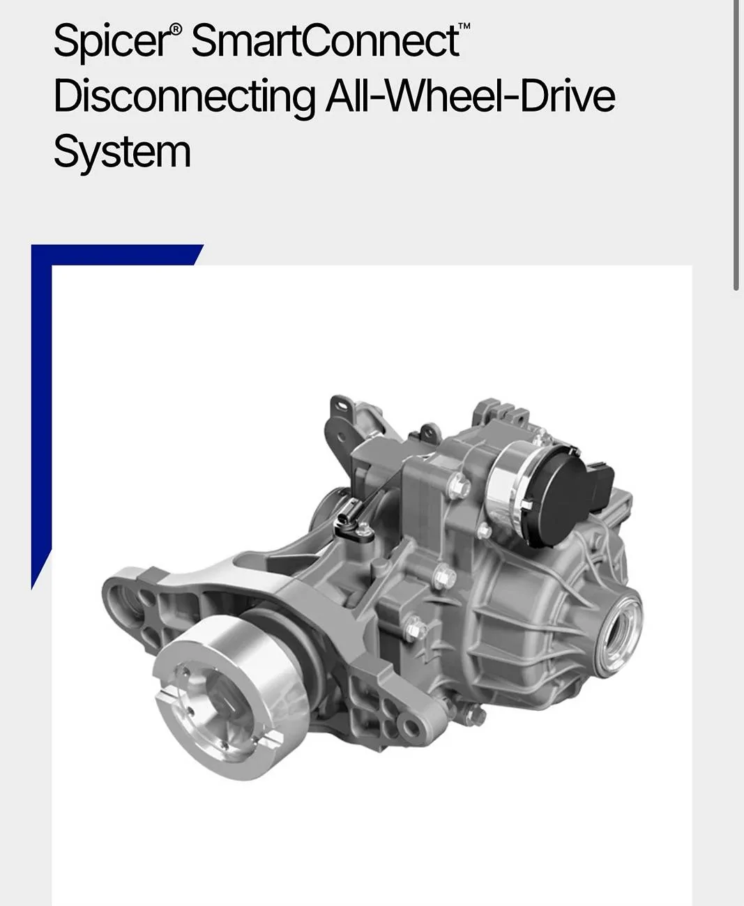

When it is not using awd, the driveshaft and RDU stop spinning. This is achieved by a clutch pack in the PTU in front of the driveshaft, and then a clutch pack inside of the RDU, after the driveshaft, pinion gear, ring gear and spider gears, but before the rear axles. When both clutches are disengaged, the driveshaft, pinion gear, ring gear and spider gear carrier all come to a stop, to reduce parasitic drag.

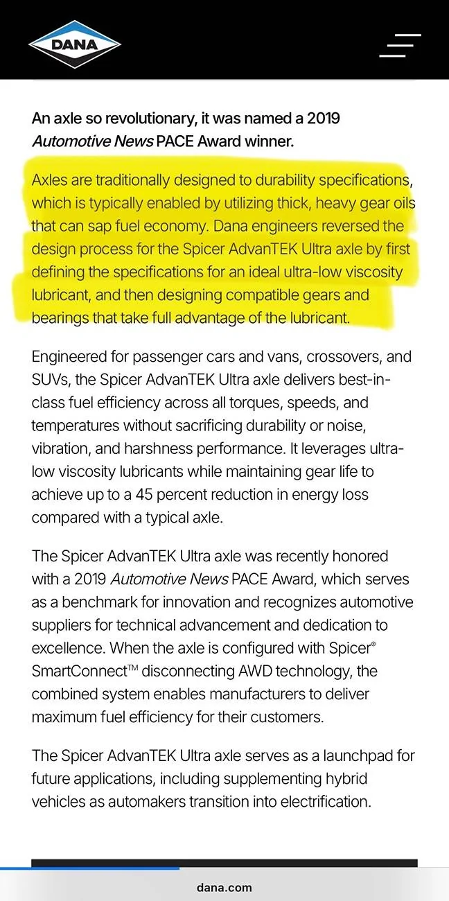

The Dana Spicer Smart Connect PTU and Advantek RDU don’t use gear oil. They use a “ultra low viscosity” lubricant that has been described as being similar to 5w20 with an added friction modifier.

Could the smell have been ATF? Yeah, that is a possibility. However, if the ATF was overheated, it should have sent a transmission temp warning and put the power delivery into limp mode, not simply disabling the AWD, while leaving power production at 100%
Also, I didn’t mention this in the discussion above, but when the AWD unavailable message popped up, it would go away in as short as 30 seconds after stopping and sitting with the engine idling and letting the oil pumps and coolers do their magic. If it was overheated brakes, that are normally cooled by high speed airflow, I would expect it would take more than a few seconds for the brakes to cool down sufficiently, when sitting at a dead stop.
The transmission uses ULV ATF. The PTU uses 75w-80 Hypoid gear oil, and the RDU uses 75w "rear disconnect drive unit fluid". I changed all three Motorcraft/Ford-specified fluids in mine two weeks ago, and I can tell you for certain that the transmission fluid looks and smells like ATF (basically hydraulic fluid), and the oils in the PTU and RDU look and smell like sulpher-y gear oil. Granted, they're not as viscous as some gear oils, but they're much more viscous than ATF, and certainly wouldn't ever smell anything like ATF, hot or cold.
Now that you've mentioned the ATF smell, I don't believe it was brakes either. They do smell different, and we didn't have that tidbit of info to go on at the time that @Snox801 mentioned it.
