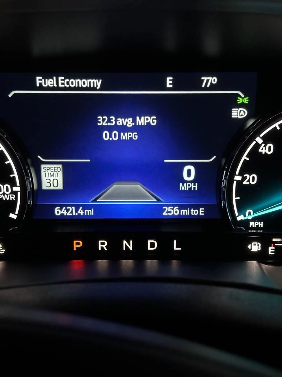

To those that have the 6.2 inch dash cluster. When in the fuel economy screen the current fuel economy does not show a number it has the gauge 0 - 30 - 60 and you have to guestimate what the current MPG is. Has anyone found a way to switch this to show an exact number instead of a gauge? I have looked and not able to find a way, but wanted reach out in case someone has found a way. Thank you all for your help. I have gone through the owners manual and not able to find a setting to change this.
Thank you all for your time.

Can you please post a picture of the screen and mode you are talking about.

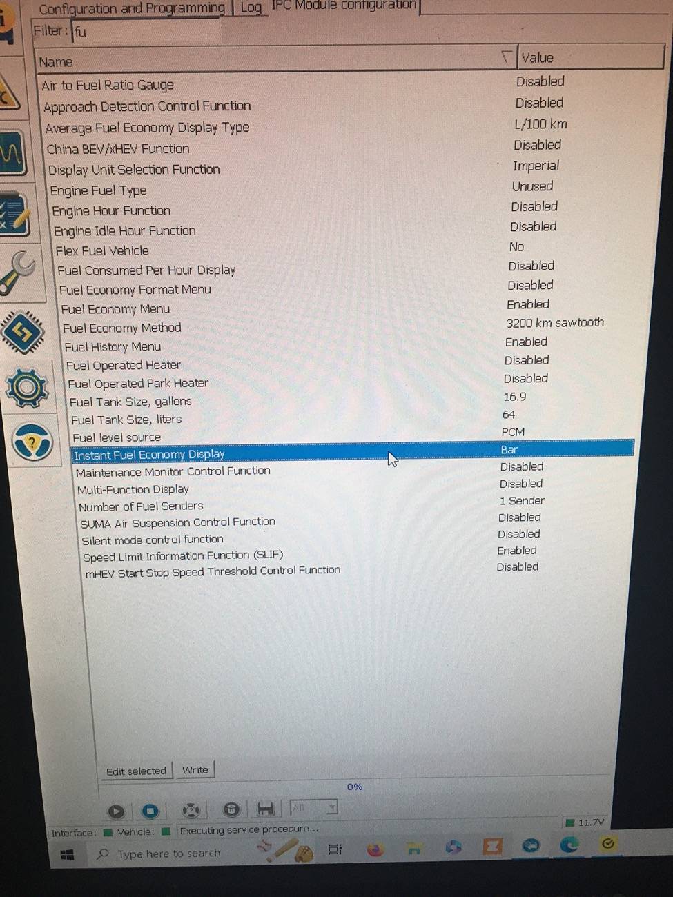

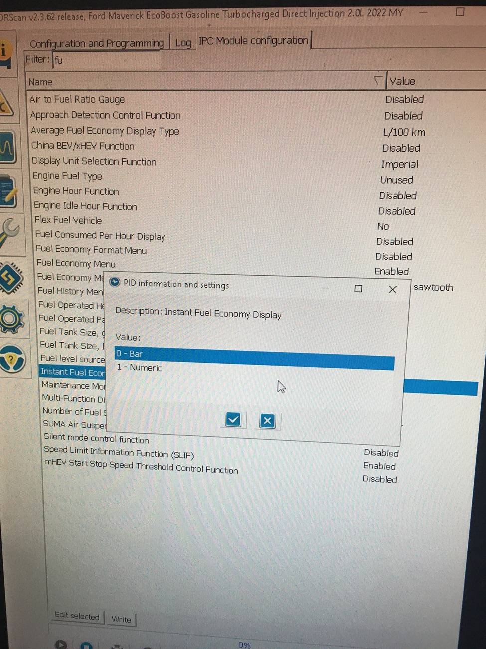

I believe it can be changed from a bar to number in Forscan. Would be in the IPC if possible.

Had an opportunity to look tonight.
Outstanding will definitely be changing that tomorrow when I am off. Thank you for the find.
Thank you for the directions on where to find it. Programmed it this morning and so much better/easier to see current MPG’s. As always such great help here in this club.
