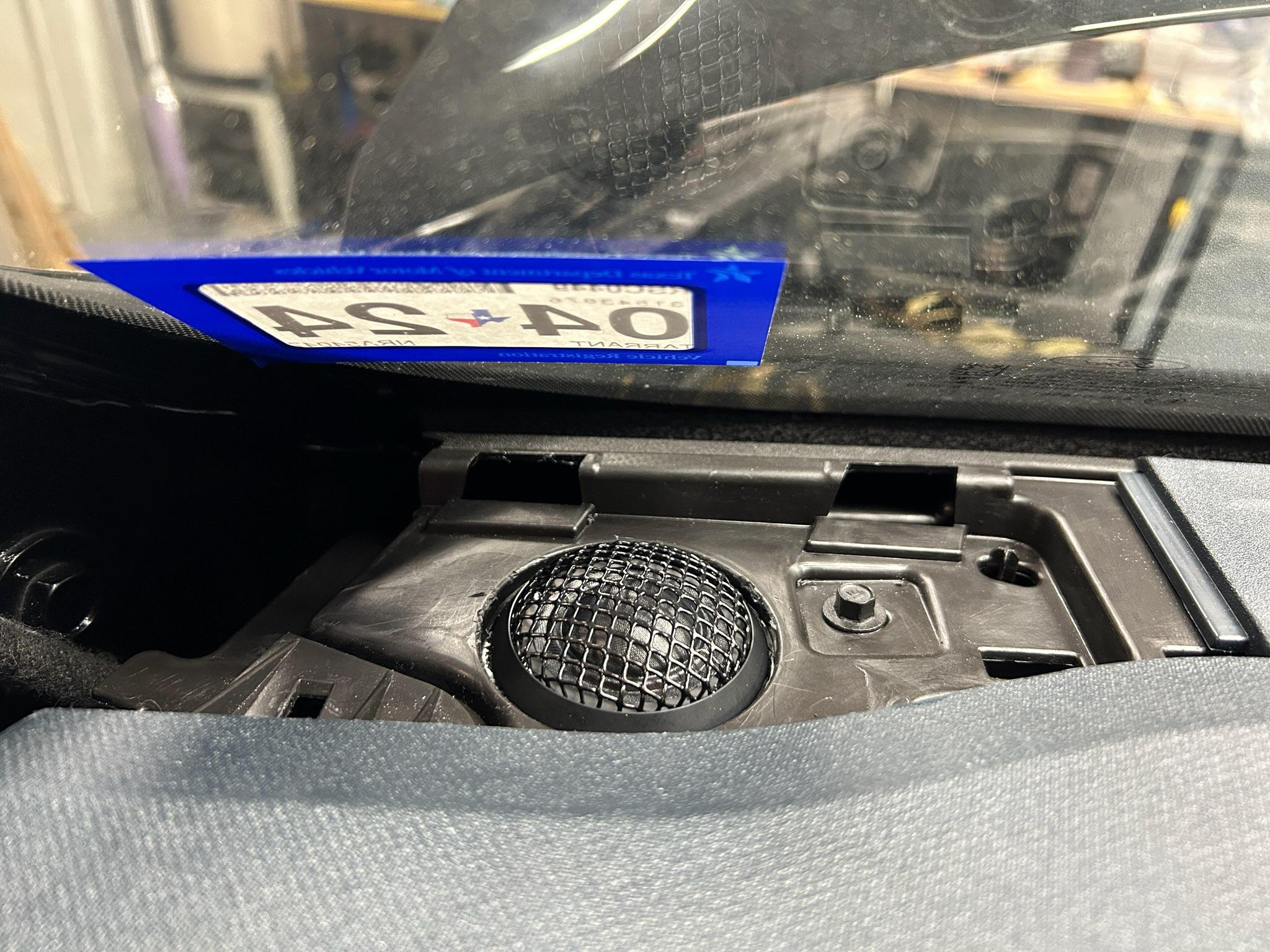

I have a 1.5 inch tweeter in mine now, will be putting my 2.5 wideband in mine as well, but I had to Dremel to get my tweeter to fit, and you don't have a lot of space before hitting your ac ducting underneath, my tweeter is almost touching it.
I would get a second set of tweeter covers and just see how the wideband sits on it and then just use the frame from it and cover with speaker cloth to get the added height

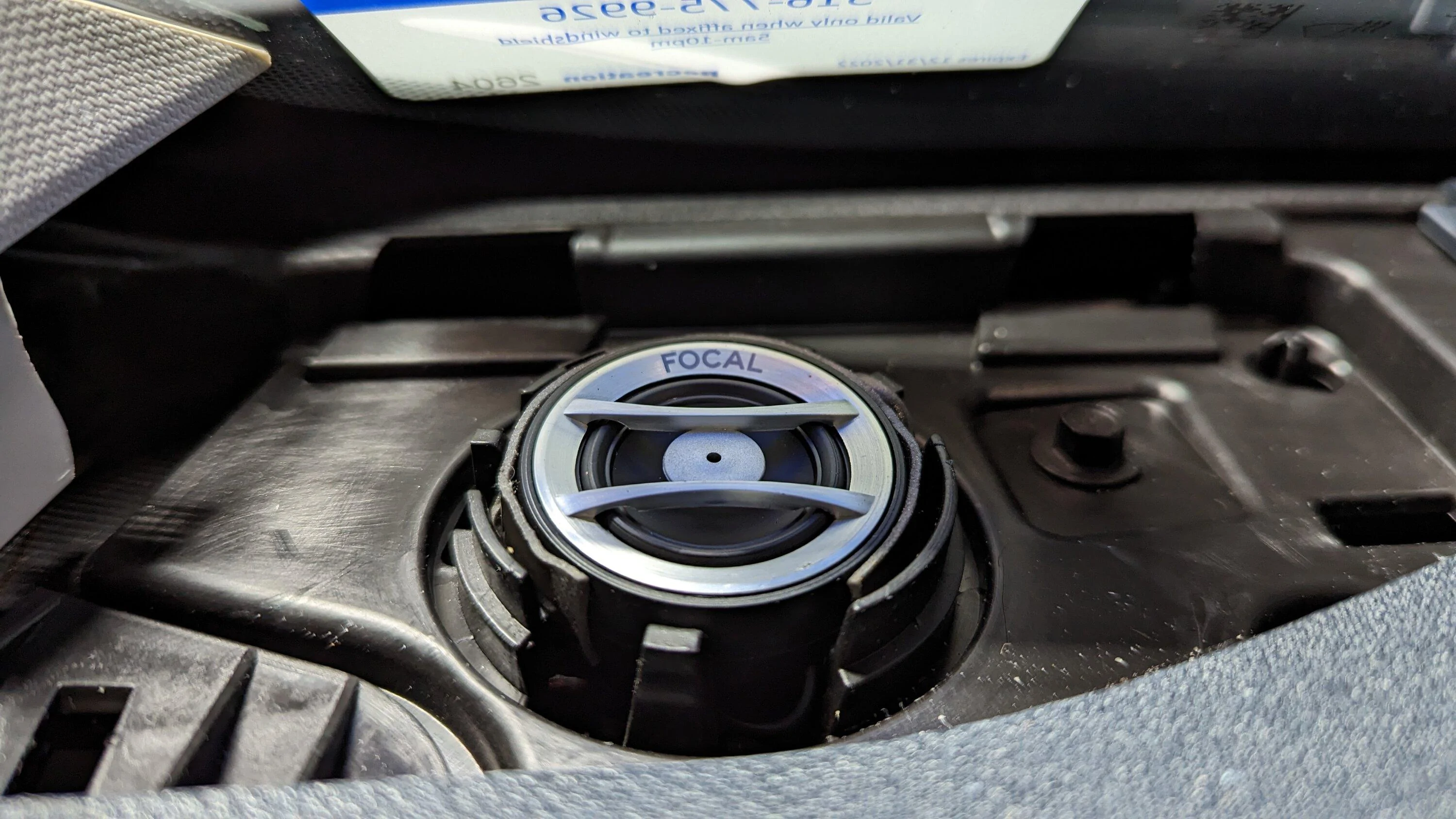

I forgot I took a pic like that. I removed the trim ring from my tweeter and it fit actually a bit loosely, so I used double-stick tape on it.
it seemed to me like there was room for the OP's 2" which says 1.3" mounting depth, but he'll have to get in there and measure.

I'll be honest I have a massive tweeter that has a cnc chamber on the back end lol, main reason I'm almost hitting the back of the ac duct.
