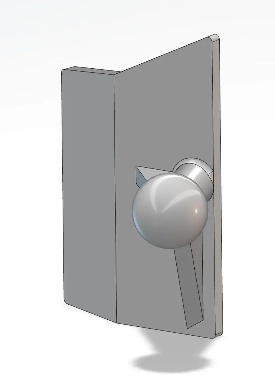

This is a vehicle-specific 17mm ball mount for the Ford Maverick. It is contoured to fit the right side of the cubby next to the stereo touchscreen in the dashboard, and has a standard 17mm ball to work with many accessories. My friend printed it with PETG-CF because that was the most heat-resistant filament he had for his A1. I recommend using VHB double-sided tape to attach it to the vehicle.
Link to MakerWorld File
Ford Maverick 3D Print 17mm Ball Mount for Dash Cubby (free download) Screenshot 2025-07-27 at 1.03.22 PM

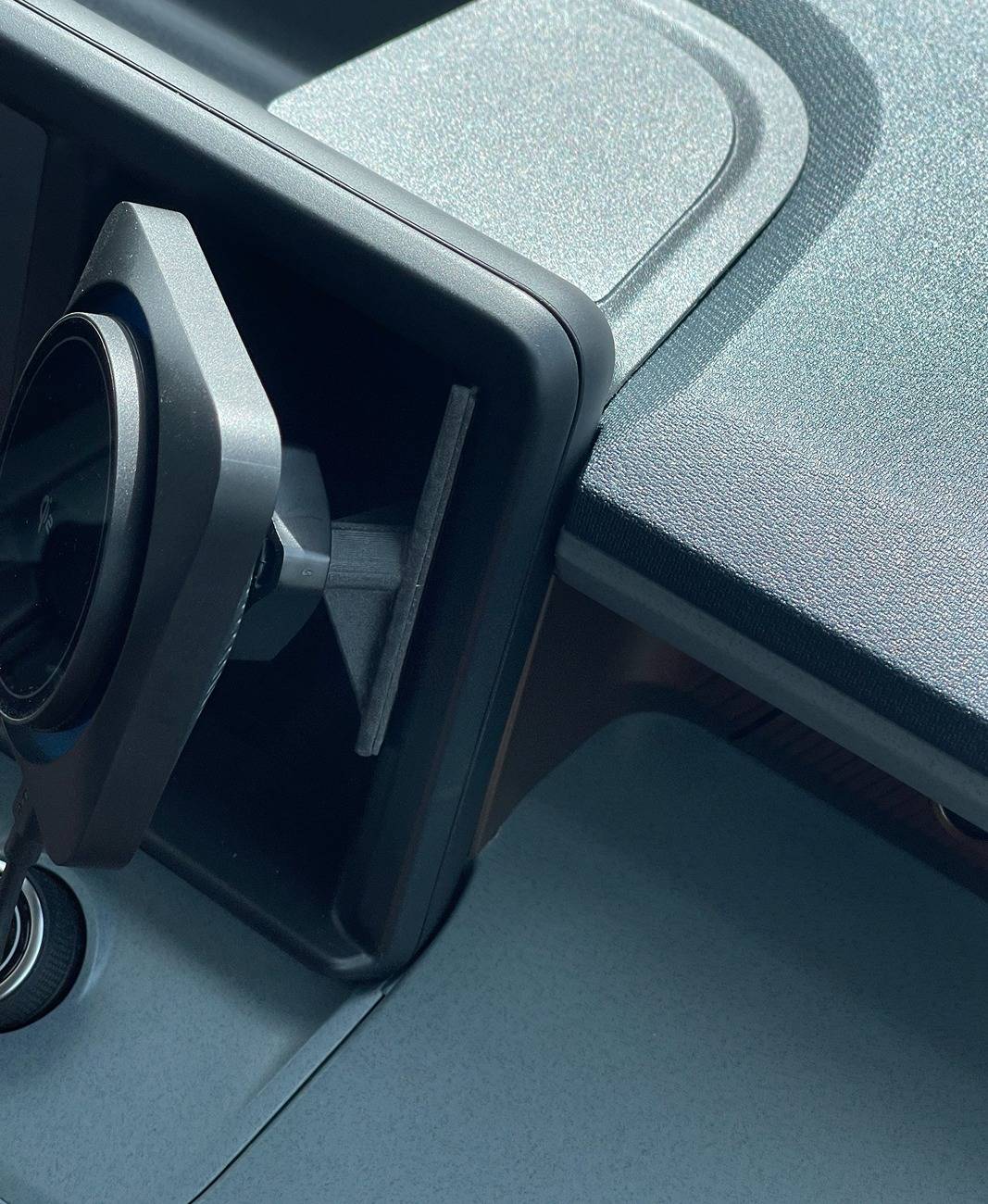

I used it with my ESR Qi2 MagSafe wireless charger for my iPhone and it works perfectly with far less wobble than the standard ESR mount.
Ford Maverick 3D Print 17mm Ball Mount for Dash Cubby (free download) IMG_2611 2
