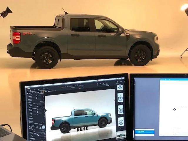

Sneak Peak, Maverick incoming ! Thanks to a generous customer and new Maverick owner, Tire Rack will soon have a Maverick image on the wheel selection tool. ETA to the website is early next week.
Ford Maverick - Maverick

Looks like we have a TireRack employee among our members!:cool:
