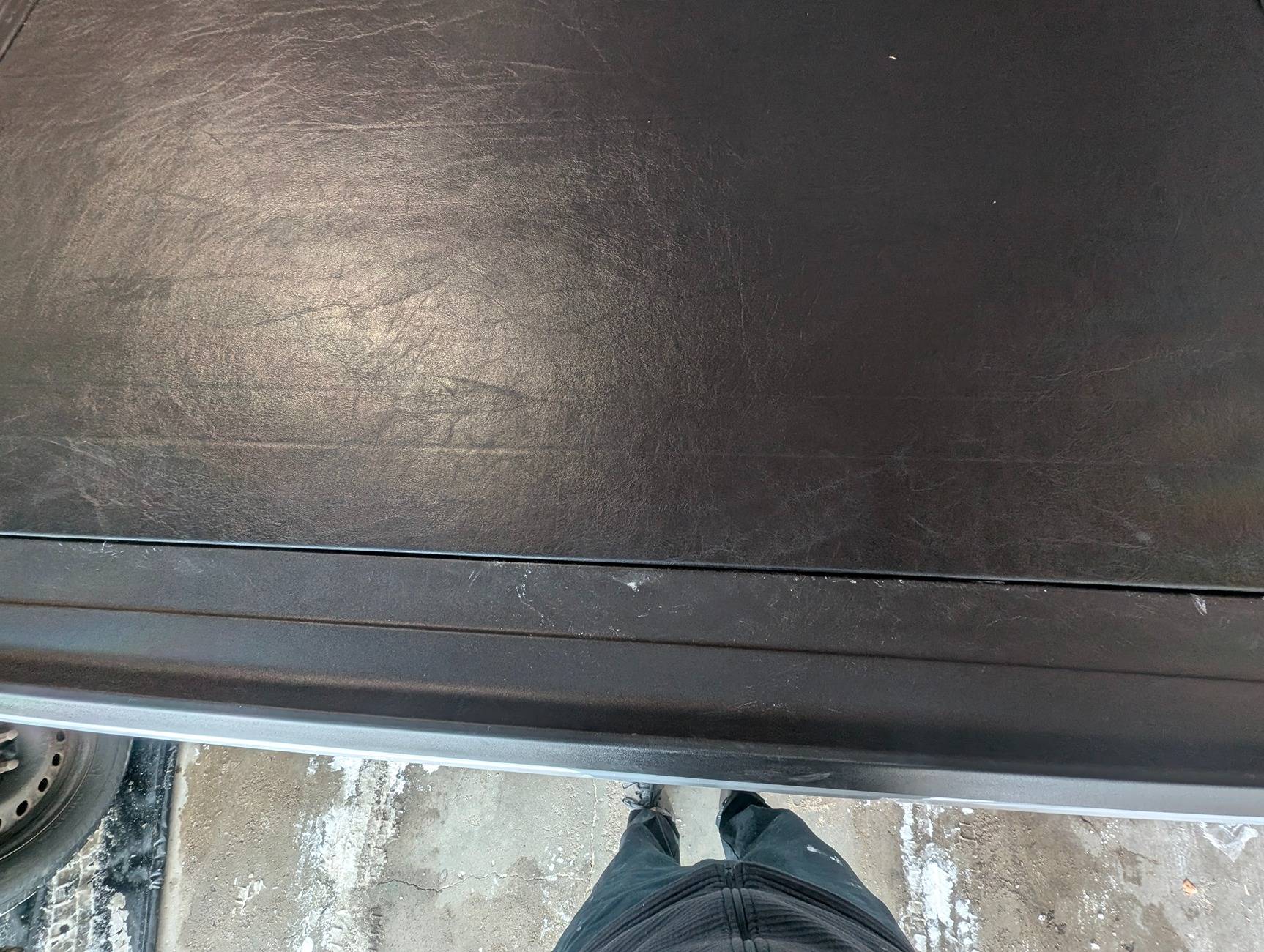

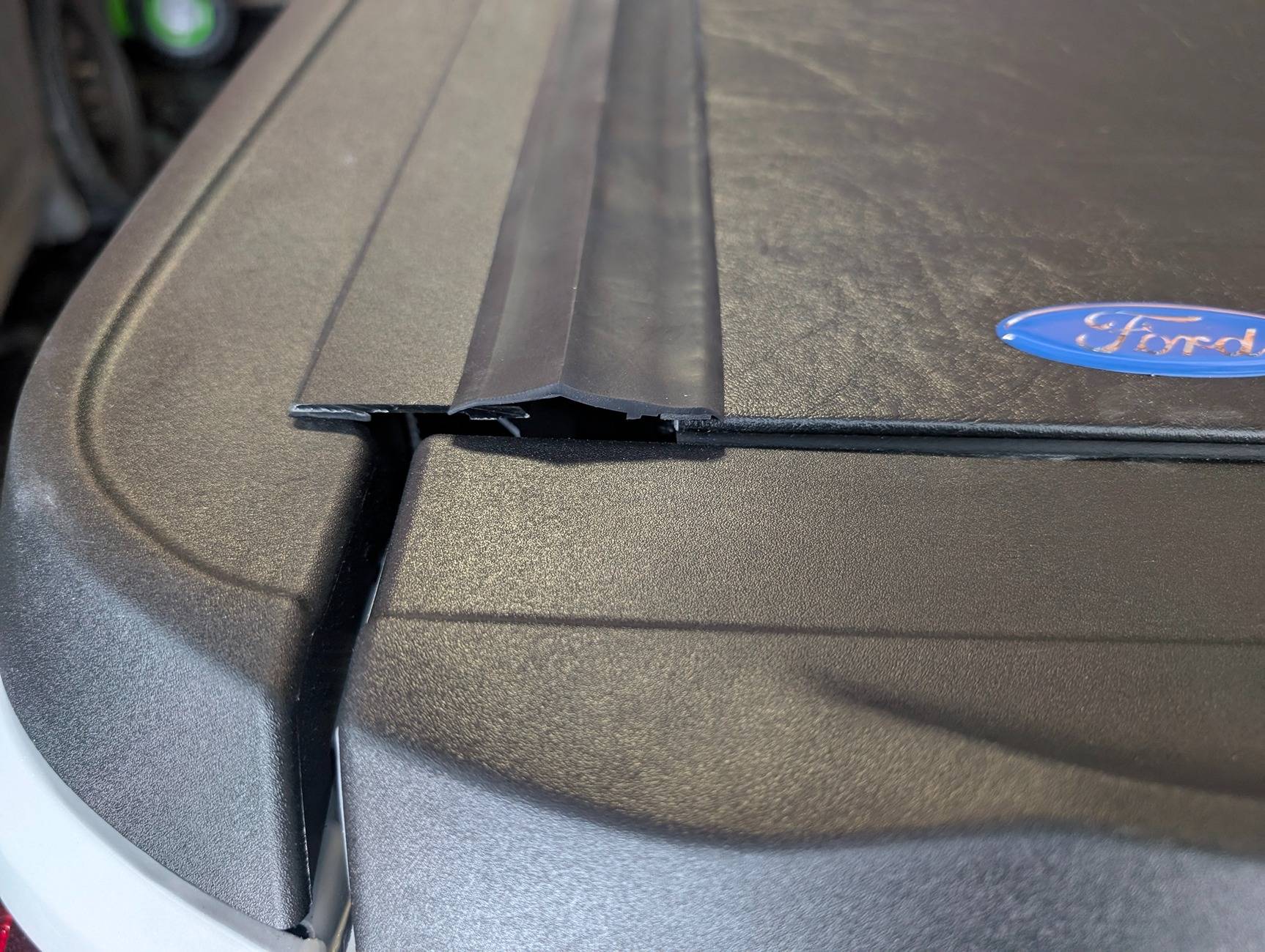

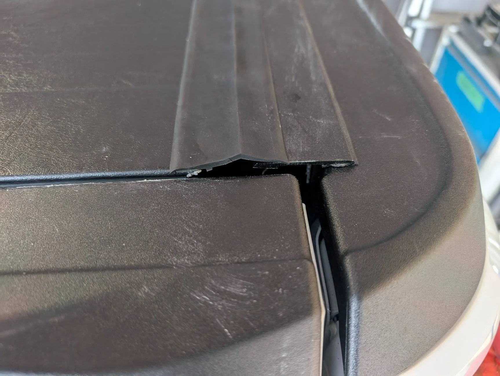

Ended up going back and trying to fit it a little better. I just want it to be as water resistant as possible and this seems to be a major issue with this cover. It doesn't actually overlap on the back tailgate at all, leaving a gap for water to come in. Also near the back tailgate their is massive holes where water will enter.
Might just get a hard trifold...

Dave, I also have the Ford hard roll up cover and mine looks very similiar to what you shared in your pic's. Mine is not "water tight" or anything close, given the gaps around the tailgate area. I've had several different styles over the years, and don't know any were water tight, but I never thought they were either. Perhaps my expectaions were too low? Maybe they should be decently watertight?
I think you made the right choice if there's a cover that is known to be better in that regard and that's important to you. I know you only expected "water resistant", but I can't see how the Ford hard roll up design could do very good, given it doesn't have any overhang over the top of the tailgate. That gap is just itching for water from the cover to leak down inbetween the tailgate and into the bed area.
I do like it for the snow load it can handle and decent protection it offers for items stored in the bed from theft, due to the design that includes alot of metal, rather than just fabric like some.
In those areas it is pretty decent.
That looks like the previous revision of the BAK, the X4. Mine has corner caps that partially cover that tailgate gap.
The very end of the cover has a seal that goes against the gate, but it take a little bit of adjusting to get that as best as possible.
No matter what, water will come in at the sides of the tailgate. To minimize that, you want a tailgate seal. Here is a great video showing how to add it to a Maverick; this is what I did.
There is also the small gap on the bed caps, towards the front, that you want to put something in.
