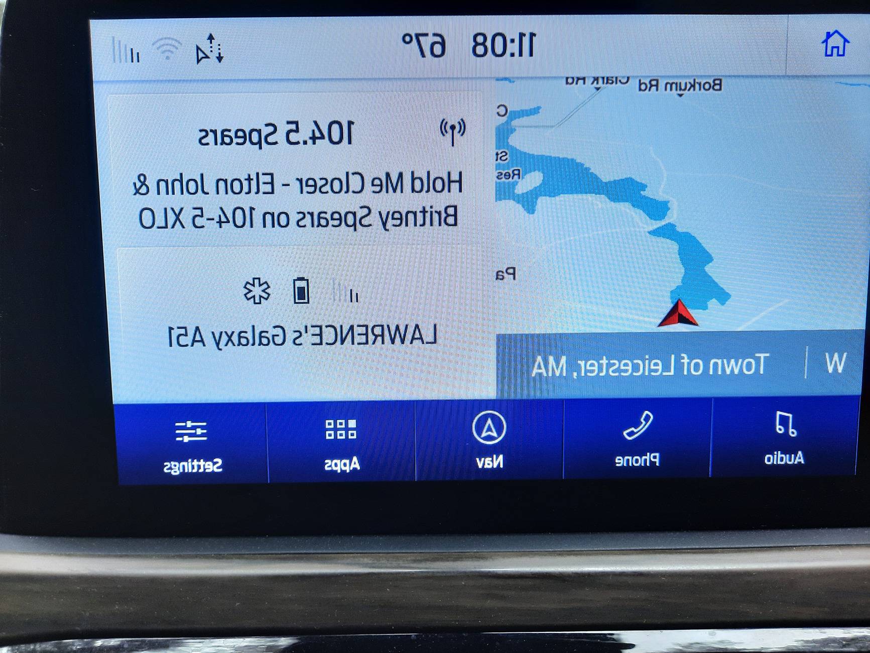

Had off and on issues with screen using Sync 3 when I had my Escape (traded in for Mav in Sept). Once came up in Chinese, wish I had taken a picture. Did take a picture of this... Picture is a mirror image of what it should have been. Do I win a prize. hahahahaha
Ford Maverick '22 Lariat ambient interior lighting turns off for no apparent reason 20240606_110824[1]
