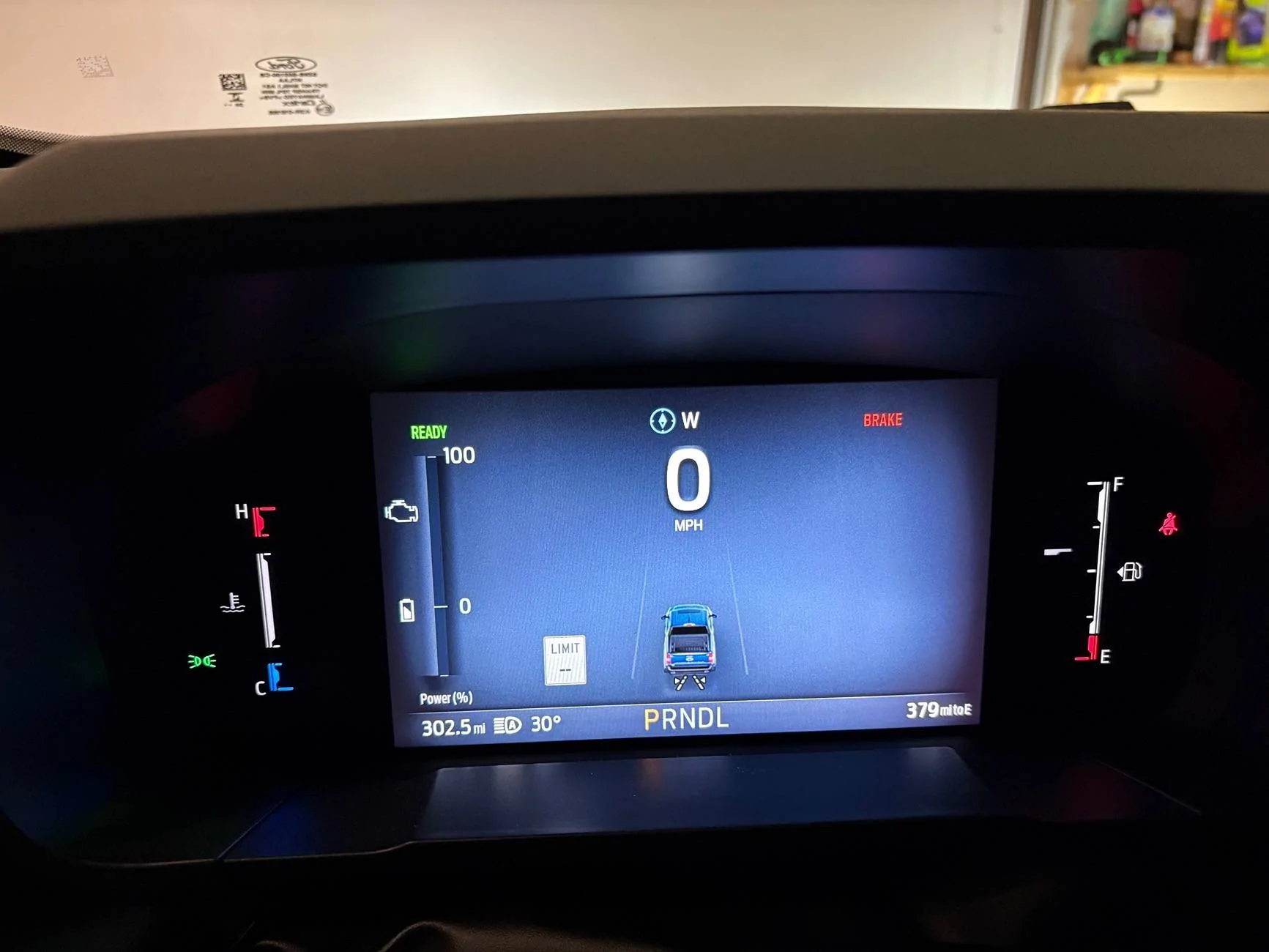

No it is not gone.
It is not on by default. You have to enable it for the “left gauge” in your driver screen settings.

No it is not gone.
That's not really the prior Lariat Power Flow App though, available in the infotainment center.
That's just the Power Meter like they all had.

No it is not gone.

does it stay on 24/7 or does it require re enabling each time car is on? do you feel its worth even having on? or just a distraction
Stays on once enabled. I don’t find it distracting but also don’t really find it useful for operation. I guess I’d rather have it than not.

No it is not gone.
I do like the 10% tick marks though on Power meter - made it easy to stay below the point of ICE start.
Battery recharge section is as big as it needs to be.
And that prior huge wasted space below recharge, nice.
And the EV Coach doesn't use that new Power meter correct, still it's own section on right when enabled?

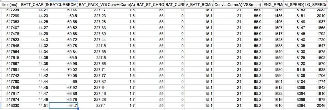

thanks, so question.
does the battery like, recharge of ICE operation? like say battery is empty, and then you're just cruising 65mph on highway, does it parasitically recharge the battery so in a bit of time its 100% again? you'll see it increasing from 0 to 100% via steady speed highway in ICE mode
not sure when it actually recharges it
Unless you are fully using the power from the engine - there is always some level of recharge going back to the HVB if the gearing allows it.
Since the generator motor is controlling the gearing needed, and sending power to HVB, it can vary.
The range BTW is 30 - 70% SOC.
I have log file showing 66 mph, around 70 A charging rate, took 3 seconds to go from 44 to 45% SOC.
(and yes, for anyone reading that 2nd battery charge current for 12V at 55% SOC, below 1 A and only 8 min into drive - stupid charging system).
