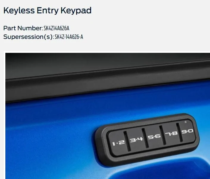

This one?
HRG
that's the one! thanks. now I can at least give them the part number. where is that though? I can't seem to find it on the ford parts site using that part nunber
