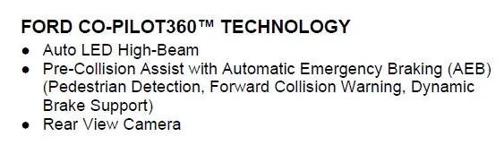

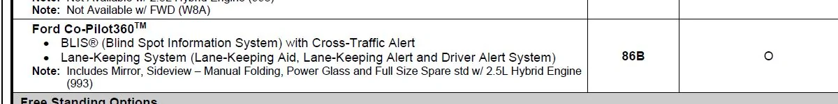

On the proprietary 2024 Maverick Supercrew XL Series Standard Equipment listing (7/10/23) it shows the Ford CO-Pilot 360 Technology as being standard now. That would make it standard on the XLT also. However on the Equipment Group listing (7/10/23) it shows the Ford CO-Pilot 360 as being optional for $650. Is it now standard or still optional?

Look closer at the description of what is included Standard and what is part of the Co-Pilot Option package. They are not the same. The option still gives you Lane Keep Assist and Power Mirrors on XL

Co-Pilot360™ is the branding for all of Ford's driver assistance/safety tech. Maverick has 3 tiers:
CP360 standard features
Co-Pilot360™ package
Co-Pilot360™ Assist package, available on Lariat only

Thanks. I now see the difference. Using the same or similar name for different options is confusing.
