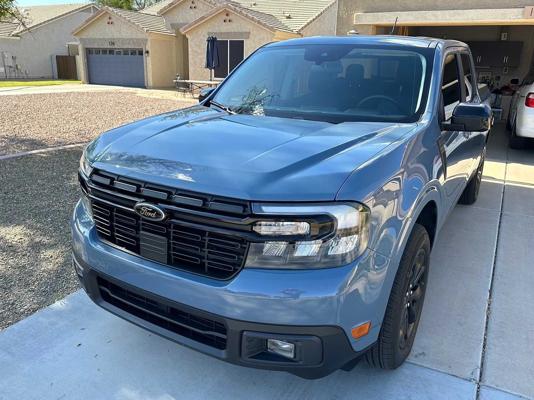

Hey all. I have tried to search this but I’m in need of new tires soon. I currently have the factory Michelins on that came with the truck and the BAP with 18” stock wheels. What’s the biggest tire size that won’t rub but will fill these wheel wells out a bit. I’m looking at another Michelin or possibly an A/T. Thanks in advance for the help. Here’s a pic of my truck as it sits now.

Nothing?

245' is the biggest you can go with no lift needed and no rubbing reported

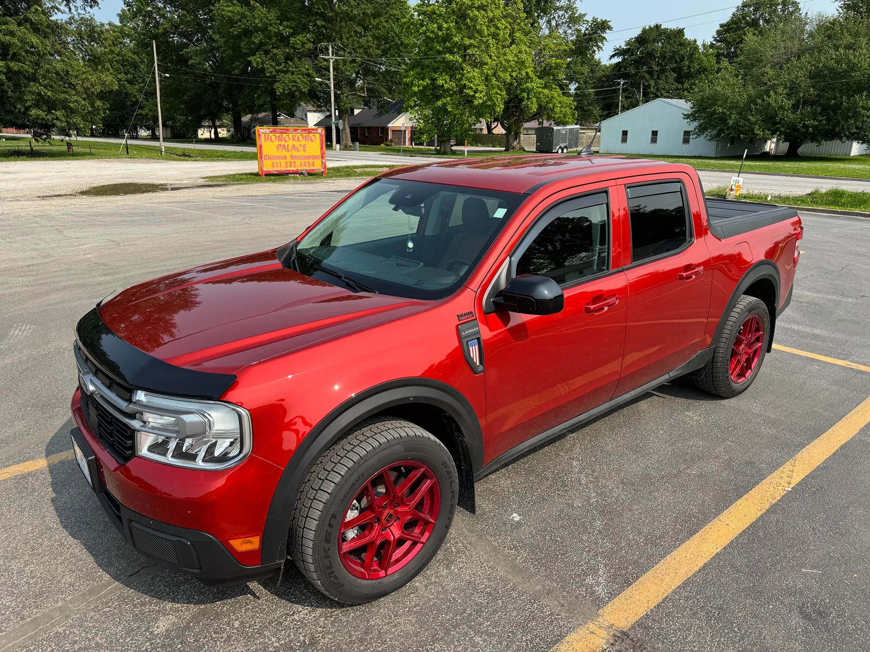

I’m running 255/55R18 on 18x8 with 35mm offset. Stock suspension. No rubbing. I don’t know how 7 inch rims would do.
