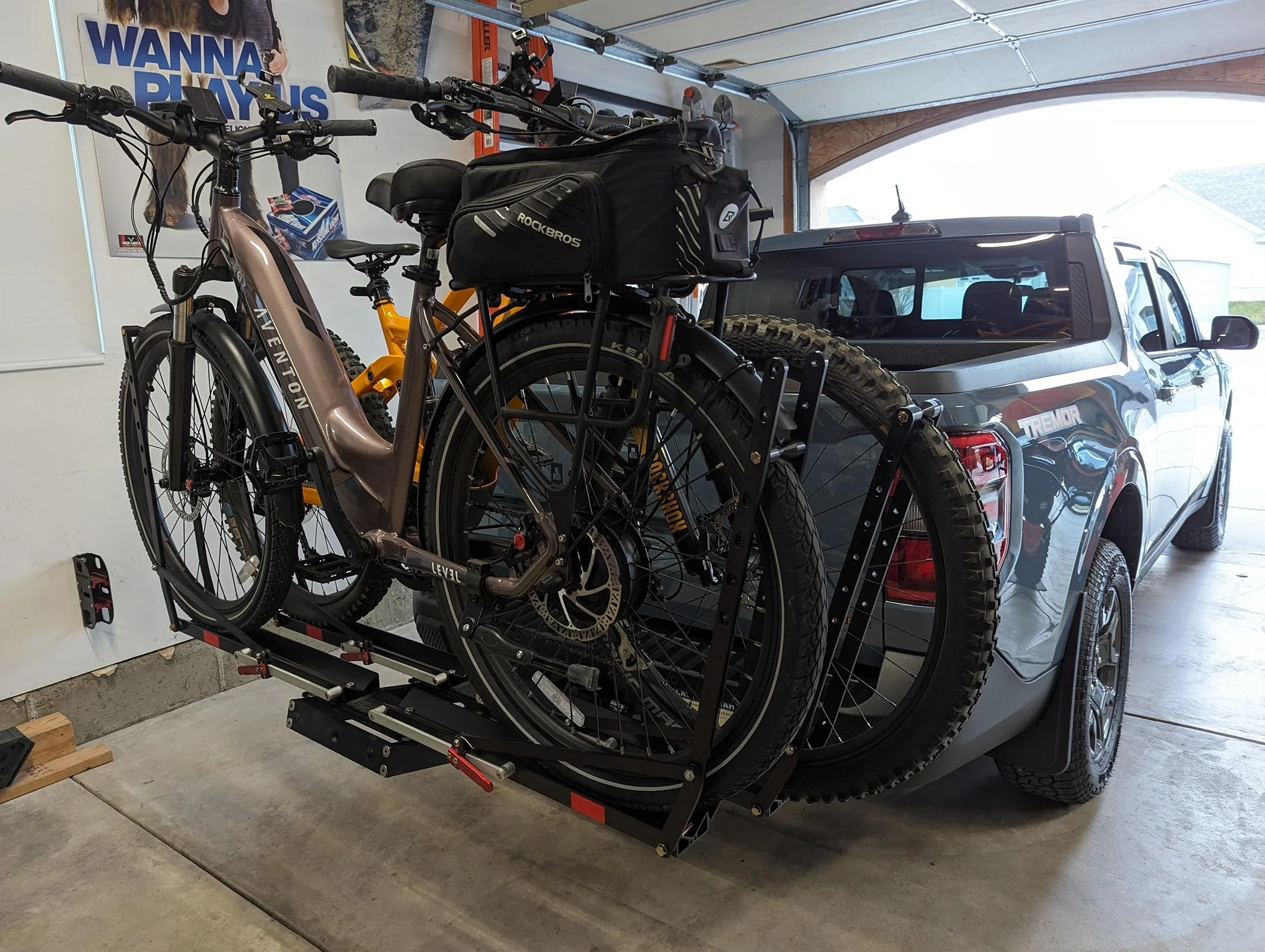

Ford Maverick 1up Heavy Duty Bike Rack - tailgate clearance without modification 1000094680
Take the bikes off, lower the arms, then the whole rack. Tailgate opens just fine.

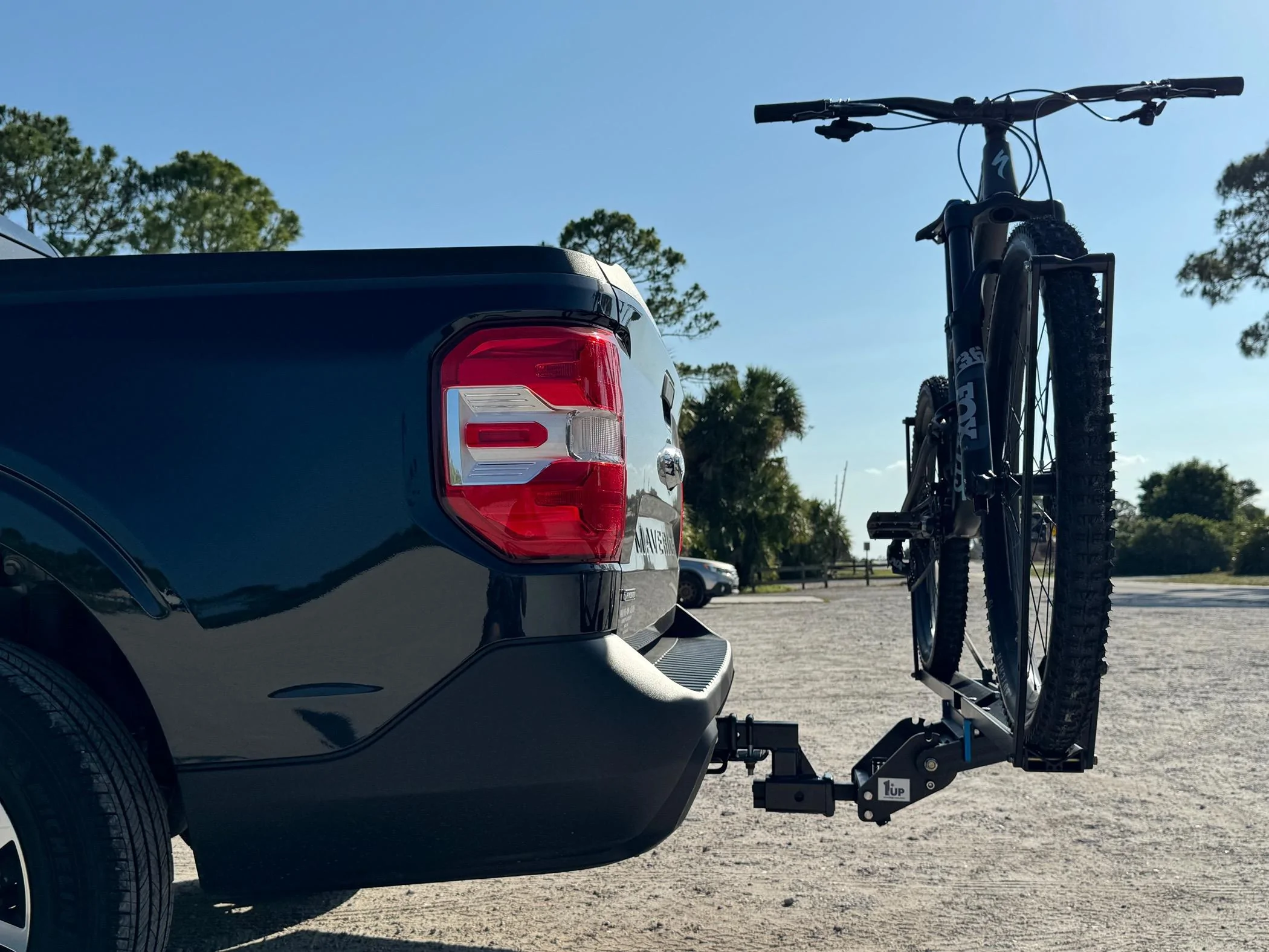

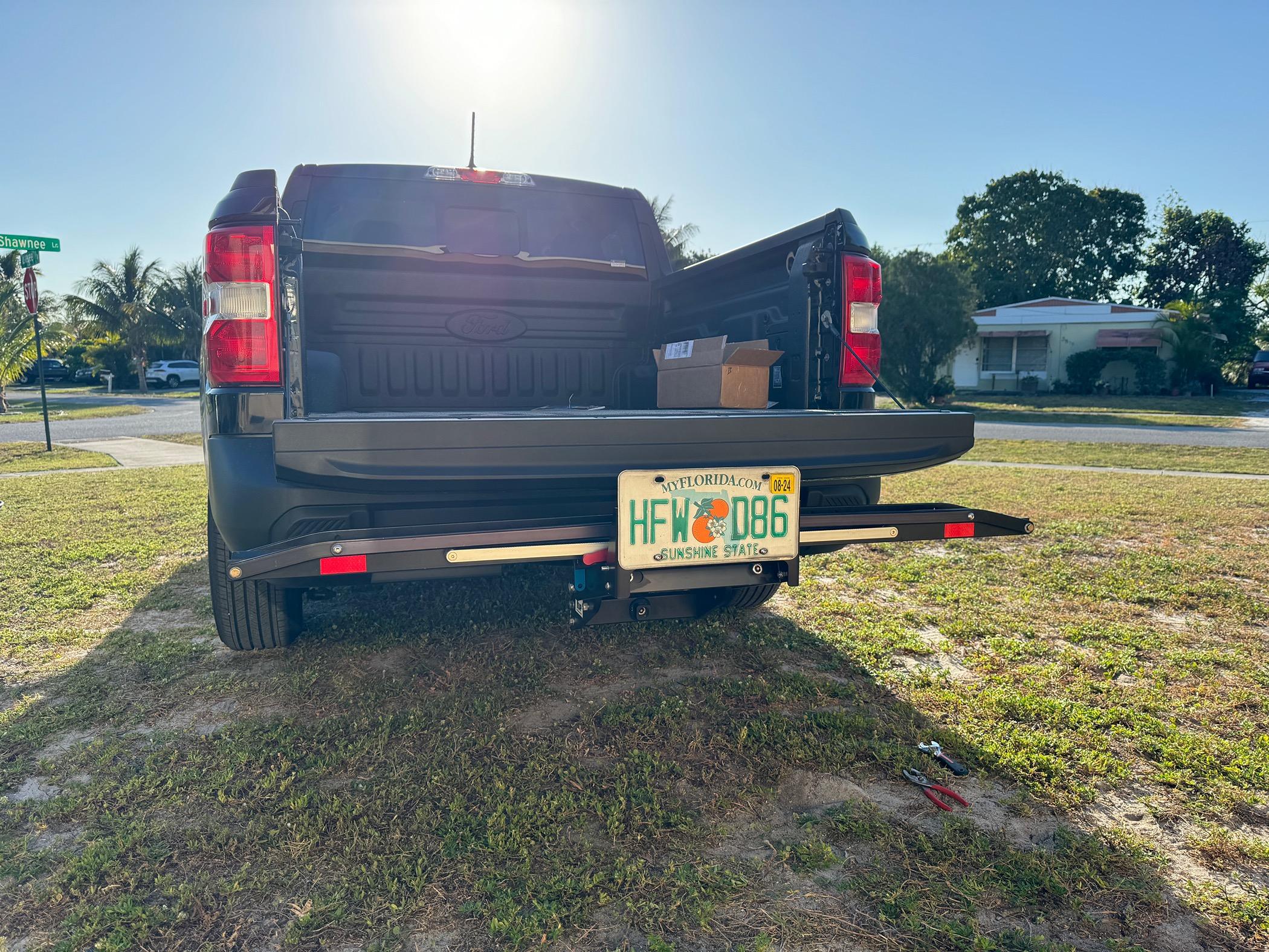

Less work to just add a height adaptor then to have to unscrew the handle lock screw on the 1-UP and then reach underneath to tilt down the arms to a 45 degree angle to get to the tailgate.
