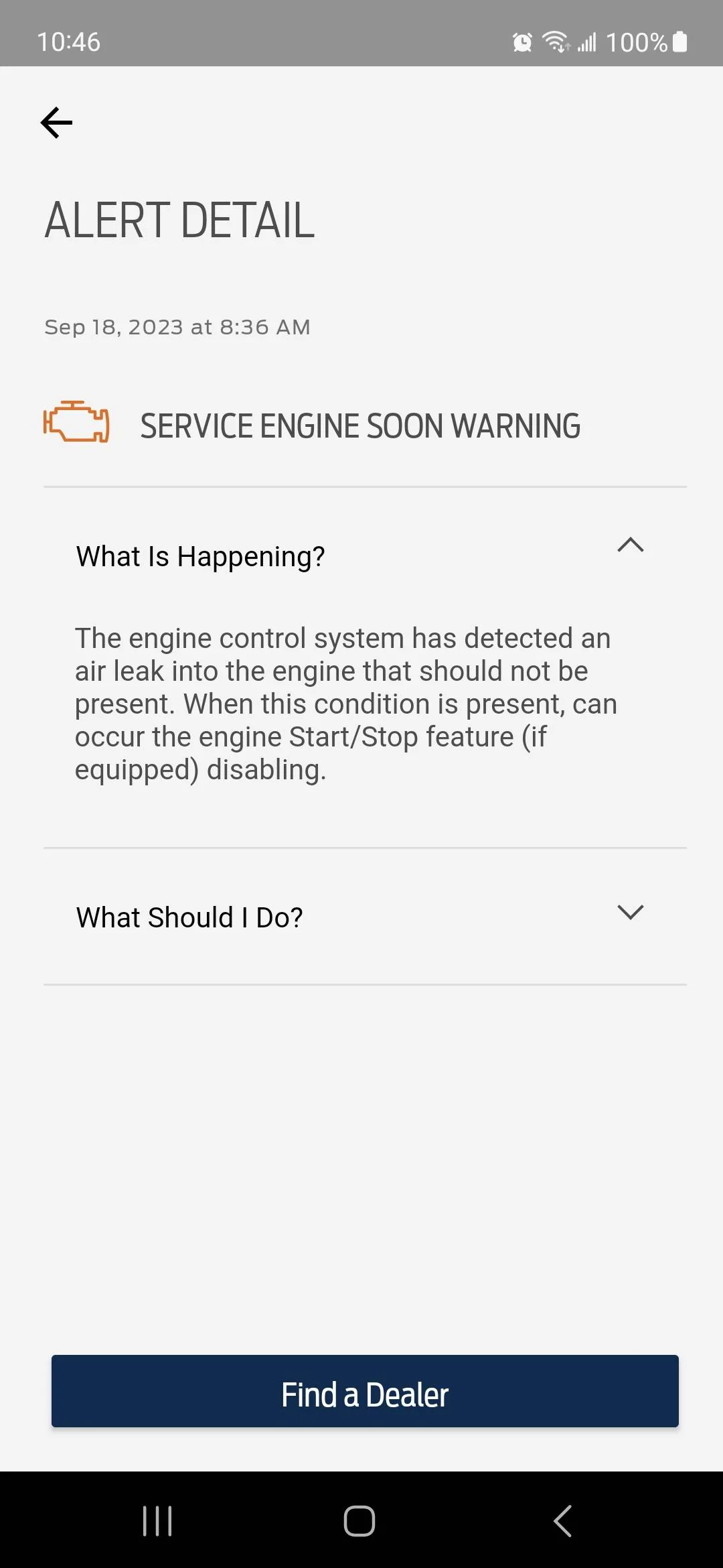

2 days after light came on dash I have this
Ford Maverick 1800 miles malfunction indicator light Ford pass report Green? Screenshot_20230918_224604_FordPass

What does the dealership say?

That's not an Evap code. More like an unmetered airflow code due to detecting a discrepancy between what the manifold pressure sensor and mass airflow are reporting or exhaust rich/lean balance.
This seems to be a common one on Hybrids built in the last year. Some reported their dealership found a loose/leaking hose on the engine, but nothing terribly specific about which.

Had 8AM appointment Weds. Code cleared today
To be continued LOL
