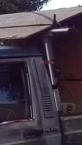

Here is a zoomed in crop of the tie down on my comanche, never mind the weird load. Its a plywood bed shade/rain protection on top of an oven I bought.
Ford Maverick Installed - Harbor Freight Universal Aluminum Truck Rack rack
Its a nice cleat type tie down but there are many others even ones at harbor freight.
Here is etrailer link for the one I have. Might have to do a little mod to make it work on yours. I would drill the holes through the posts, but drill them oversized and insert a sleeve so the post doesn't crush.
Track rack cleat
But yeah if you have them on both racks throw 2 straps over the top then triangulate staps to the bow and stern then that boat aint going nowhere. With the cleat style you can route the straps through the cleat then run it down to the bed tie downs to really stabilize the rack itself.
