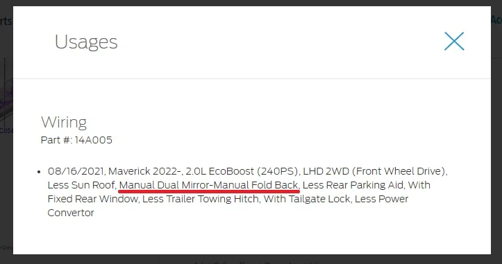

Unfortunately for you I plugged an XL no Copilot 360 VIN into the Ford Parts website and there is a main wiring harness specific for the XL without CP360 that has absolutely no power going to the mirrors so you couldn't even add the switch and wiring harnesses without replacing the entire main vehicle wiring harness. If you have your VIN I would plug it in at parts.ford.com and look up part# 14A005 and see what shows under the description for that part number.

Thank you so much for the info !!! I appreciate it !
I just looked up that part # from a local dealer......MSRP is $876----my price $2600 !! 🤔.... manual mirrors it is !! 😂🤣. Thanks for everyone helping out .
