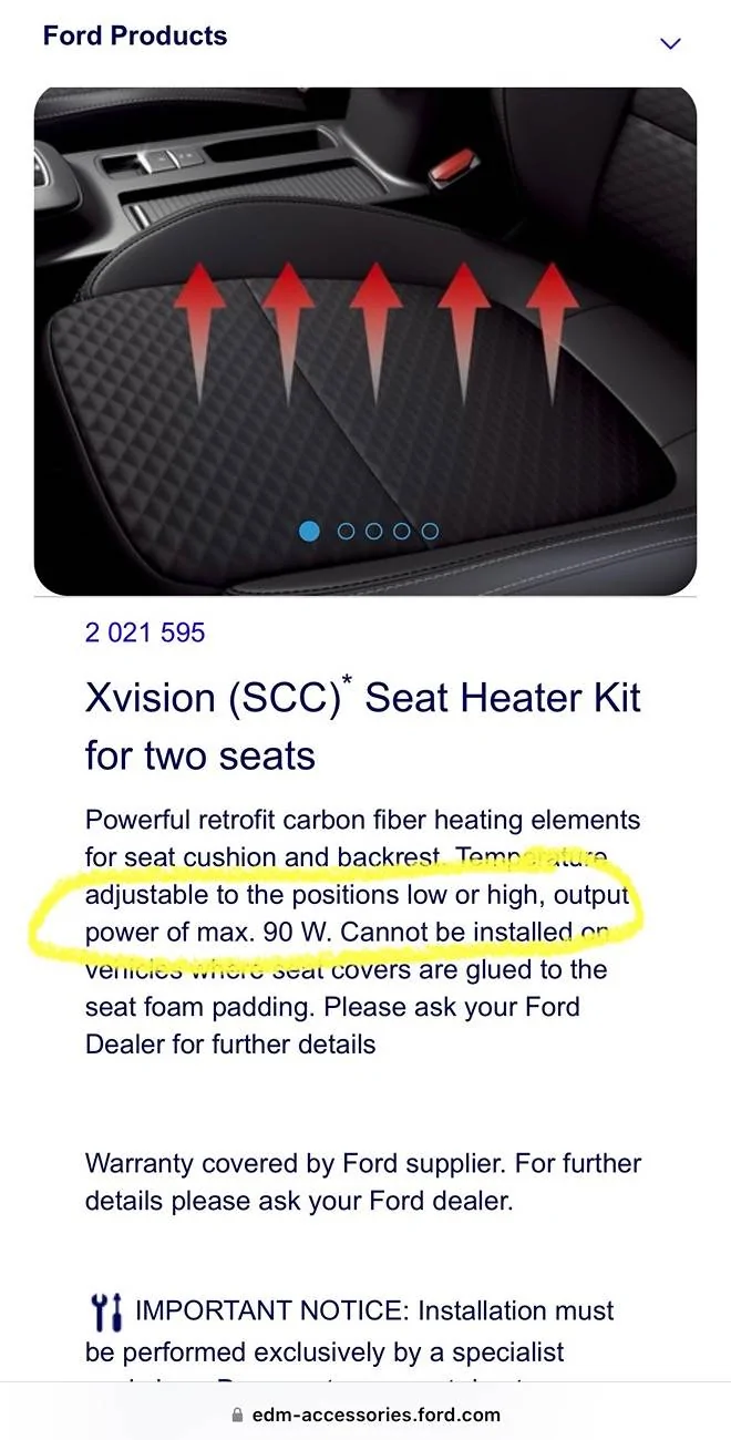

Ford Maverick Weird failure to start IMG_2100
Found the probable answer. Ford seat heaters in their parts catalog draw 90 watts each. That’s a 7.5 amp load and they use a 10 amp fuse. The fuse for the Maverick seat heaters is also 10 amps, making it a safe bet that the Maverick seat heaters are 90 watts.
