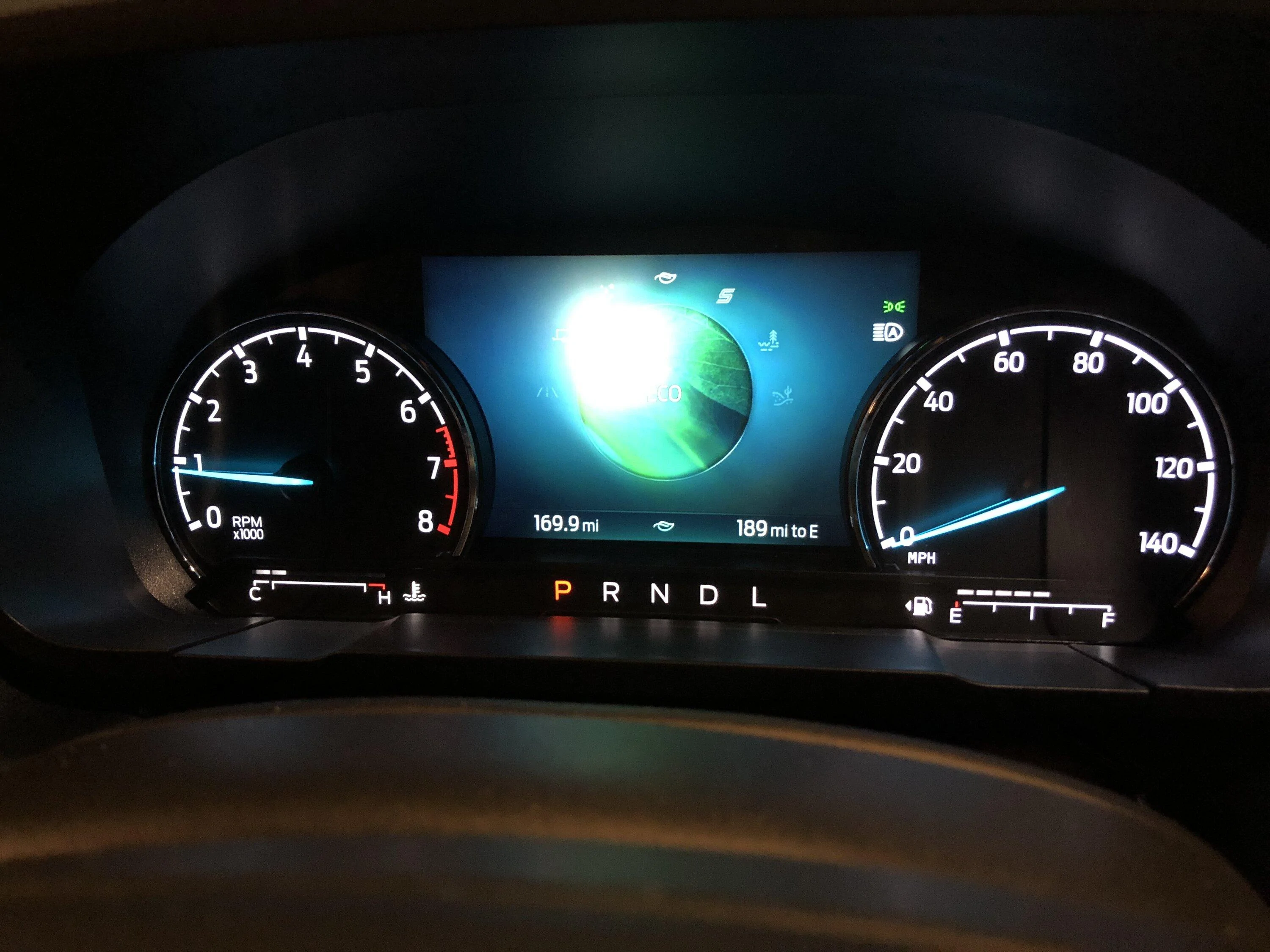

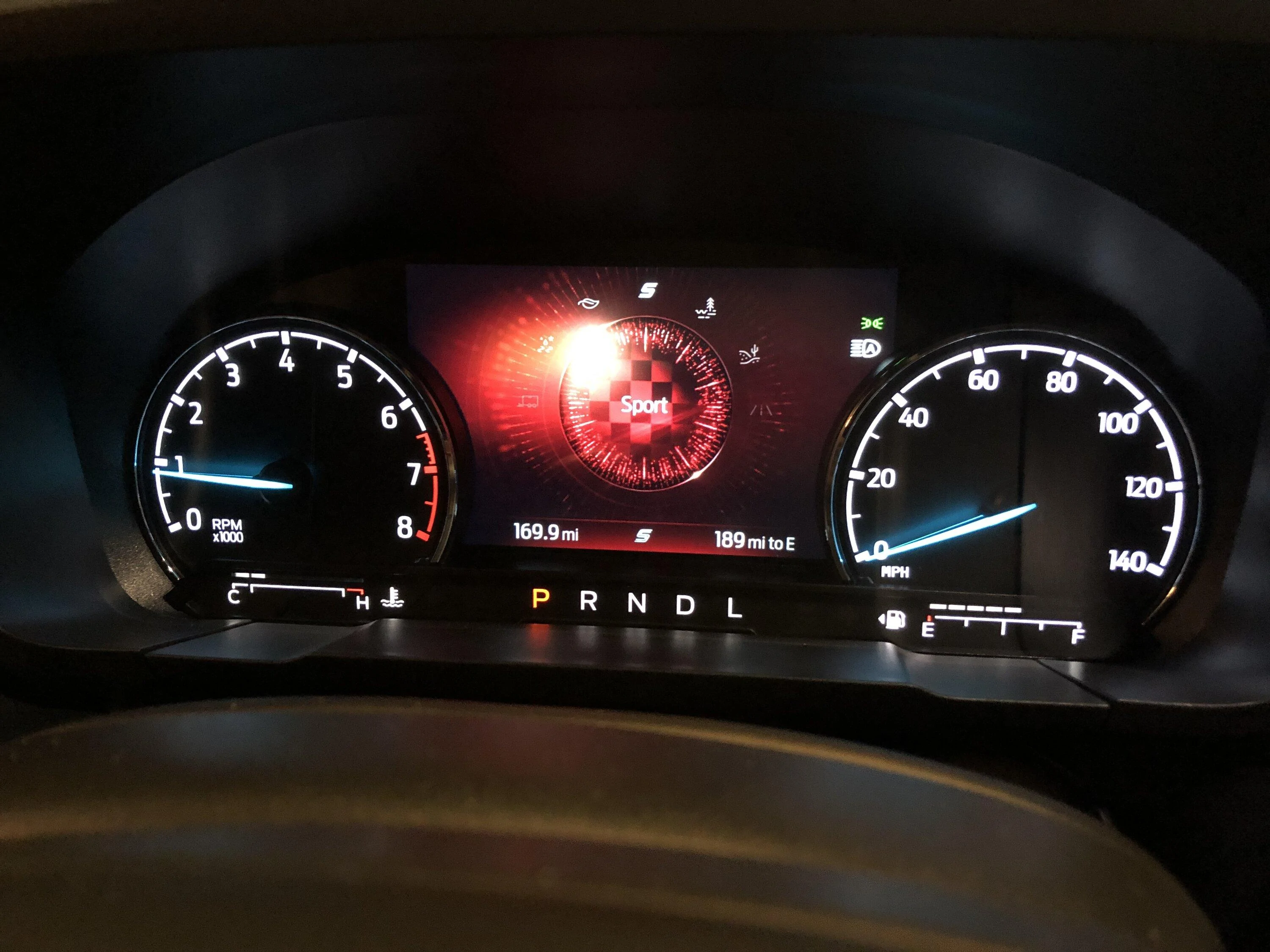

UPDATE: Thanks to @Maverick2022XL for the advice. It was really as simple as that. Highlight the ABS Module and then click on the "play" button on the bottom the screen to get to the configuration tab where you can change the settings.
I have successfully added Eco and Sport modes to my FX4 and also updated the tire size to 235/65/17 to get within one size of the 245/65/17s I installed on my truck.
Many thanks to the knowledgeable folks in this Maverick community. The MTC is truly a blessing.
Ford Maverick UPDATE: PROBLEM SOLVED — Trying to Configure ABS Module with Forscan IMG_8447
Ford Maverick UPDATE: PROBLEM SOLVED — Trying to Configure ABS Module with Forscan IMG_8448
