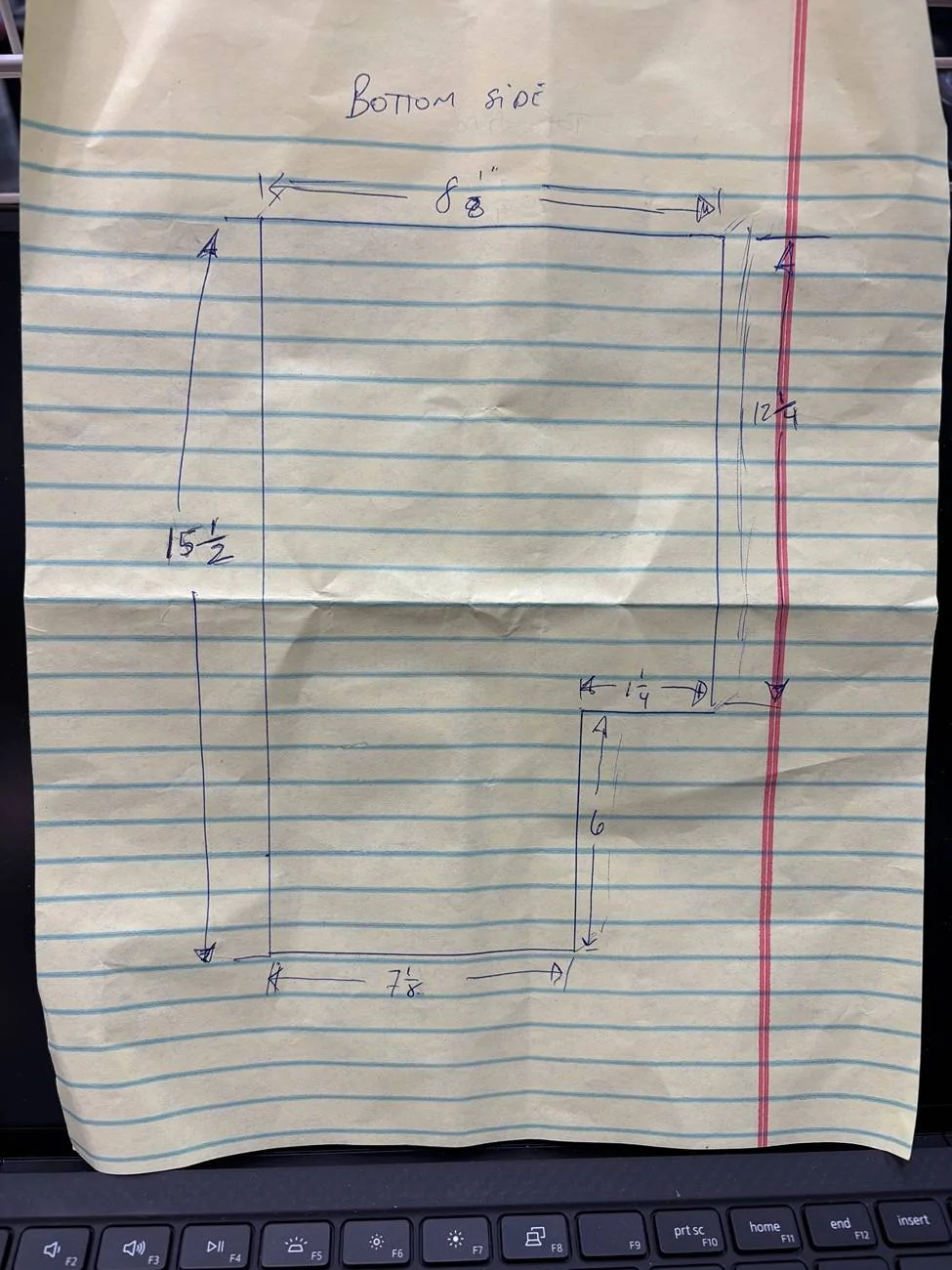

If I was to get a box made for some 10” subs what would i tell the carpenter, i measured roughly 19x12x8.5” but with the lip on the outside corner how would i measure it?

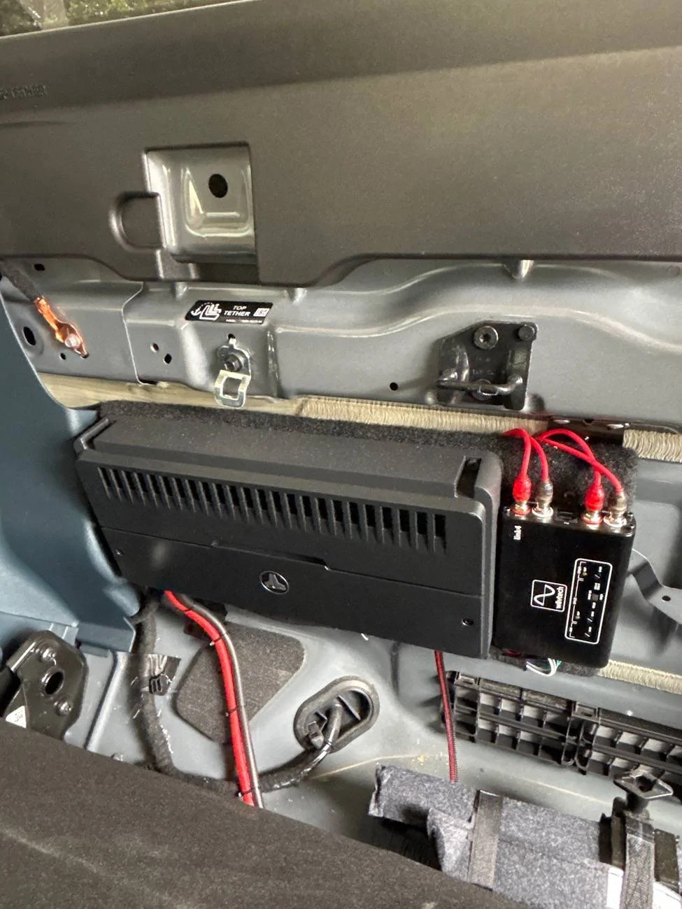

10” JL Audio sub in a Ground-Shaker box made for the Maverick

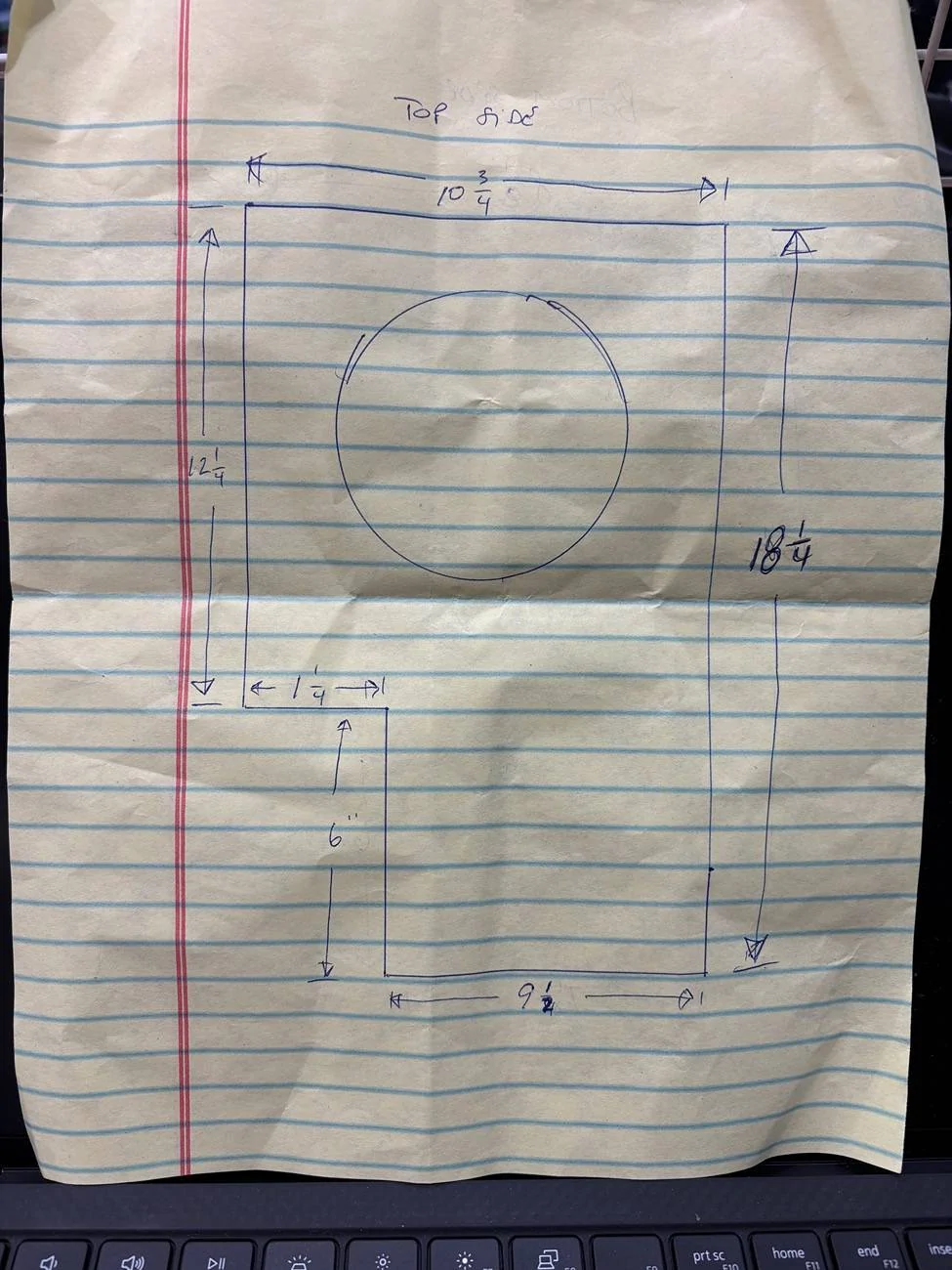

Here are the dimensions from my Ground-Shaker box for a 10” sub. As you can see from the top and bottom dimensions, the box is angled to fit the space.
I took photos and can send those if your carpenter prefers that.
Hope this helps

Forgot to mention that the box is 7-1/2” in height

Dude you have no idea how much this has saved me lmao
