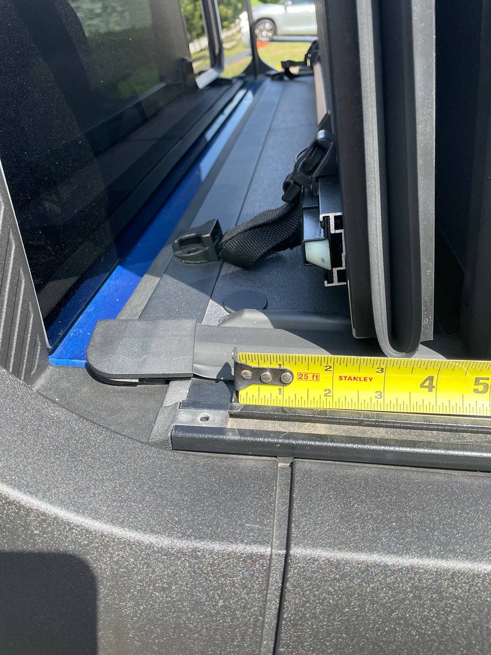

Welcome to MTC. No sure if this will help or confuse, I have the TS rails with a BakFlip MX4 cover, there is just over 2" of exposed rail/track forward of the flipped-up cover. If Back Rack can offer brackets that can bolt down on top of the rails here, maybe you can make it work. Plus, you could lose the trim piece at the forward edge of the rails, and gain another inch of track.

Thanks for the welcome and your advice and illustration.
Ive seen that Back Rack offers adapter shim blocks for tonneau applications. Wondering how “clunky” the back rack would look and if any members have gone this route.

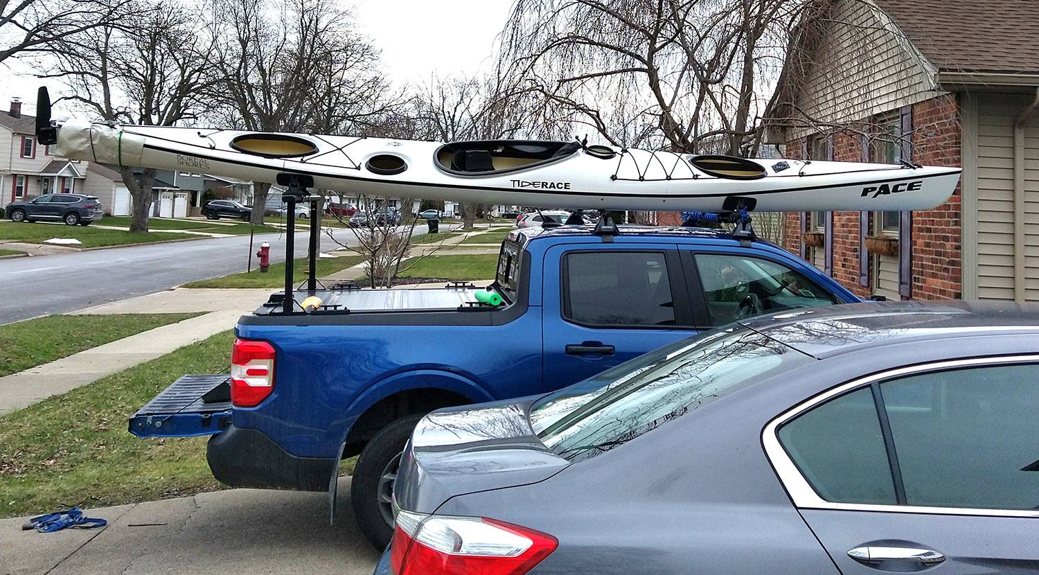

The roof bars are Yakima Baseline . I had them from my last vehicle just needed new Clip Kit as each car model has its own clip kit. They are not cheap as they are sold in pairs but you really only need one cab cross bar and one bed cross bar. If you can find the Baseline FEET from Yakima USED then order a clip kit and can find either ONE cross bar or order a pair of new bars to save you money. as opposed to buying the whole kit outright. If you really want to go this route I can give links to the exact Tnutz upright bars you would need for the bed cross bar. . You still need to buy the Elevate Rails about 300 bucks. The Tnutz parts about if i remember correctly about 60 bucks. Or if you read through thread i posted just make TWO bed cross bars as that would be the least expensive but then the bars are not very far apart.
I have the Gator FX Tri fold hard cover. Works well with the elevate rails which I added later on about 6 months after I first installed the Gator FX . Fairly water tight. Hard rain I get a little water back by tailgate.
