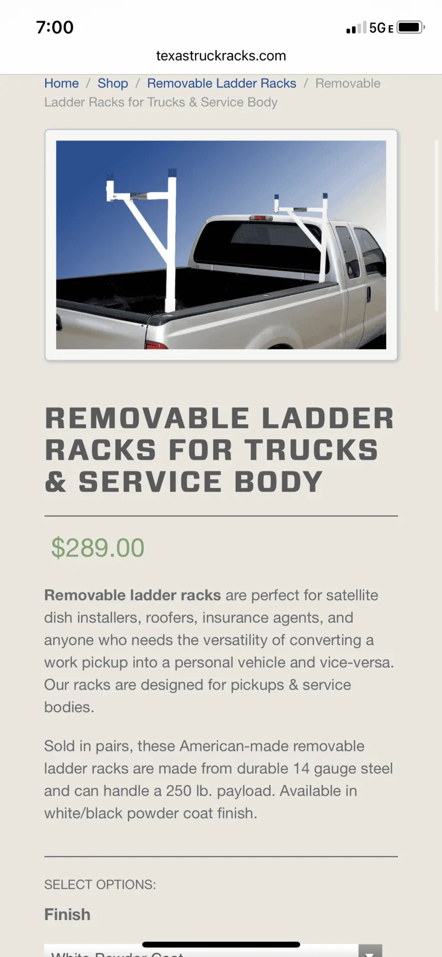

Ok, not unworkable, I don't think. Are PT 6x6 the really wet rough sawn. If you have one handy let me know how many inches long it is and the weight it is. Find one that is the heaviest you think you will have. Same with worst case 2x4's. I will check other things. I will check trailer options also.
According to weight charts freshly treated 5.5"x5.5" SYP will be 15.33 lbs/lineal ft and 8.61 lbs/Lin ft for air dried. So 6 freshly = 1471.68lbs so maybe 2 on roof and bed racks combined (one on each side of truck). Considerably more if rough sawn.

Maybe 4 if 230 each and get 2/3 weight on bed racks. May need to stiff leg op from hitch receiver just behind open distance of tailgate.
