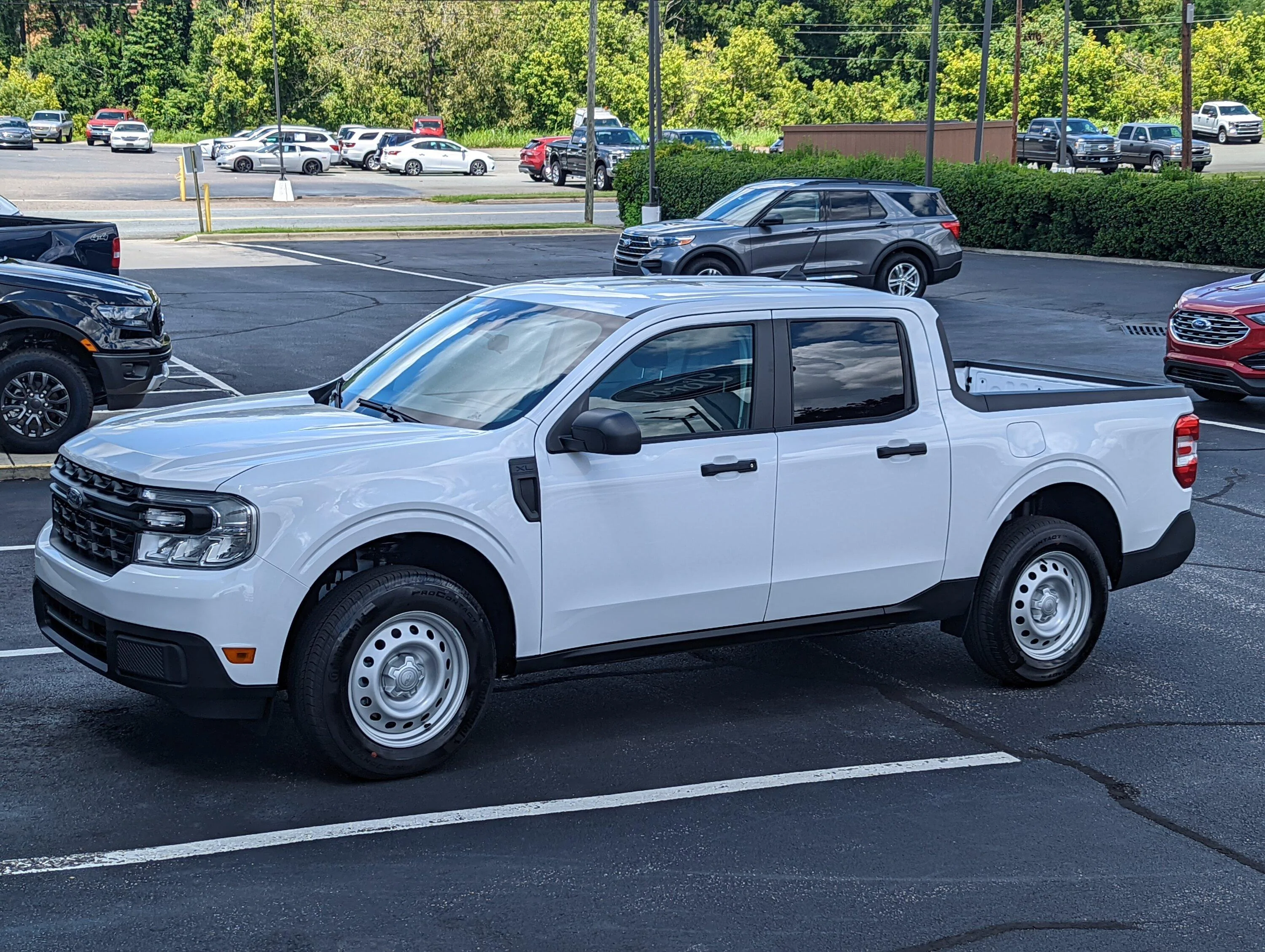

Intend to use this XL as a residential HVAC service vehicle. I will need to carry a 8' & 6' ladder as well as all my equipment, tools, truck stock ect. I'd prefer a hard tool shell honestly but have no idea when / if they are coming to market. I will need to be able to lock the bed tonneau to protect valuable tools. Is there a situation for this? Also feel like a hard tool shell weight would have to be very low in order to not hit the 1500 lb limit with all my equipment.
