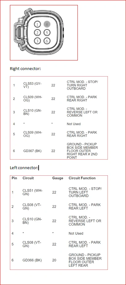

Howdy, I’m wiring in a under-tailgate light strip that has running, stop, turn, and backup functions and wondering if anyone has a wiring diagram for the tail light connector plugs that has wire colors/function. Tried using a voltmeter to figure it out with mixed results.

Figured it out:
I'm adding a tailgate light bar as well using the Curt Wiring harness and a Putco Blade tailgate light bar. From this diagram, it looks like you tap / splice into the wire on the LEFT side tail light that is in position 3. Am I interpreting that properly? Thanks!
