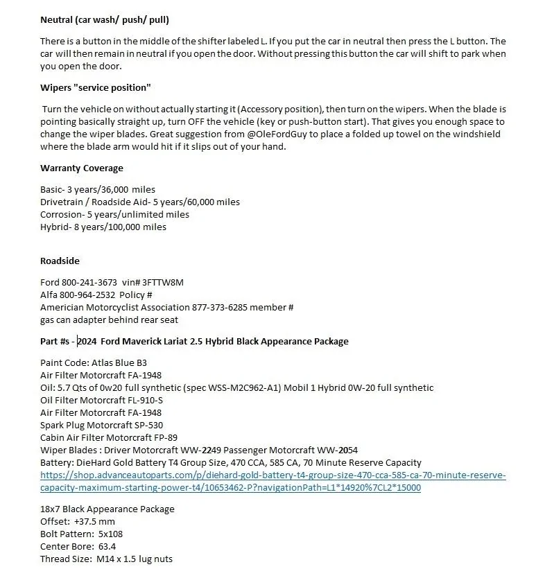

(Edited incorporating your ideas) I'm making a cheat sheet to keep in the glove box, any suggestions?
Edited incorporating your ideas thanks!

I would add phone numbers for you Insurance agent, Doctor, lawyer, and any other important person that you might not remember their phone number in case something happens and you don't have access to your phone with that info on it.
