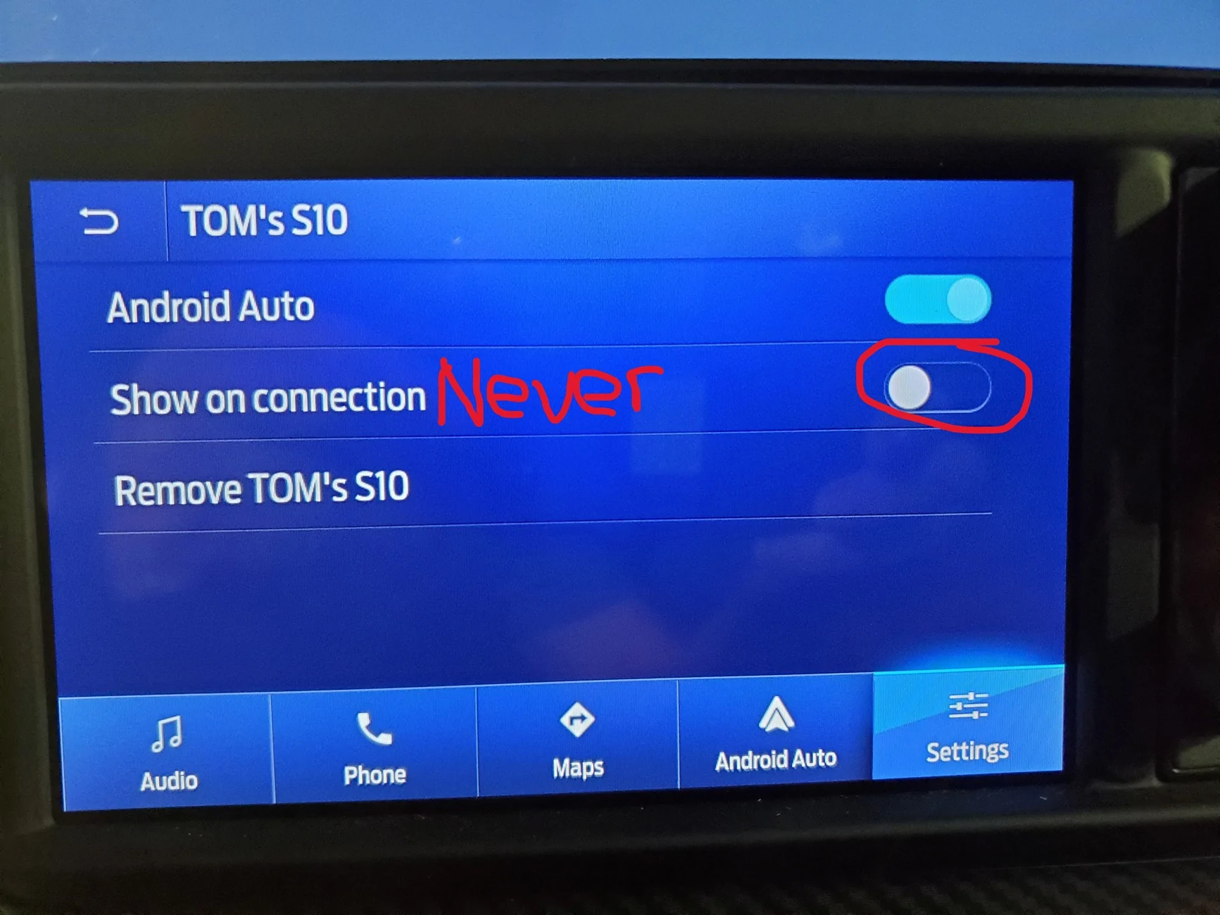

There Is a setting on the truck for this, at least on Sync 3.
Settings/Android Auto/Select your phone then uncheck "Show on Connection."
Android auto won't start unless you select it, at least on mine.

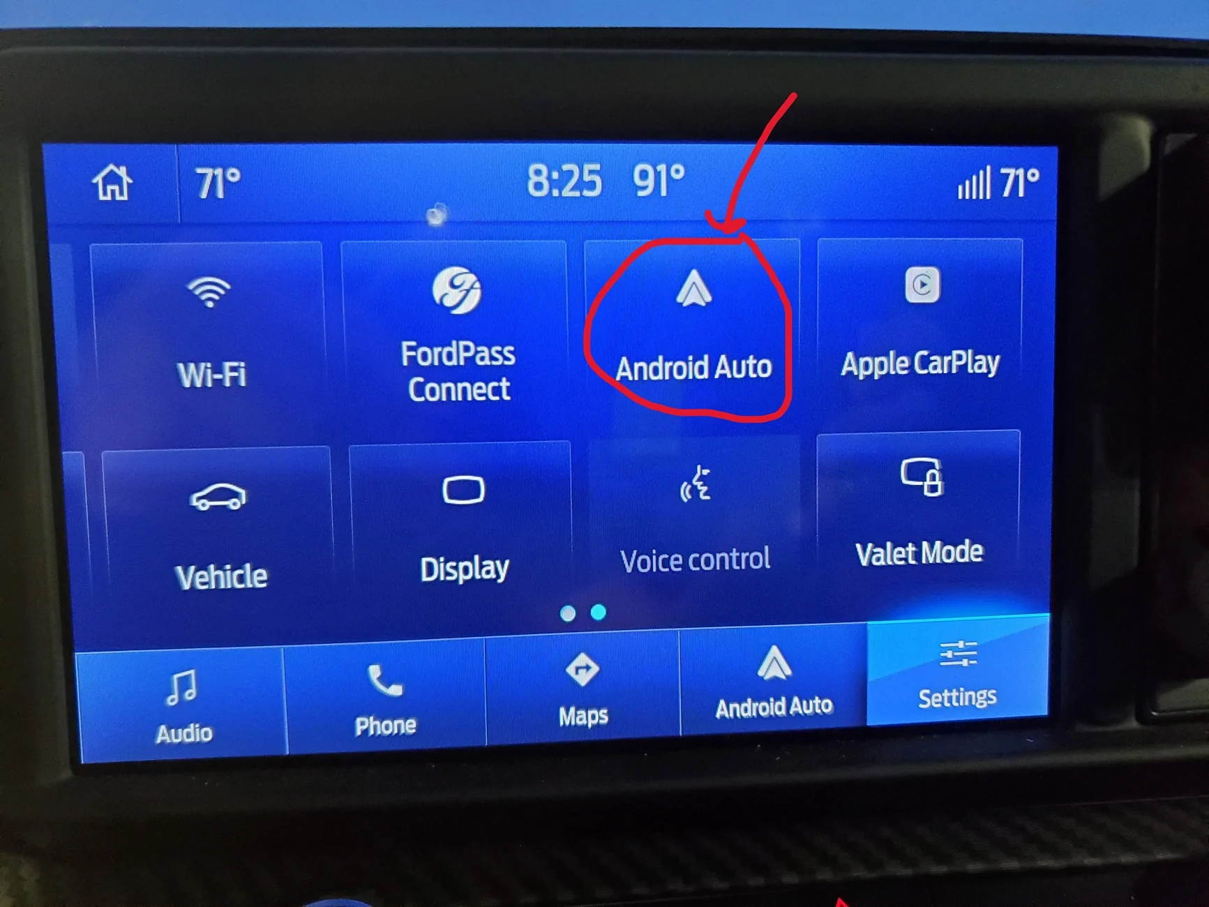

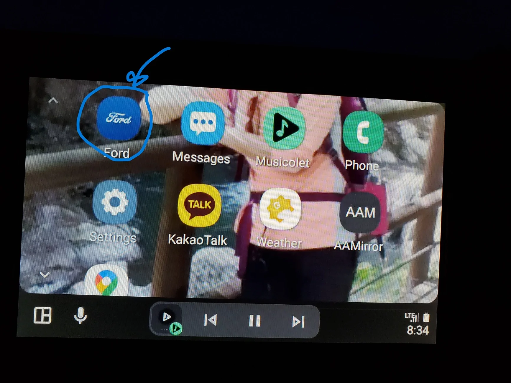

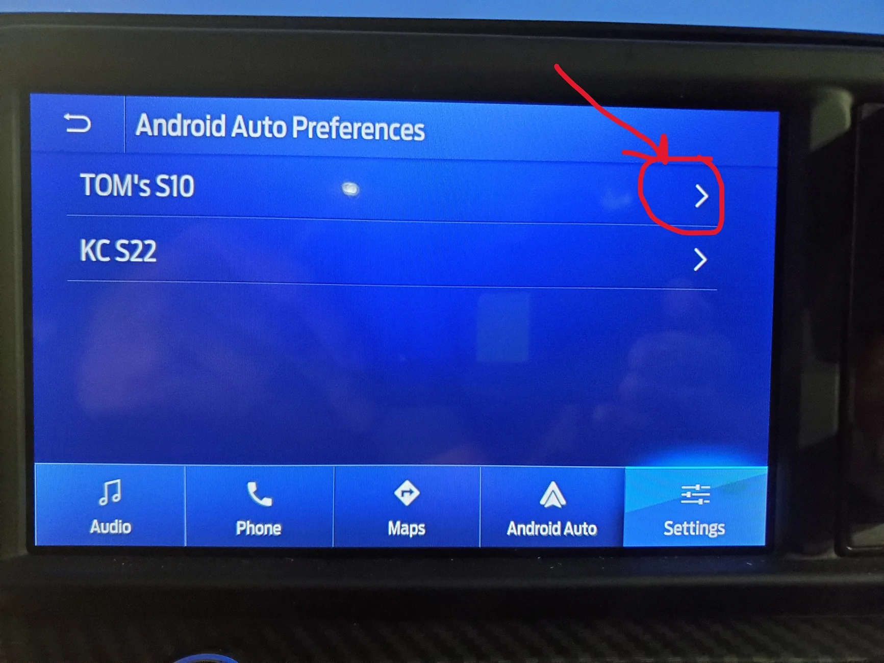

What 👍 said, but with more pictures. Since without pictures, it didn't happen. Pictures, always more pictures. :crackup: My ALWAYS I guess would be Auto, and NEVER would be Manually. FYI: MY24 Lariat Hybrid w/Sync 3.
Ford Maverick Stop Android Auto from starting automatically. Pic-1
Ford Maverick Stop Android Auto from starting automatically. Pic-2
Ford Maverick Stop Android Auto from starting automatically. Pic-3
Ford Maverick Stop Android Auto from starting automatically. Pic-4
Ford Maverick Stop Android Auto from starting automatically. Pic-5
Ford Maverick Stop Android Auto from starting automatically. Pic-6

Wow Perfect thank you

I did try this and it works exactly like I want it too.
I was looking in the wrong settings page. Appreciate everyone's effort with all the pics!
