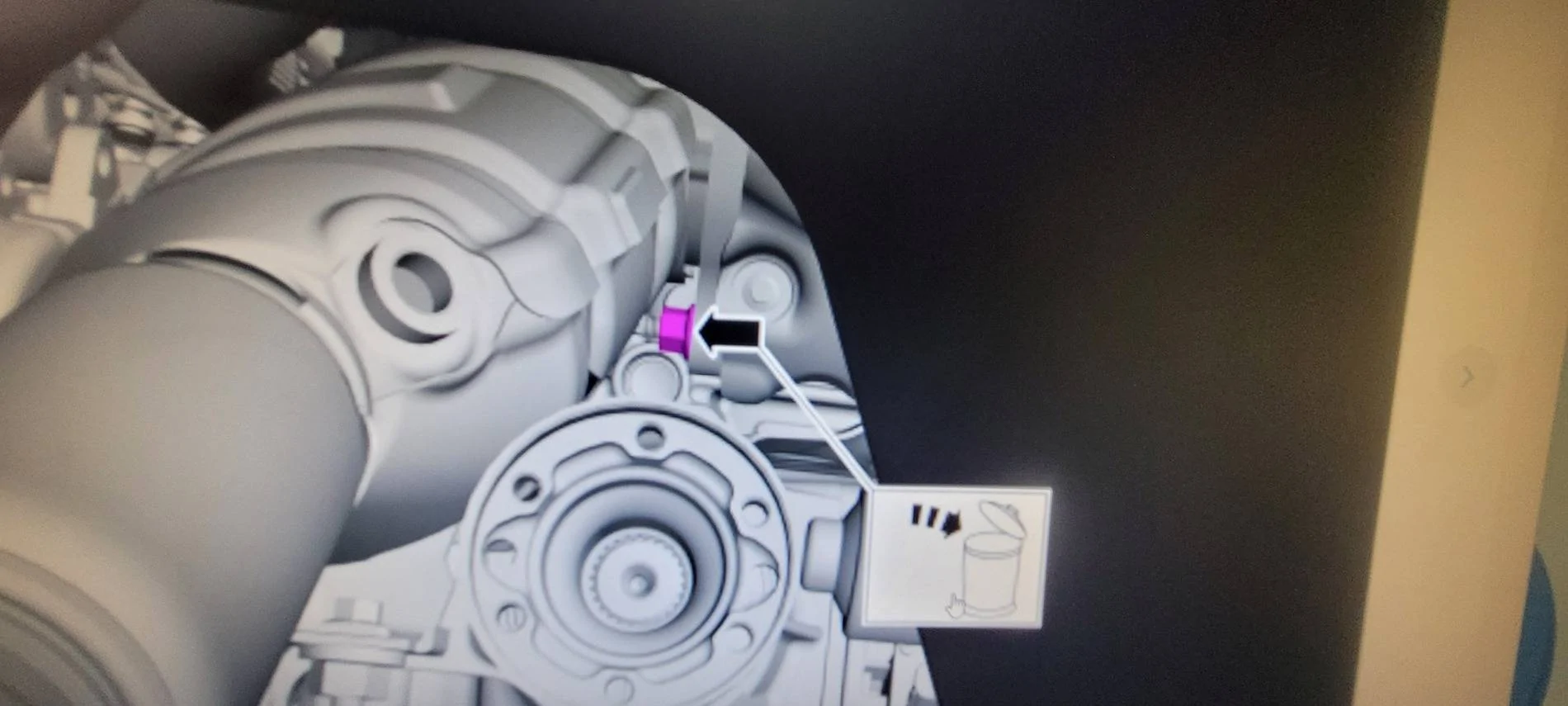

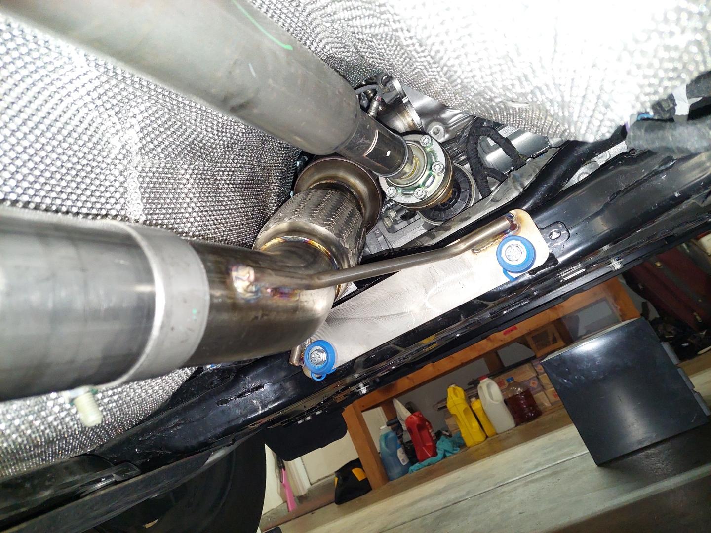

Did you get to the bottom bolt from the top? Oh where at from the bottom. I've been looking for that damn nut since last night and can't see or feel it. I'm utterly lost lol

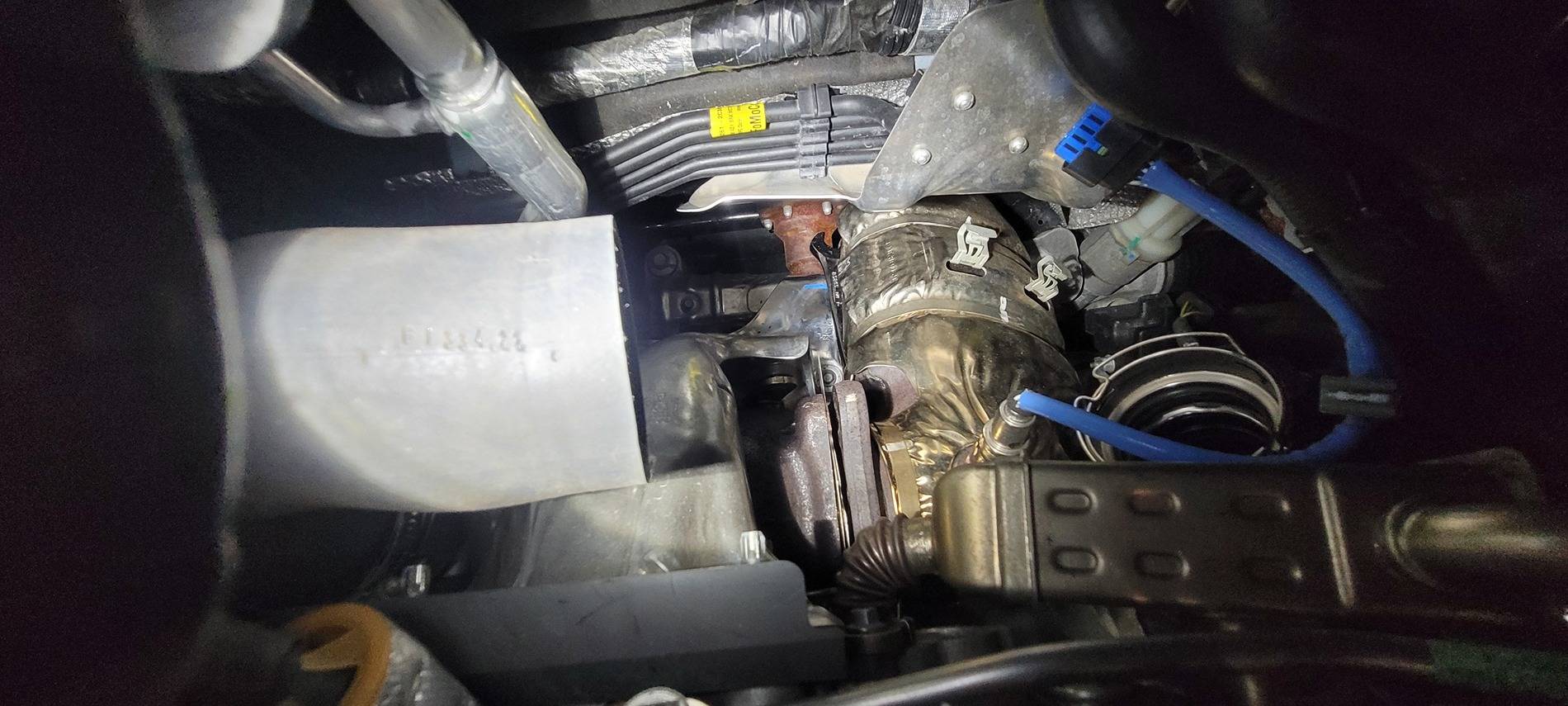

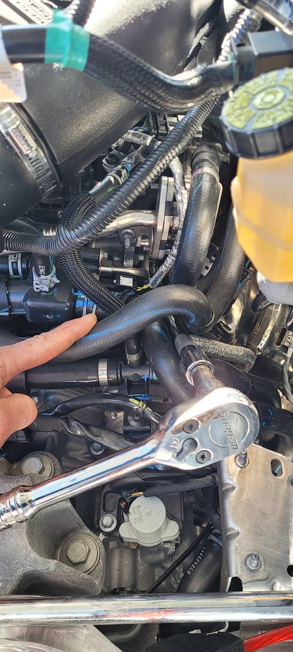

These are the 3 bolts and how i got to them that hold the dp to the turbo. 2 from the top, 1 from the bottom
GEARWRENCH 15mm 120XP™ Universal Spline XL GearBox Flex Head Ratcheting Wrench - 86115 https://a.co/d/dBQ29OP
I actually bought this wrench to do it instead of making a super long one out of one of my nice ratcheting wrenches lol
Did you remove the battery to get access for the top bolts?

Did anyone remove the drive shaft??
I can't seem to get to the bottom bolt. The top two can be accessed from the top but bottom one I can't get to even with the special ratcheting wrench that was linked in this thread.
So pissed.

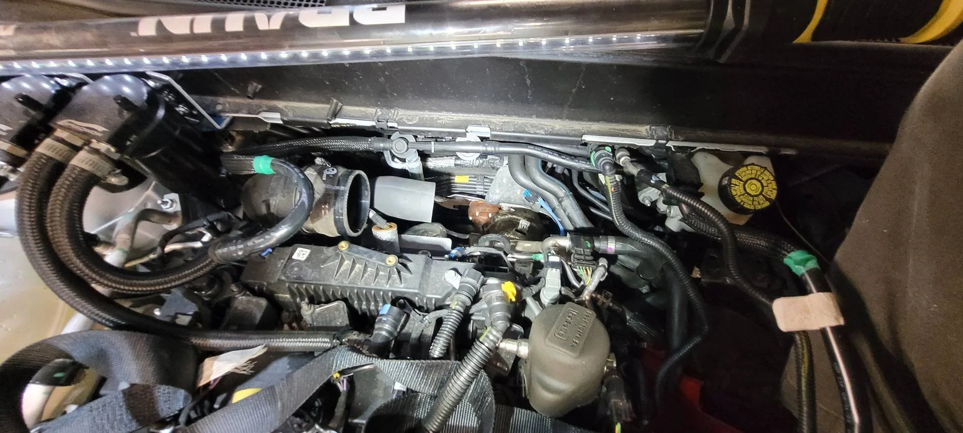

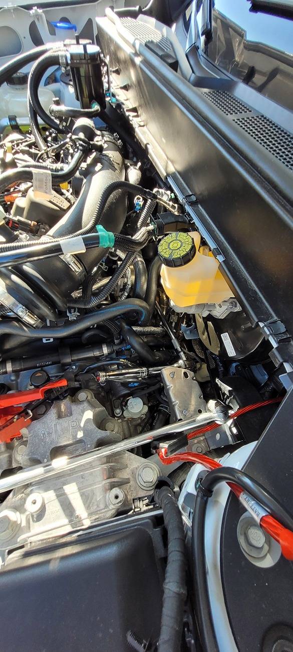

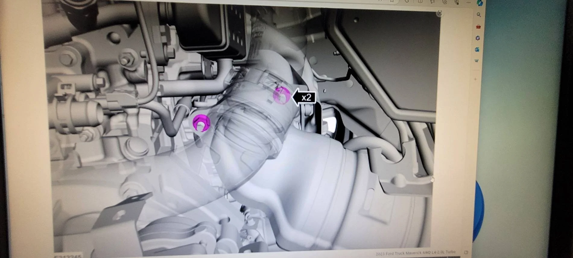

On my second install I was actually able to get all 3 bolts from the top, pics were hard to take but with the intake out you can actually get decent leverage on a wrench from the top
Ford Maverick Stainless works downpipe installed PLUS SOUNDS 20250213_112551
Ford Maverick Stainless works downpipe installed PLUS SOUNDS 20250213_112544
What!?!? No way!?!?
Even the bottom bolt you got from the top???
How the hell man lol.

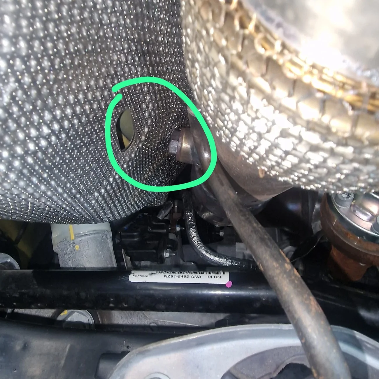

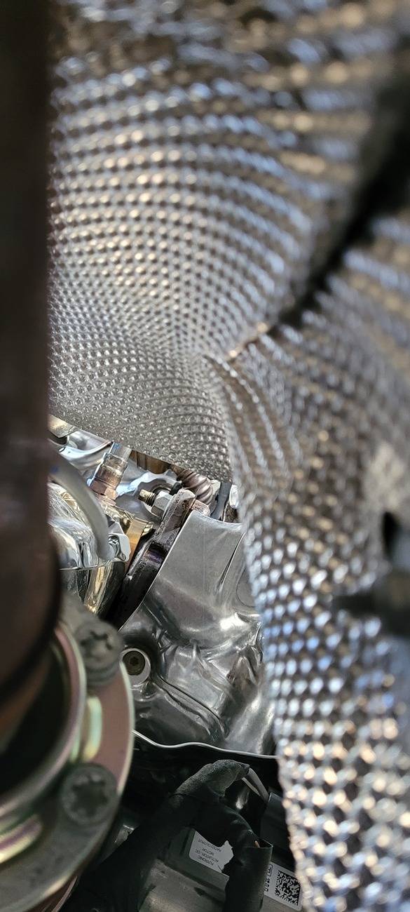

Lol, this was an oem cat I installed a prototype once, re installed oem then installed the finished product so 3 installs 2 removals I circled where I had the wrench in my terrible pic

How were you able to install the o2 Sensor? We can't seem to figure out how people are doing it on the Fast Mav Downpipe since there doesn't seem to be any room between the DP and the heat shroud....
Ford Maverick Stainless works downpipe installed PLUS SOUNDS Fast Maverick Down Pi
