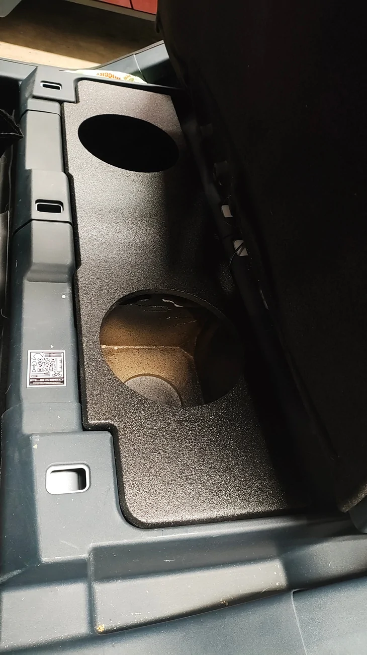

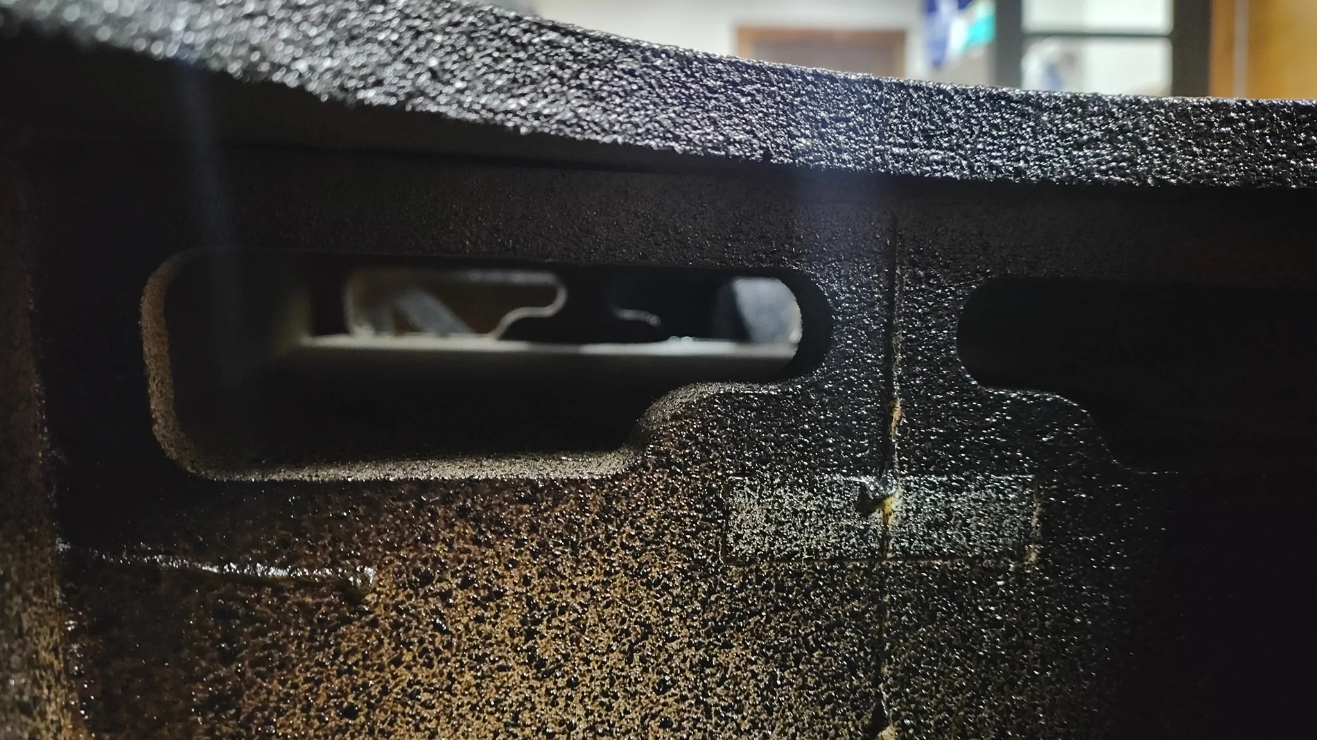

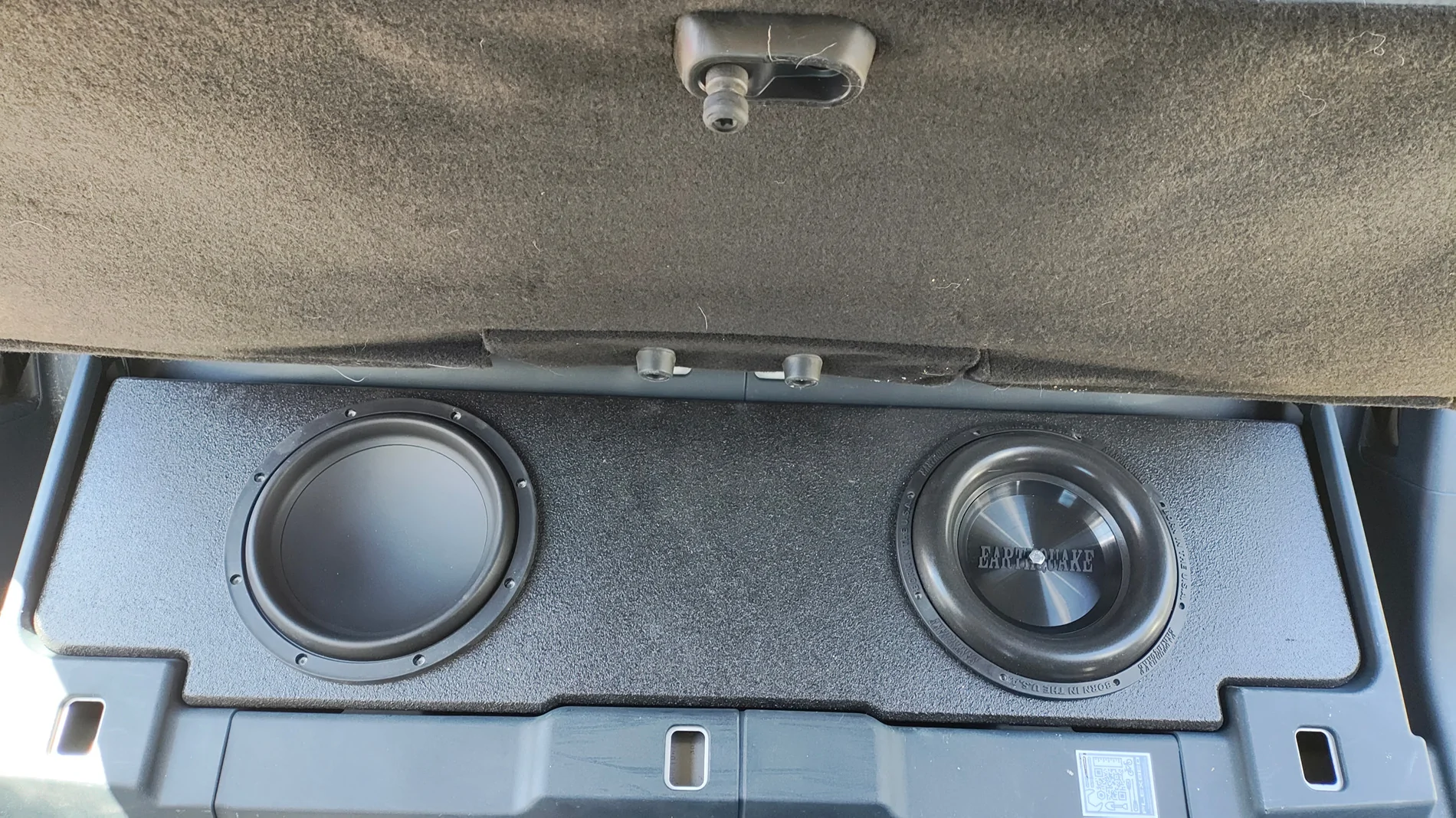

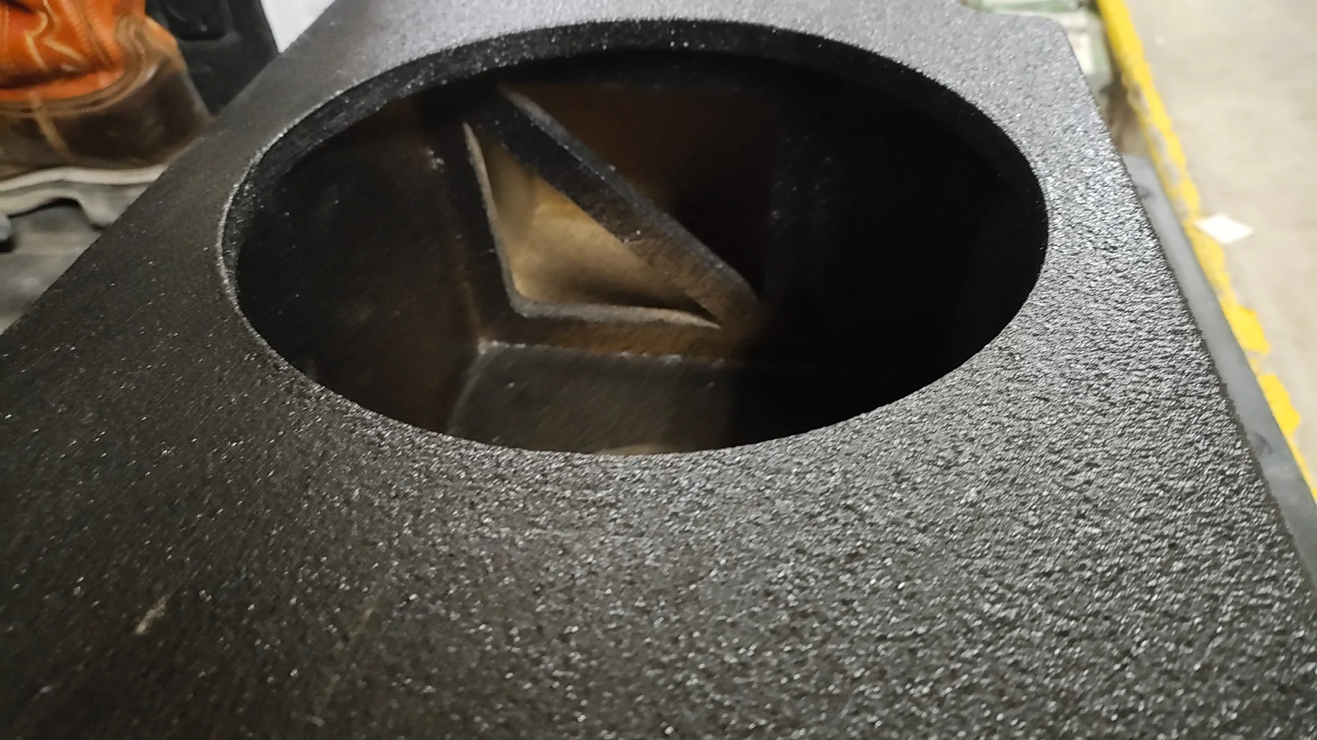

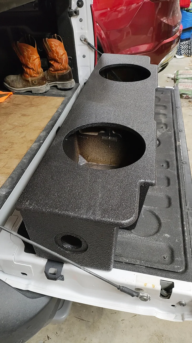

I installed this box this past weekend. Fits like a glove. No squeaks or rattles. Fit and finish are nice. Coated in a black bedliner type material. Paid $400 + $35 shipped. Seems to be the best value I could find for two subs. They are up in Wisconsin but it shipped from Killeen, TX. Their guy builds them to order and it took about 3.5 weeks with FedEx delivery from purchase.

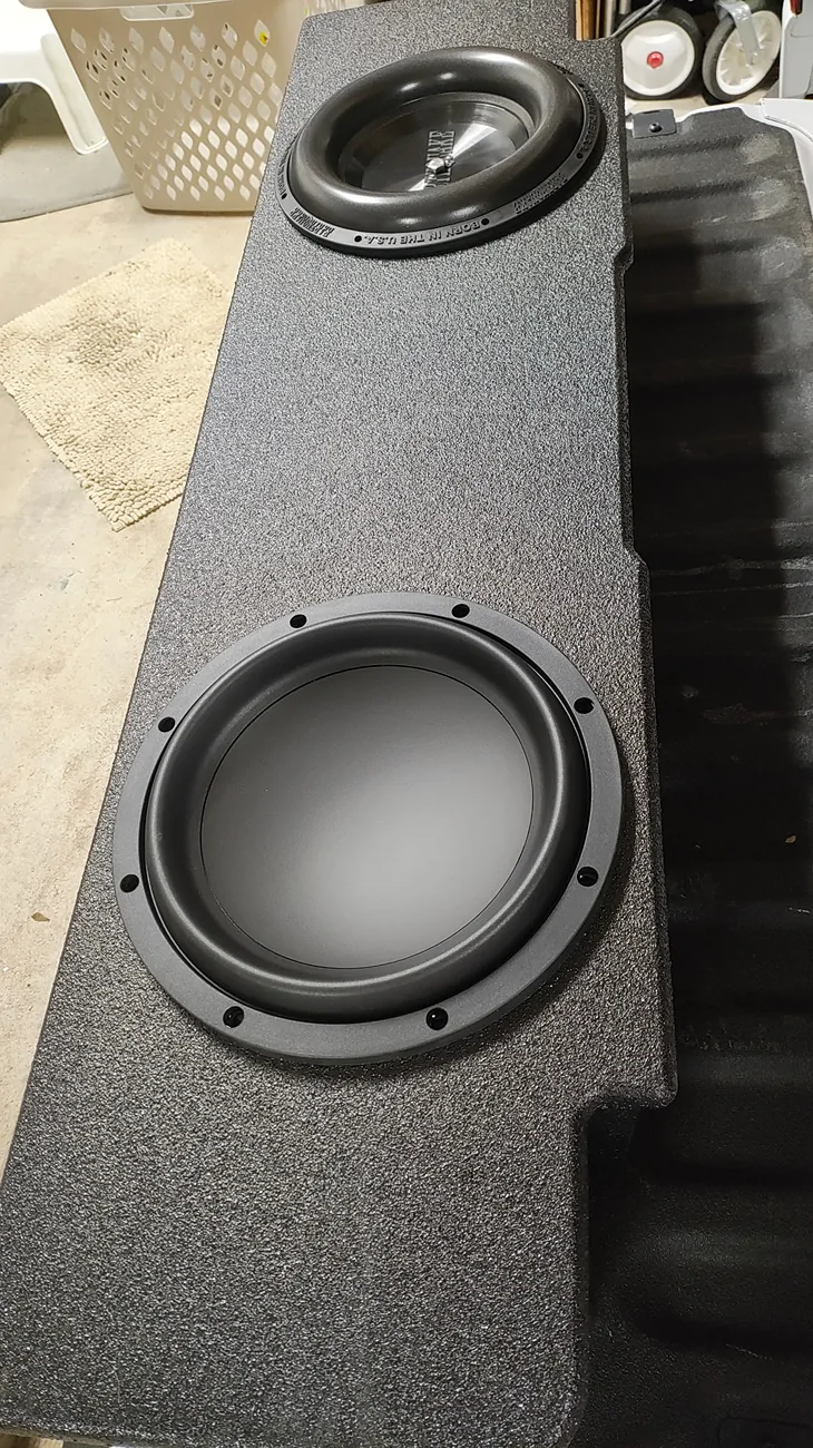

Running a 10" Dayton audio MX10-22 Sub with an earthquake slaps M10 passive radiator (with stock 266g of mass). Wired to 4 ohms and powered by the stock B&O amp. Sounds good for my taste.
1 cuft and both speakers share the same air space.
