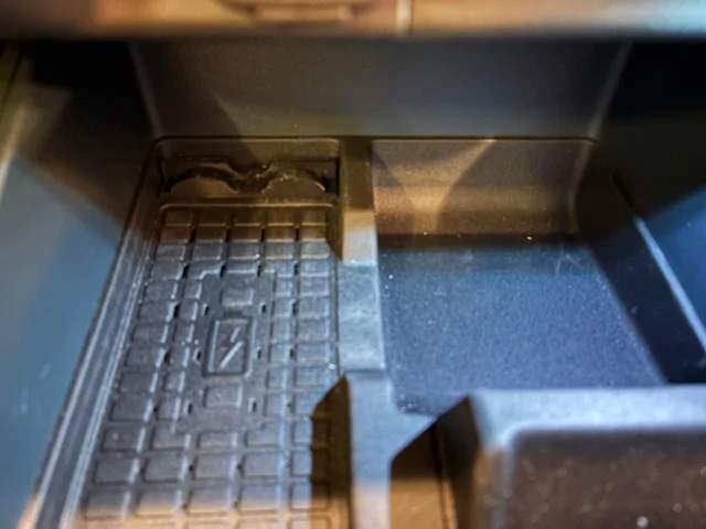

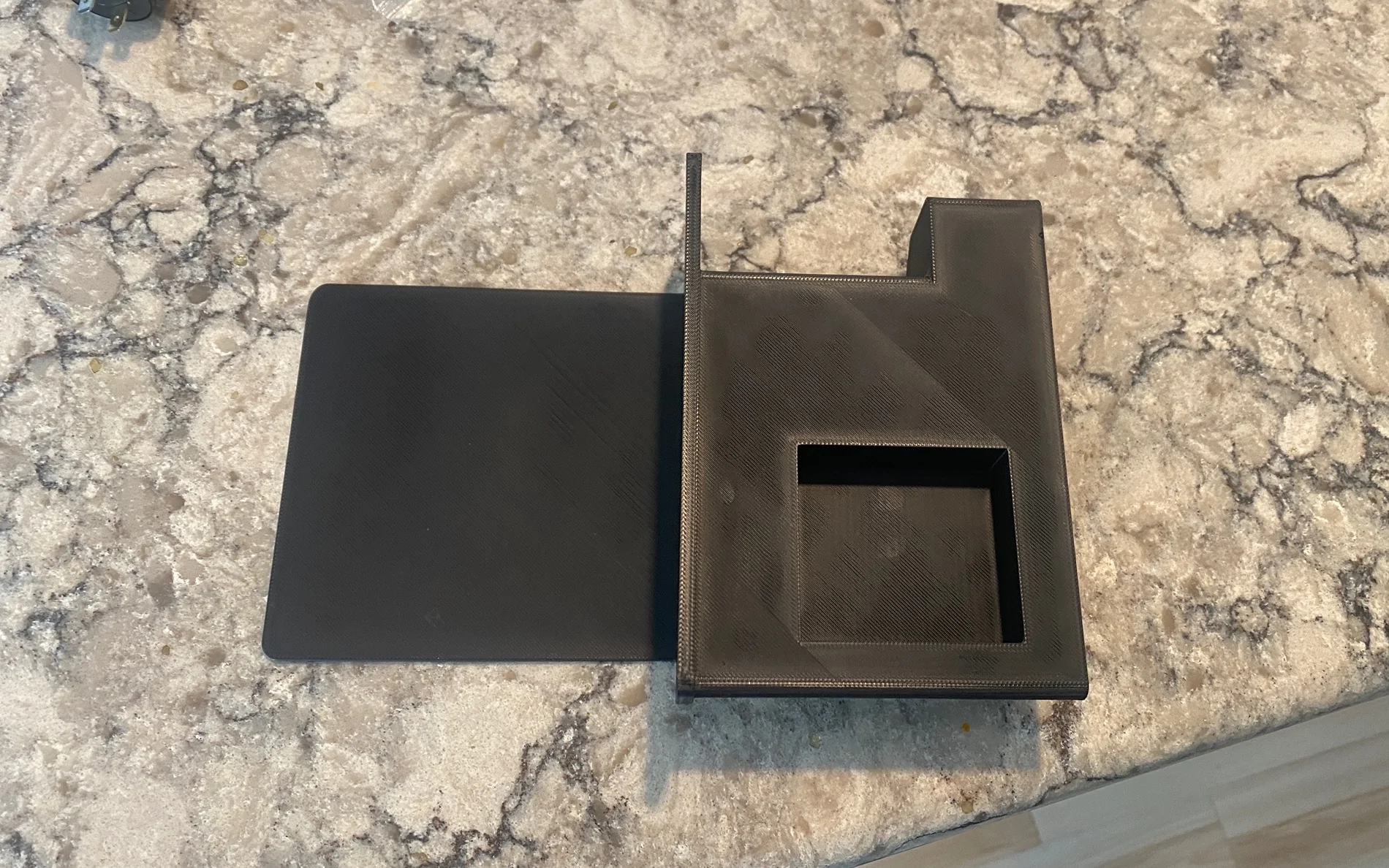

I knocked this out for the 25 Lariat's wireless charging pad. It goes all the way forward and now when I put my iPhone 16 on the pad (all the way against the spacer) it is properly centered. Before this I had to sometimes fiddle with the phone placement on the pad to make sure it's getting the juice.

I can send one to you just for shipping but really just cut up a piece of foam, cardboard or something and stick it in there and you should be okay.
1. Put your phone (with case) on the pad pushing it all the way forward.
2. Measure the gap between the bottom of your phone and the front edge of the pad (ex 80mm)
3.. Cut up a spacer that's 1/2 the depth of the measured gap (ex: 80/2 = 40mm)
4. Put the spacer all the way forward on your pad
.. and now when you put your phone in, it will be centered front-to-back!

Thanks! will posted update after completed

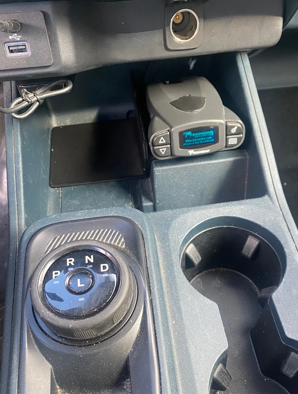

I use the area in another way.
The beauty of 3D printing is you can make one. Cheap. For pennies.
Without having to buy 100,000 minimum order to get the price down.
My custom trailer brake controller holder.
