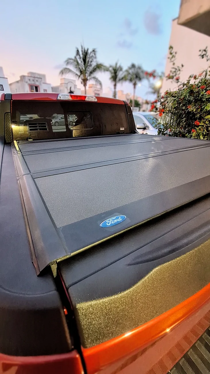

Can't help with your specific setup, but my OEM Ford hard roll-up isn't listed as compatible either yet it works fine.
Just check how your tonneau locks or clips in place, and imagine the width across the bed is 1/4" less. Would it still work?

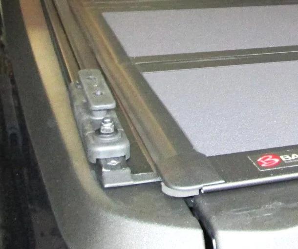

HTH
^^^^^^ This is the key. The TS rails will narrow the opening slightly, so look at your RC cover and see if there's some room to work with. This is mine w/a BakFlip MX4 tri-fold.
HRG

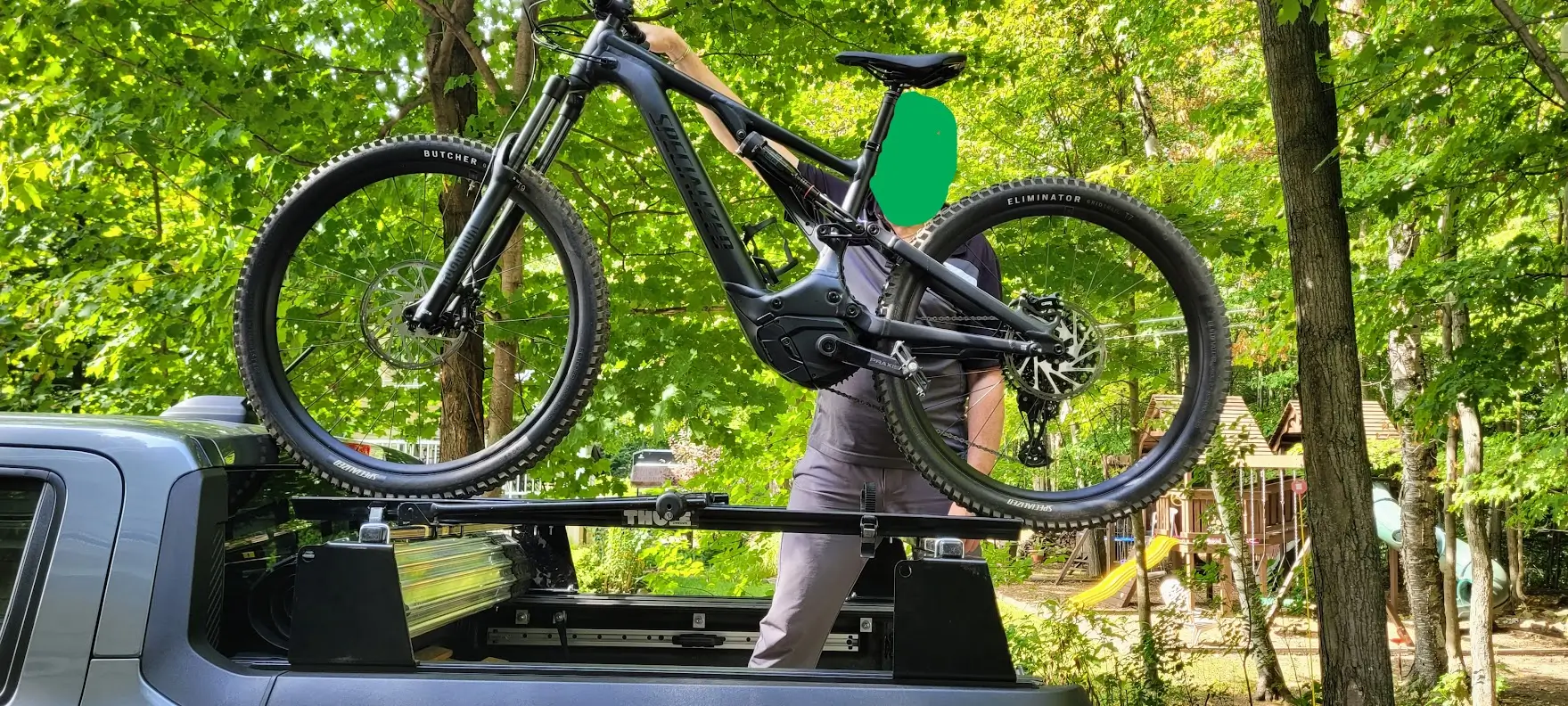

That's what I'm doing with mine - I'm adapting old Thule roof-top racks & cross bars to work with custom-made risers. I designed them to be *just* tall enough to clear my rolled-up tonneau cover, so I'll have full bed access even with the bikes on the rack. This was a test to see if everything fits, I need to move the racks backwards but everything seems to be OK so far :
Looking solid nice project
