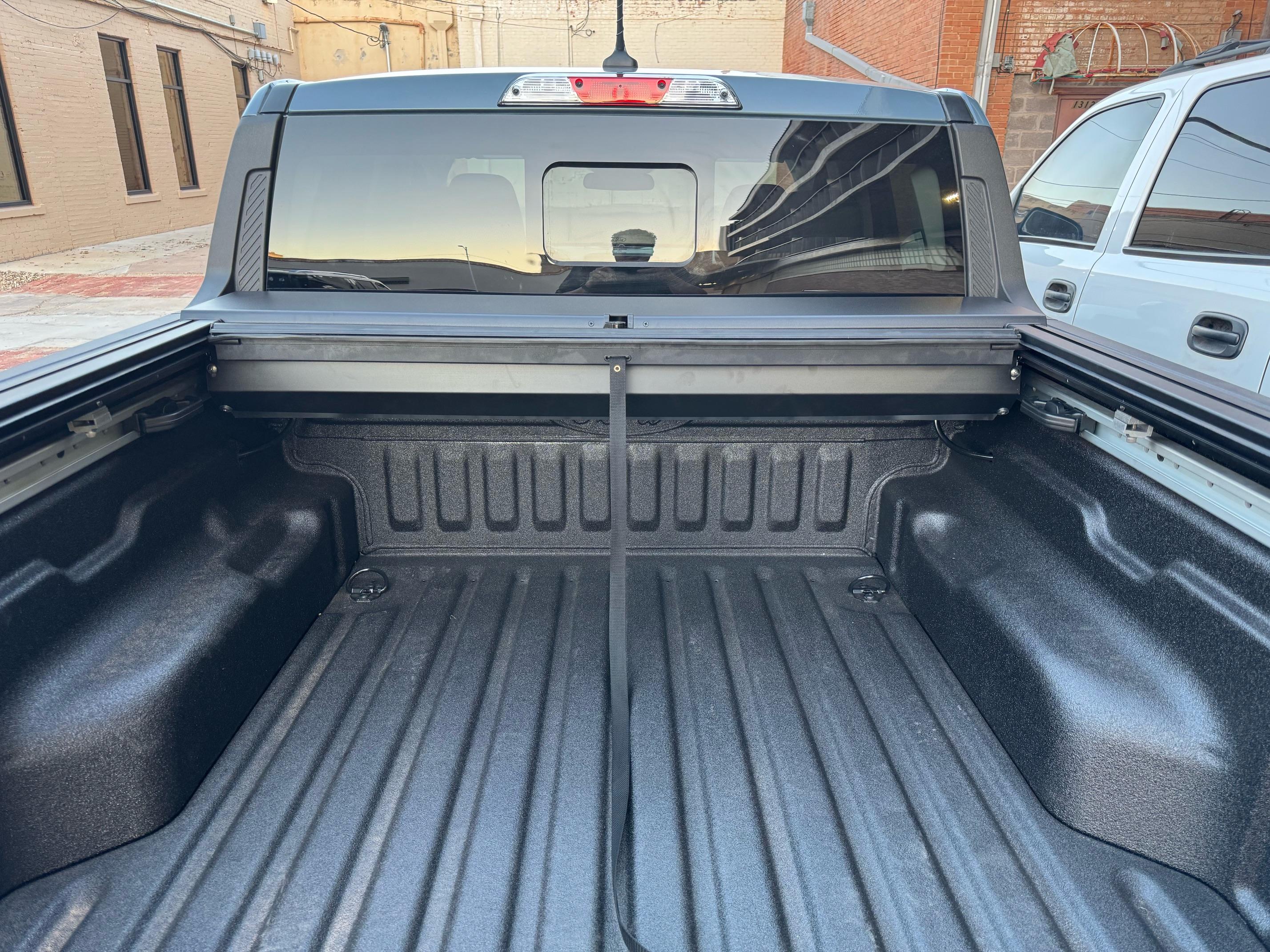

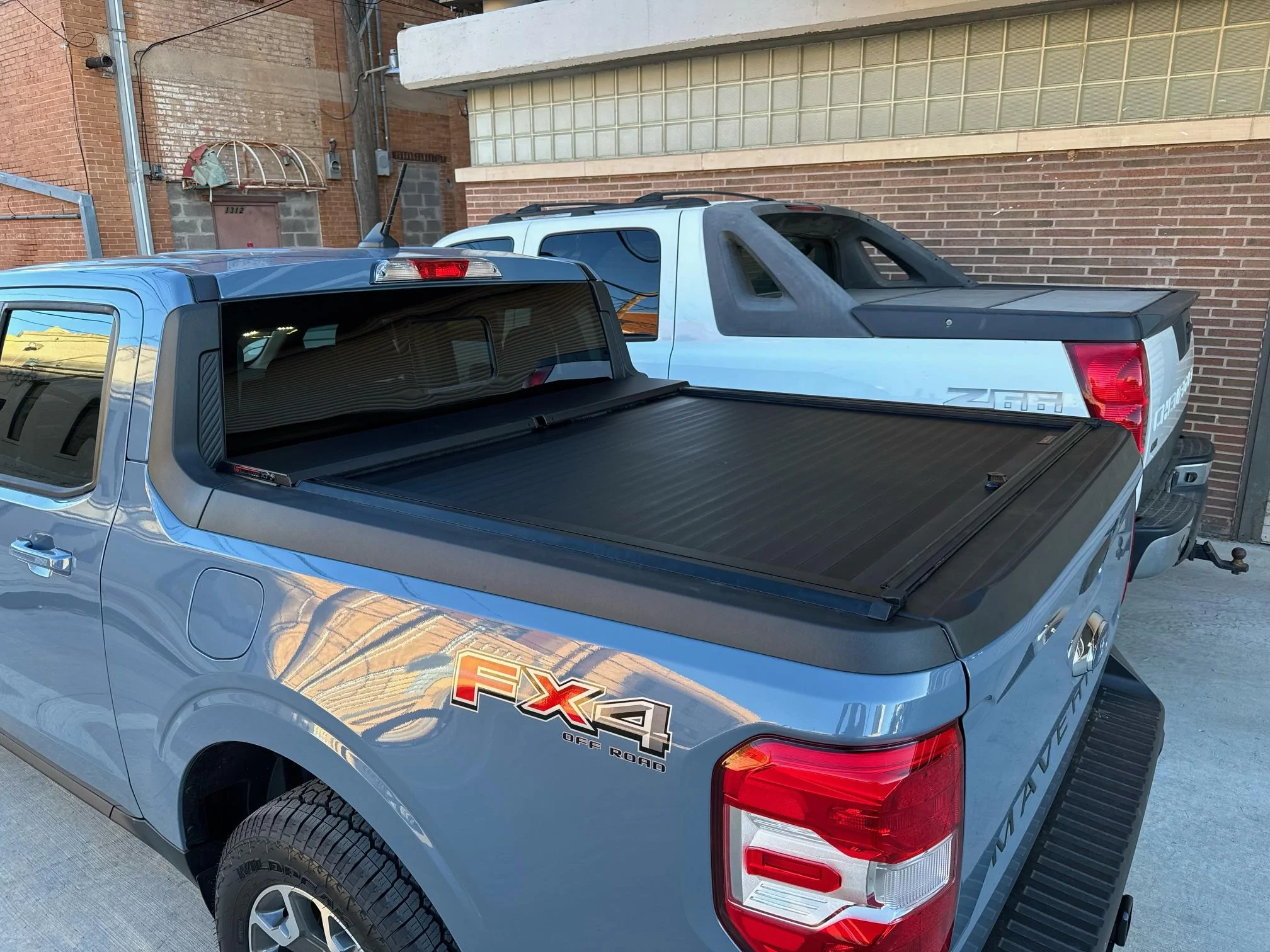

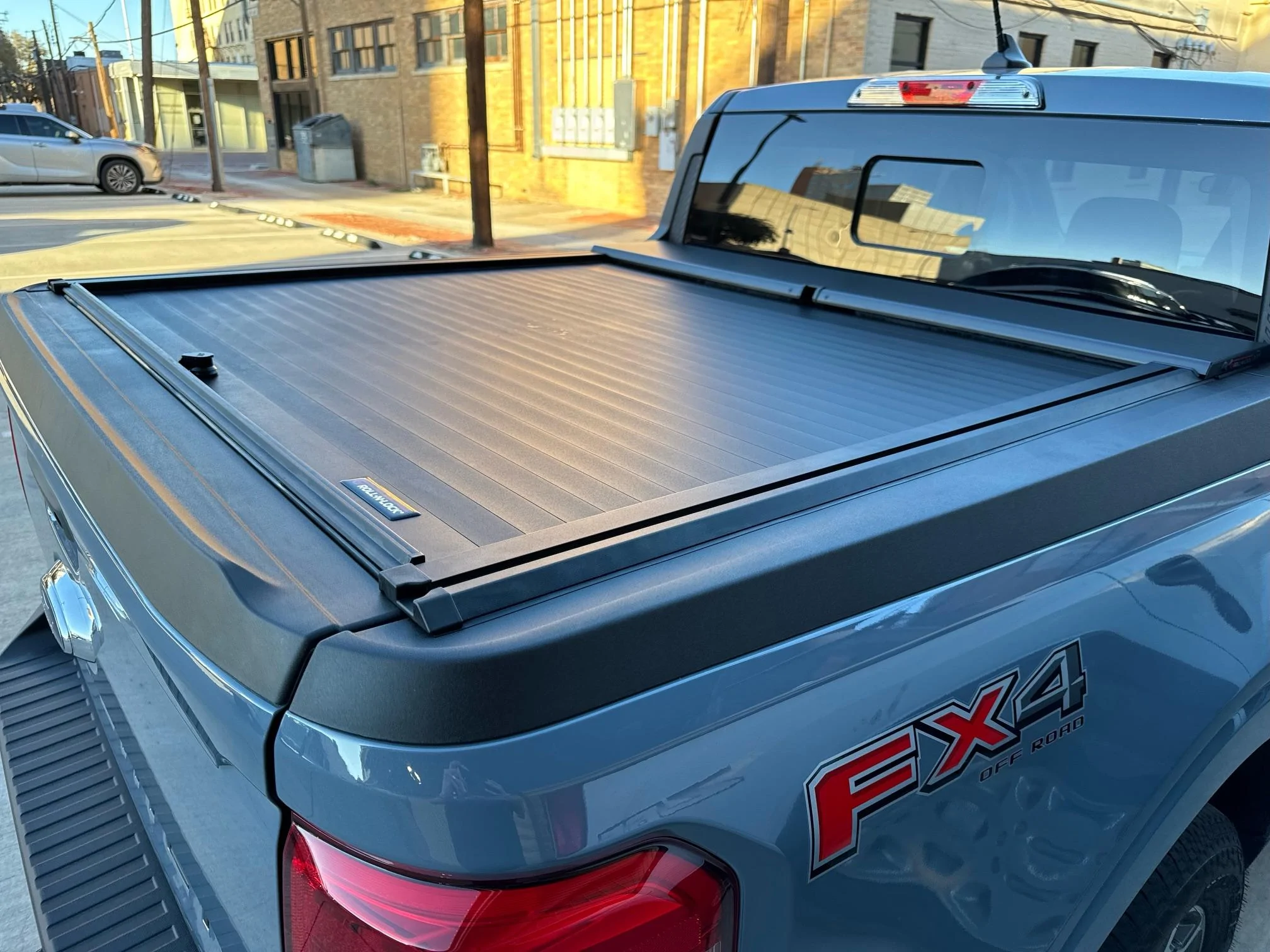

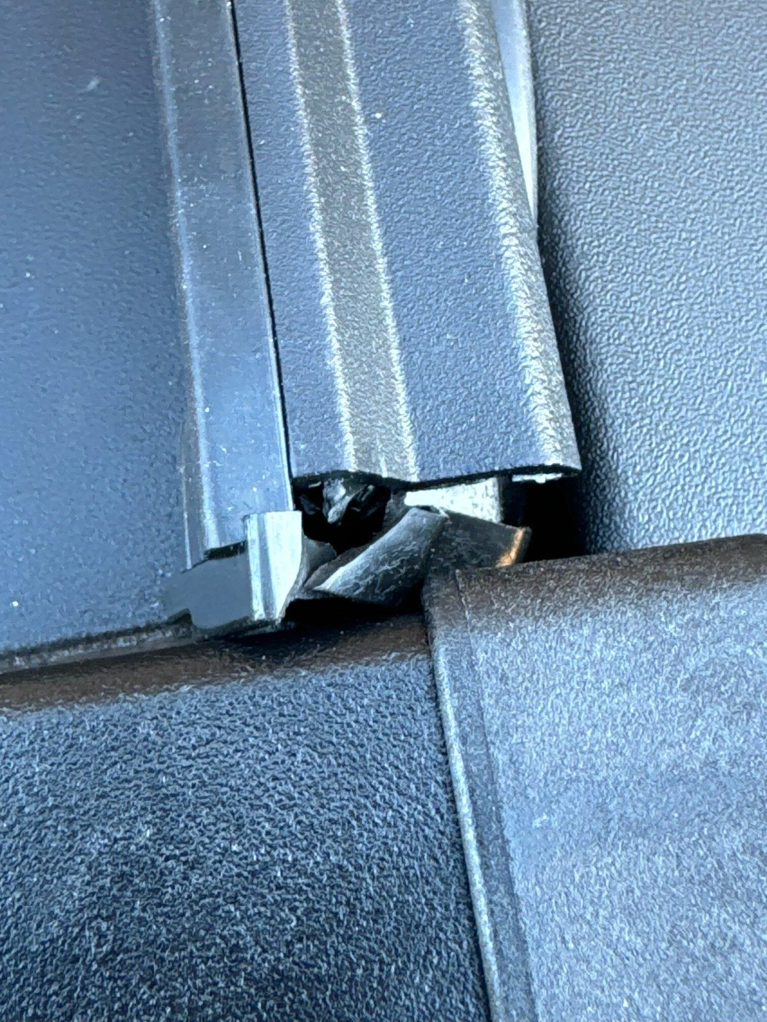

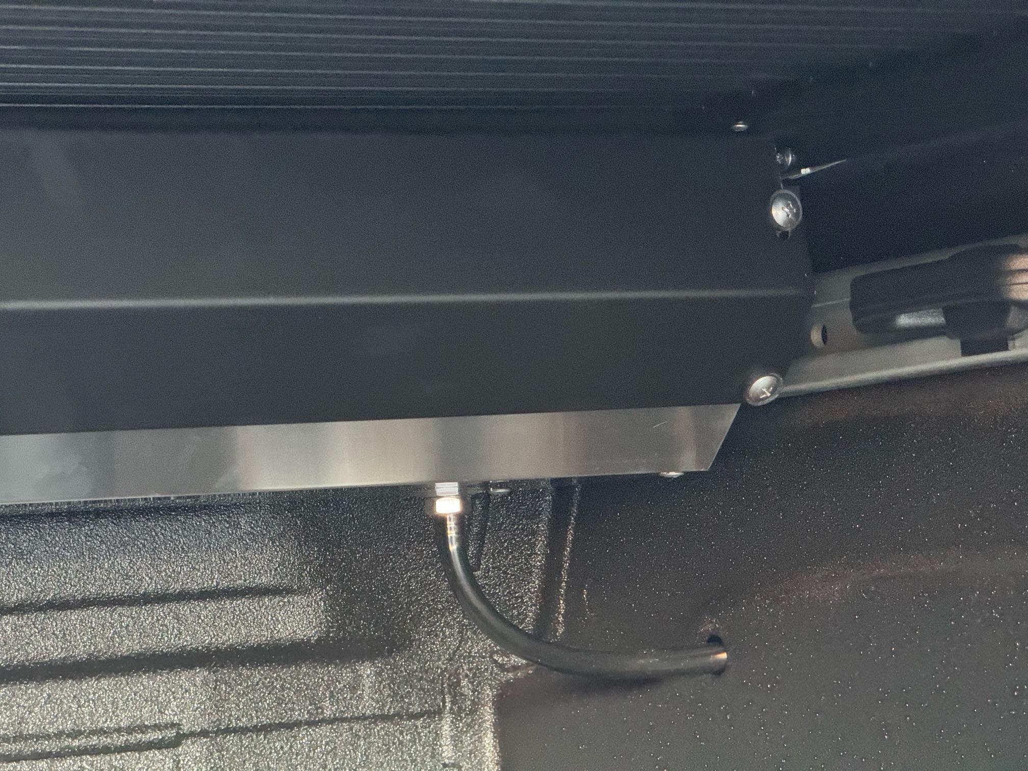

Well I decided to go with letting the "Professionals" install it. I just picked it up and so far i am not impressed with the install. I think i will love the cover If & when the install issues are resolved.
1) The cover will not open all the way. - The black metal canister guard was installed upside down causing the bottom of the cover to scrape on it and preventing it retracting all the way.
2) The Latch does not reset when the cover is opened - It never gets into the canister, so doesn't rotate the way it is supposed to reset it position. (see #1)
3) The cover will not latch with the tailgate closed - it was mounted too close to the tailgate so will not latch - it will latch with the tailgate open but then you have to pretty well slam the tailgate to get it to close.
4) They broke a part on the Cover - Likely because of either #1 or #3
They are ordering a replacement for the part they broke. I am taking it back in the morning to have them correct the upside down guard. They assure me once the new part comes in they will adjust it and then it will close correctly - We will see.
It does look good, though it's buckling just slightly because of #3

Sorry about the install. I think it is difficult for this kind of cover but I don’t think there is a better looking cover ( and functional) out there. Good luck with the fix
