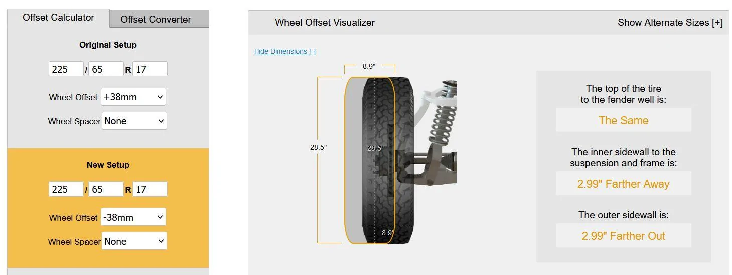

I have a stock set of rims and tires on my 23 maverick. I put fender flares on and need to know the offset needed to reach the egde of said flares. They are about 2.5”-3” past the factory edge of the vehicle. Please please please advise.

Not enough info ... who makes your flares? Model?
Since the bushwackers are the biggest I know of .....
Search "Bushwacker":
https://www.mavericktruckclub.com/forum/threads/bushwacker-fender-flare-info-pics.27927/#post-519978
See example:

WOW! Thank you sooo much! I’ve been racking my brain and for some reason no one could tell me! I have as of now, open air full cold ar K&N air filter, Magnaflo cat back exhaust and just the flares. When my warranty runs out I want to tune it and upgrade everything I can! Again thank you and this club rocks!!
