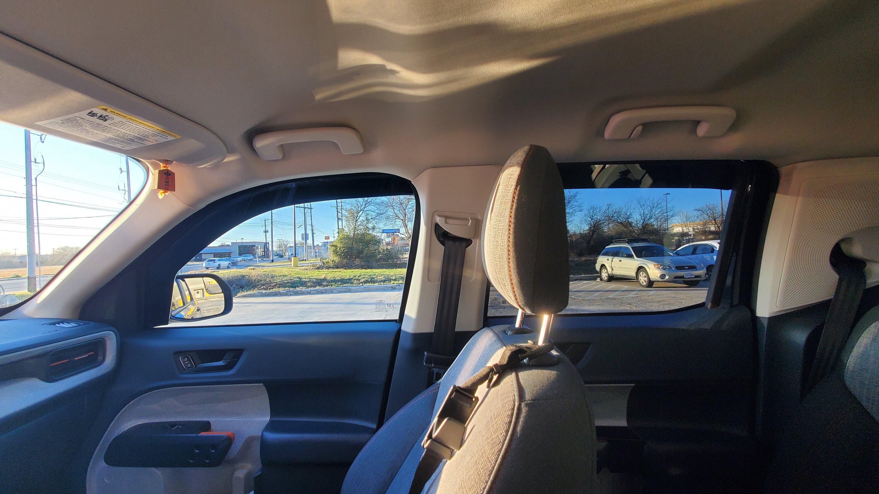

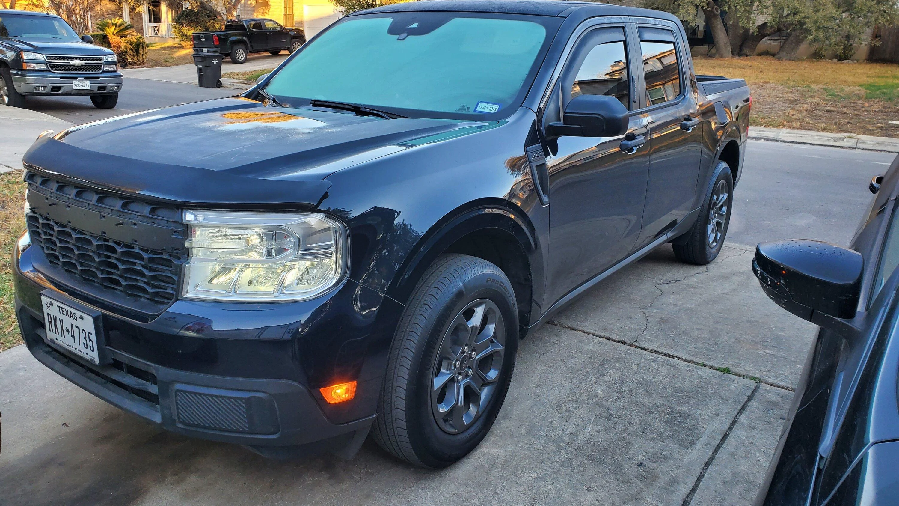

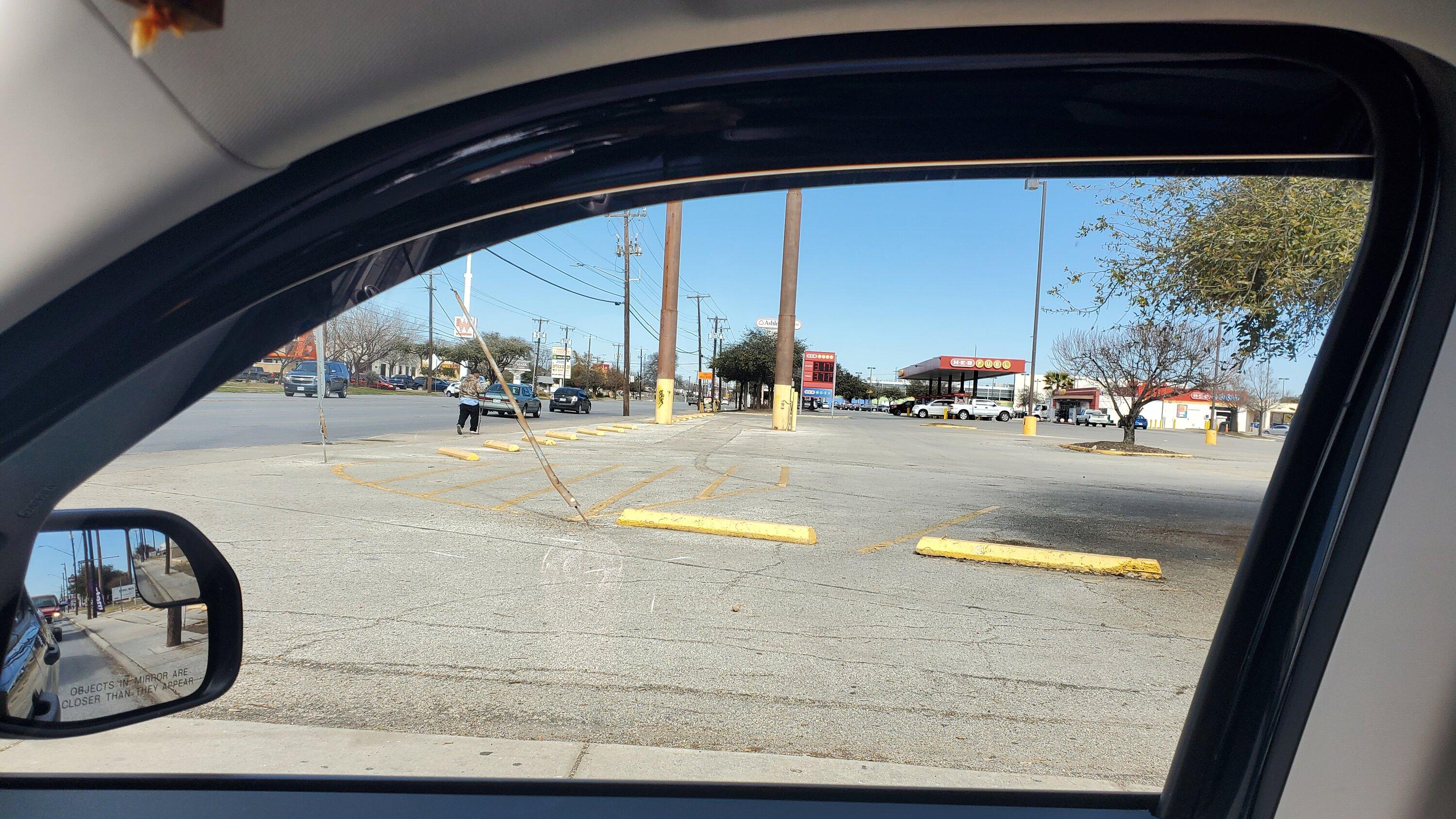

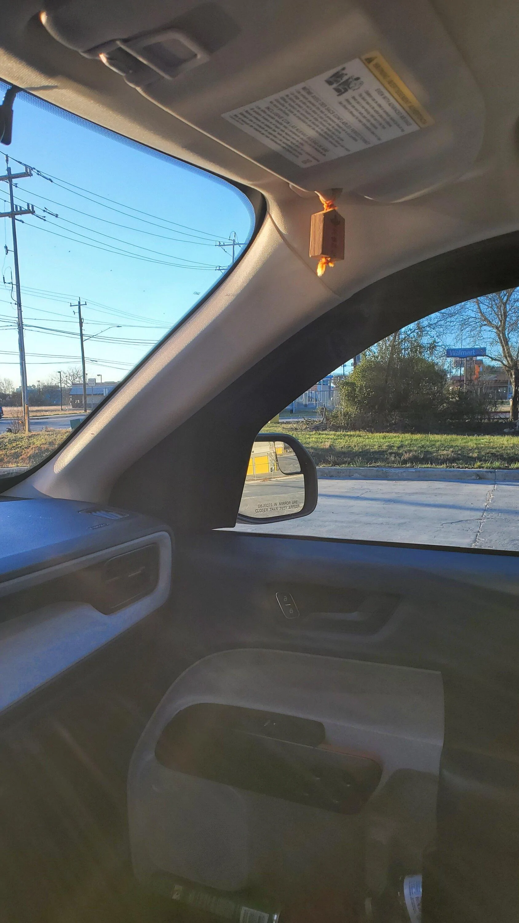

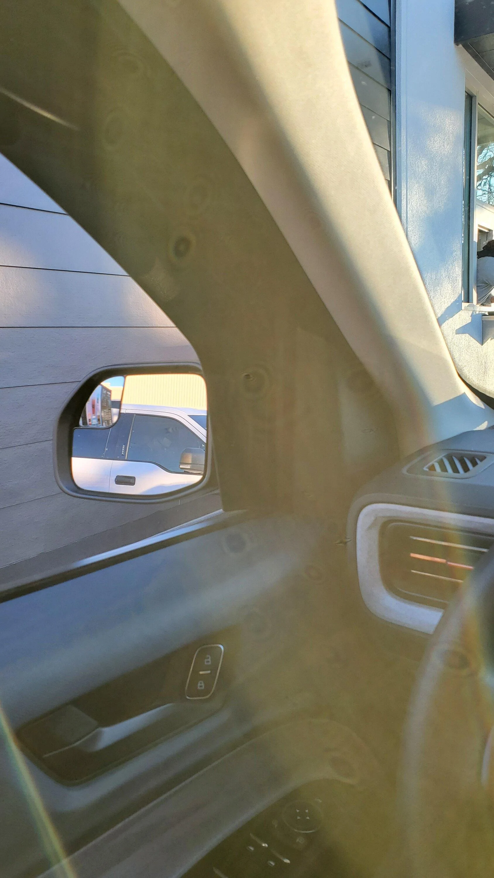

Mine came in Monday, got them installed yesterday. They're definitely going to keep water out, here's some pics of how they look. I don't like the view of the passenger mirror through the window, nor that the visor doesn't follow the curve of the window itself. Not a huge deal, I'll probably trim them down. They definitely increase the effective width of your A Pillar, limiting visibility just a bit.
Next concern, biggest: the thickness of these visors makes your window motors work VERY hard to fully close, you can hear the motor strain and release, takes multiple pulls for the last inch of closure. While fitting, the window refused to roll down, stuck with the visor. Pull visor away from vehicle and click, click, click, the window trigger until the window squeals itself out of the channel it was wedged into. I'll likely sand the width of the in-channel portion at various stretches, hopefully it'll keep tight when windows are down without binding the motors when rolling the windows when up.

I had a similar issue with the window being tight.
The window was coming back down or not coming down at all and I was getting DDM errors in Forscan.
Try a silicone spray in the channel before sanding. Fixed the issue for me.
