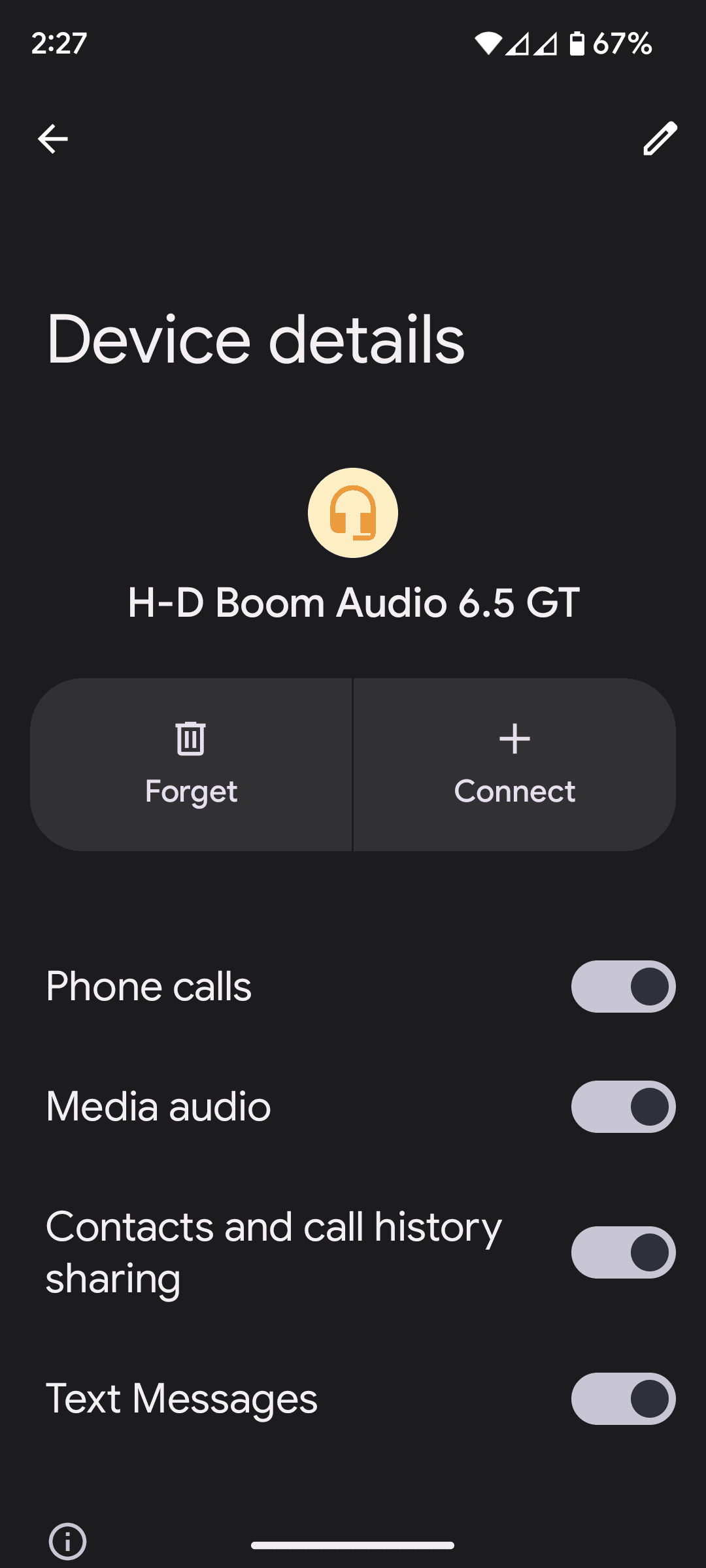

Ballard_st, if Ozarkbeard's idea doesn't work, and if you use an Android phone, have you double checked you phones bluetooth settings for that particular device?
I have had my phone connect to a vehicle, work for phone calls but not media because media became untoggled.
Setting>Connected Devices> then next to Maverick, under devices, hit the gear looking thing and make sure media audio is toggled on. I don't have my Maverick yet, but on my other vehicles I have had media deactivated without me knowing how it happened.
It would be odd for multiple phones to have that setting change without you knowing, but still worth a look.
Ford Maverick Radio won't accept Bluetooth devices even though they're attached Screenshot_20231118-142729
I tried one of each (Android and iPhone), and they both always worked until today suddenly so I doubt that's it. I'll check anyway though, thanks.
☝ This.
Check your Permissions in the phone's settings and make sure the ones you want the phone to share with the truck are enabled> Phone calls, Contacts, Media, etc.
