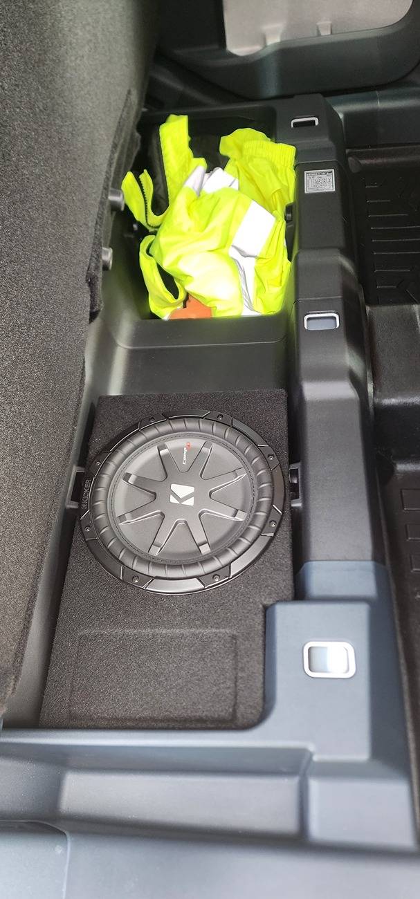

If you're good at fabricating you can definitely fit a 8" or 10" shallow mount in a custom-built box behind the rear seat. I seriously thought about it I just didn't want to spend the time removing the OEM jack mount as well as all the time the fabricate it.

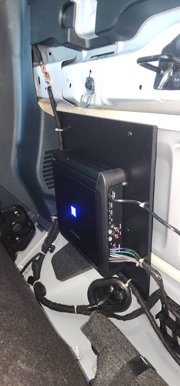

So I went the lazy route and bought a ground shaker box for a 10" sub on the passenger side under the rear seat. I mounted the amp in the stock amp location where the b&o would be.

Amps are easy to mount behind the seats, I made myself a nice aluminum panel that mounts at the car seat anchors and B+O amp mounting spots.
