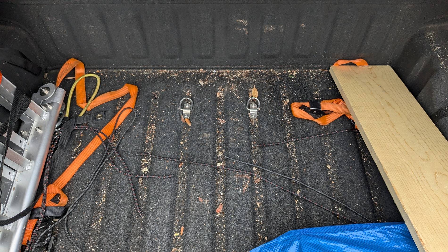

You have about 1-1.5" past the bottom rib of the bed before the gas tank. So you can drill and use a rivet nut, but I would advise using a drill stop or step drill. If also recommend measuring your screw to ensure that it doesn't pierce the tank.
*Drilled and riveted for two tie down anchors for motorcycles.
